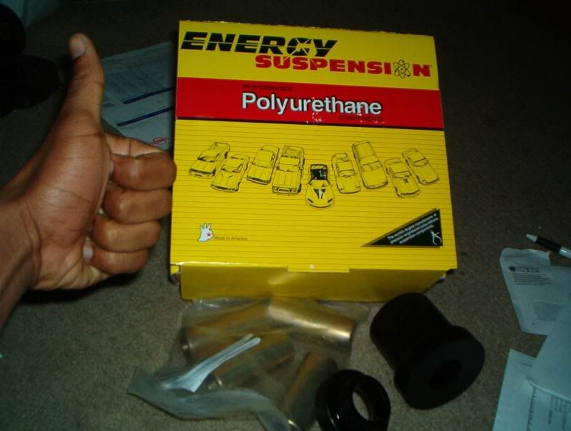

Parts:
(1) Energy Suspension Polyurethane Subframe Bushing Kit for 90-96 300zx z32
Part Number: 7.4102 ES
(2) Four [4] M12 X 1.25 metric nuts
Cost: $65-$100

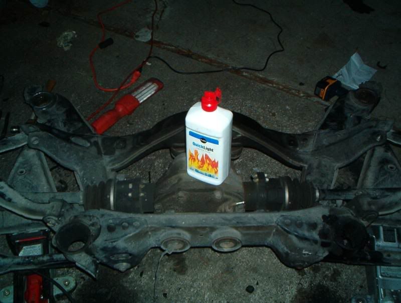

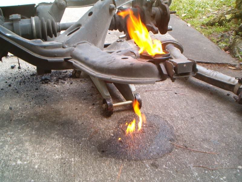

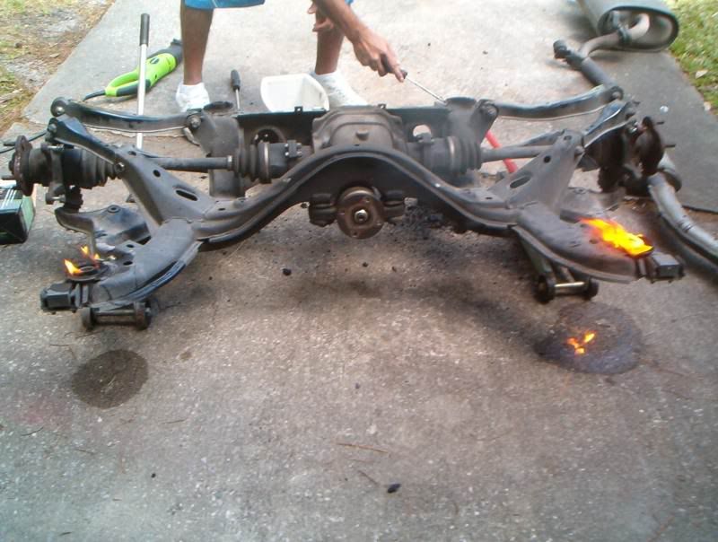

10- So you got the PITA out eh? Gets worse. But before that we get a little pyro fun. Time to blaze this bitch up. Basically, follow the directions on the blow torch and use it to burn out the rubber. Most likely it will ignite:

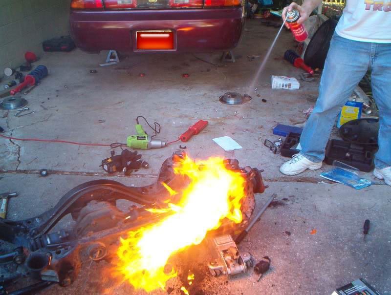

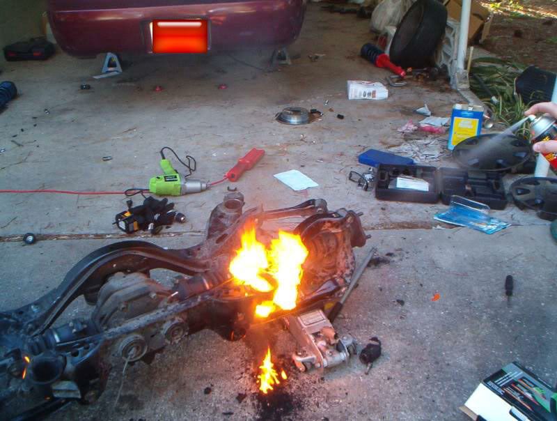

We thought it wasn’t burning well enough so we utilized our barbequing skills and used some god old lighter fluid:
The Subframe! The Subframe! The subframe’s on FIRE!!
We don’t need no water let that mofo BURN!
DON’T DO THIS….LOL.
11- Ok so there’s only so much you can burn out. Once you have burned out most of the front and rears, the part that sucks starts. You’re going to have to remove ALL the rubber in each hole. Begin with the fronts (as in front of the car). There is, unfortunately a metal ring (actually there’s two) that you need to remove. Using a cutting tool like a sawzall, you need to make a cut through both rings, but do NOT cut through to the actual subframe. Look at my cut depth:
