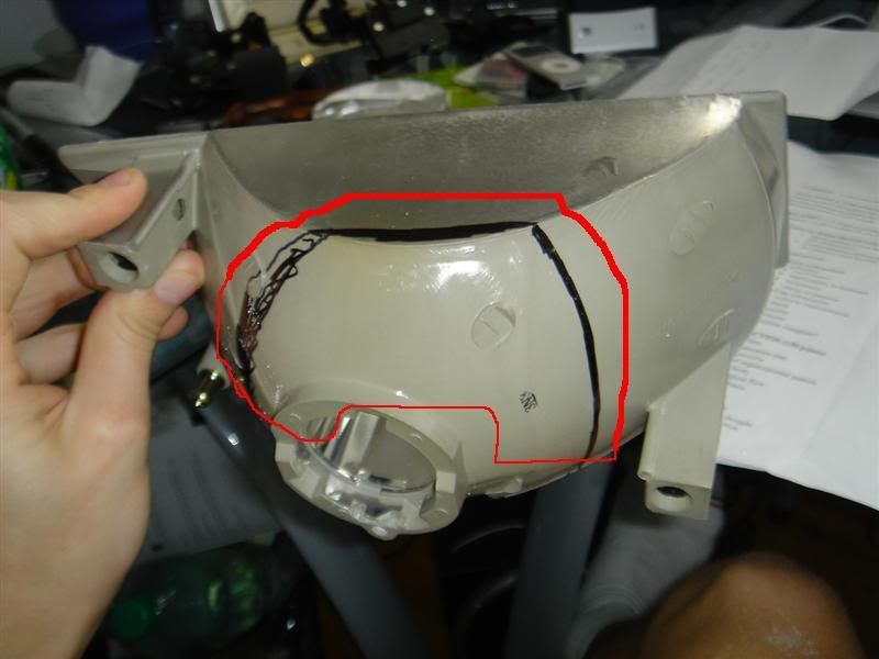

now i tried 2 methods for removing the plastic cover
Oven (350F for 5-8min) flip the lights around half way so each side is pretty warm
AND
Heatgun, either one is fine but if you dont have a feel for the heat gun you can melt some plastic (this was my first time taking off the cover and i did fine)
pry open a side of the ligh, if it doesnt want to budge you need to heat it up a little more so the glue will get soft

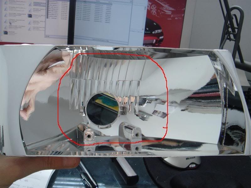

now because this was my first time ever doing a retro fit i cut small to see how it would fit and gradually made the hole bigger for a better fit.
Red outline is about an estimate of the hole i carved out to make the 3" projectors fit nice and neat.

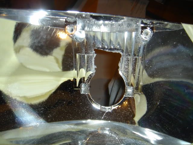

I made custom brackets to hold these projectors in the shroud, one on the top and 2 on the bottom so it will hold it in nice.
Also you will need to make the hole a little bigger in the back of the headlight so incase you need to adjust the beam it has room to play with
about an estimate

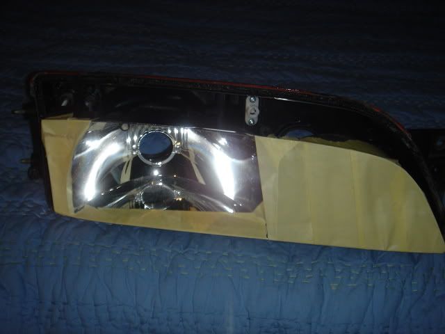

cut a little square right above the opening
the projector fits nice and tight, cut out little pieces so the projector can squeeze through the housing(marked in black)
i forgot to take pic of the last step but its easy, make a little bracket out of metal, screw it in the housing and the projector(bottom holes of the housing and projector)
