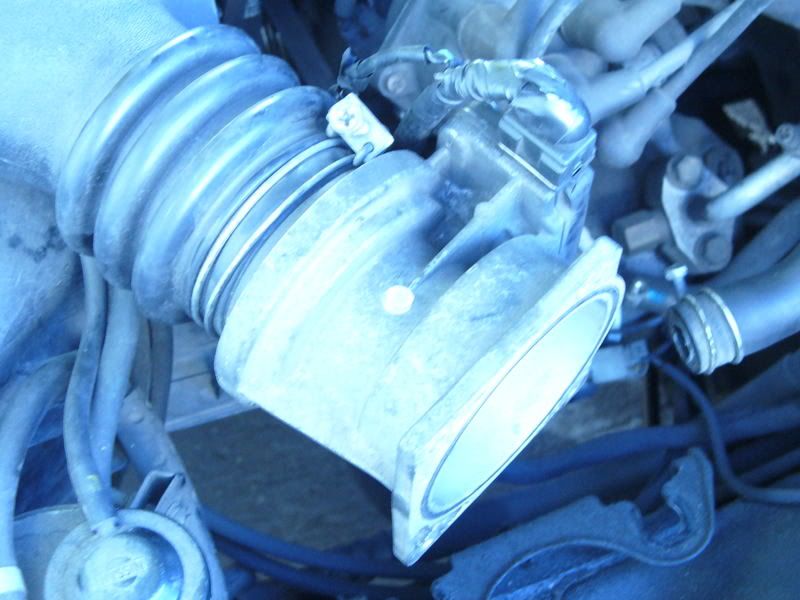

next what u need to do is remove ur stock air intake box once u have it off there are two ways of doing it u can buy the MAF adaptor off from ebay there like $10 on there or u can mod ur stock air intake box to fit thats what i did
once u have it off look at the side where u see the bolts there are two metal tabs that hold it on i already took it off in the pic
the easyest way to do it is to just drill them out it just pops right out
after that u need to get some pliers or somthing to bend the metal stight
now the filter will just go right on
after that just bolt the whole thing to ur MAF :mrgreen:
and there u go more HP at a cheep low cost well for me $5 hahahaha:thumbsup
