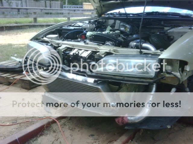

Diggin the Amber corners and 2/3 Amber Turns...
Thank you. I was going for a kinda jdm s13 look with the front turns came out alright. I wish I could have kept my fogs though thinking of turning the intercooler upside down but then I would have to loose me reinforcment, so I'll prob just leave it.

Yours is taller and thicker, but definitely doesn't need to be that big...
Set-up shown:
Custom 2.5" Intercooler piping
FMIC 28x7x2.5
IAP has a kit for there KA-T: 27x7x2.5" that can support upto 550whp, much more then needed right now...

I have a habit of going to big with intercoolers lol you should have seen the one on my s13 24x12x3 way oversized. When ever I get some more moneys I'll look into one a little smaller, and sell the one I got now. I plan on going gt30r turbo wise to the rb25 turbo only satisfied my need for more boost for a little bit.
