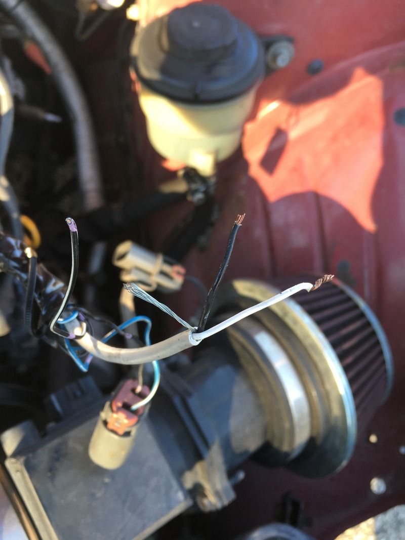

This is how the car would run at idle and after taking off the MAF sensor and it's hacked up wiring.

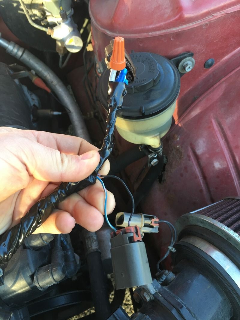

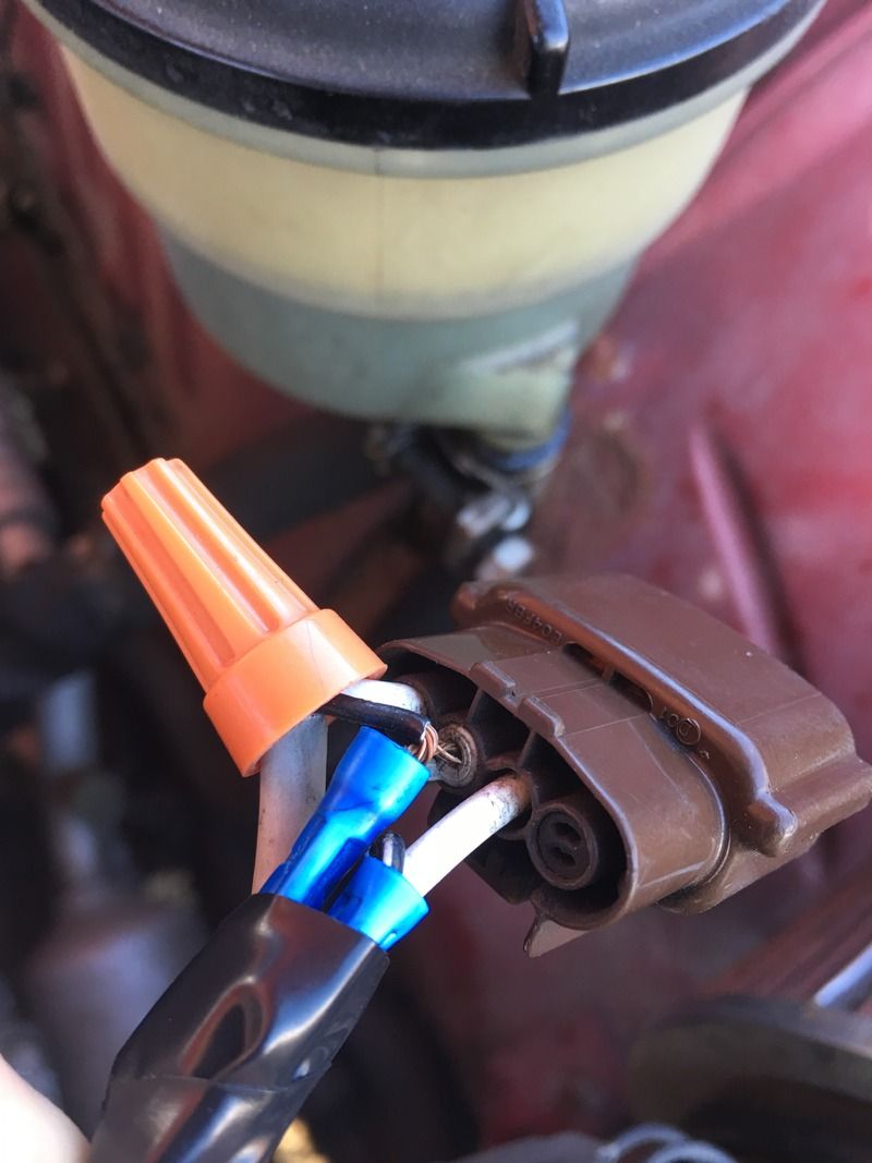

And here's a close up of the wiring the previous owner had done to attempt to fix the wiring harness that was "dry rotting"
For the time being, I went ahead and tried to wire the MAF as best as I could and got it to stay in place with electrical tape.
Fast forward. So I replaced the gasket! Tried to tighten the nut on the EGR, but it wouldn't move. For the time being I said F-it, but! She idles a lot better now! This is last Sunday. I also thought that something was wrong with my MAF and unplugging the sensor would make the car run a lot better, but would kick it into limp mode and wouldn't let me rev it passed 2,500 RPM. With this going on, I figured it was probably wired correctly, because even though it idled really rough, when it was plugged in it wouldn't be in limp mode. So I drove it around the block a few times and it felt fine, so I decided I was going to attempt to make it to work with it on Monday.

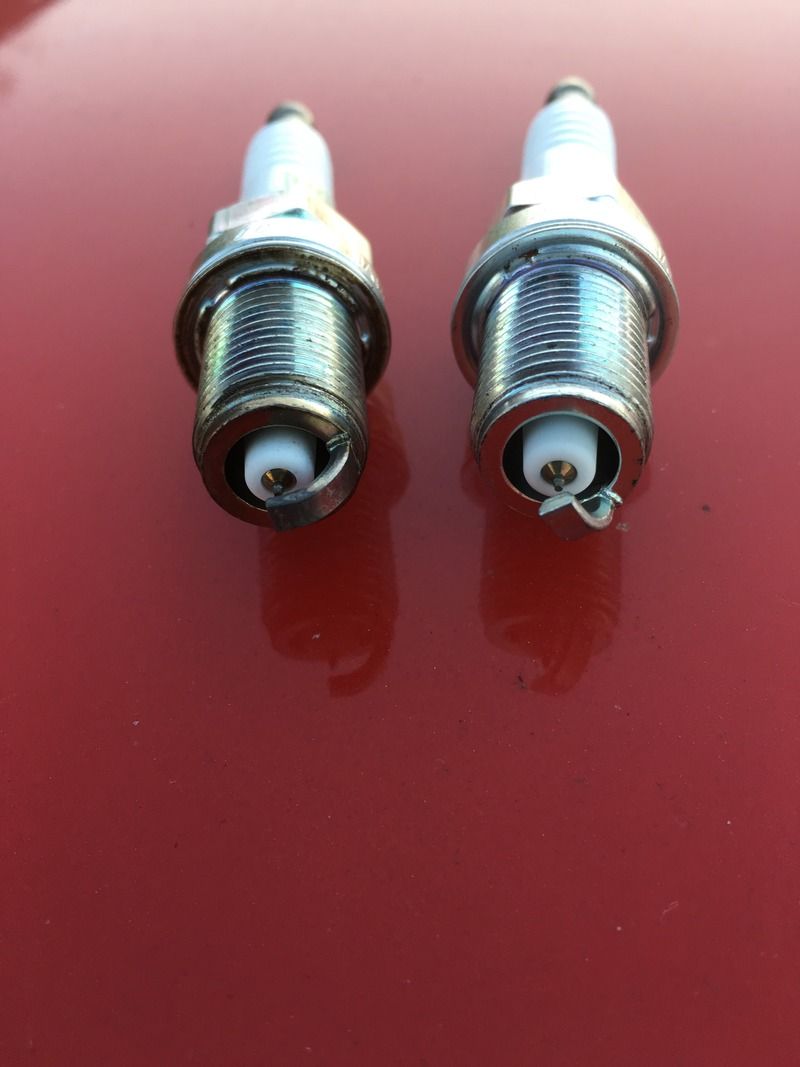

Hmm....one of these things is not like the other. Then I check the distributor cap and the rotor button. Didn't get any pics of the cap, but here's the button. A little worn, but still good. Some sand paper did her up just right.
So I go to the parts store and pick up some new spark plugs. We get them in and start the car. Sounds and runs the same. Well that didn't fix it, I thought. So my dad is listening to it and has me shut the car off and he pulls the wire for cylinder 4. I start it again, nothing changes. It runs exactly the same. So cylinder 4 isn't firing. We grab a different plug out of the garage, put it in my wire, ground it, and when I start the car it's getting spark. Must be fuel. I pull the plug from cylinder 3 and cylinder 4 to inspect them and smell for fuel. This is what I see.
