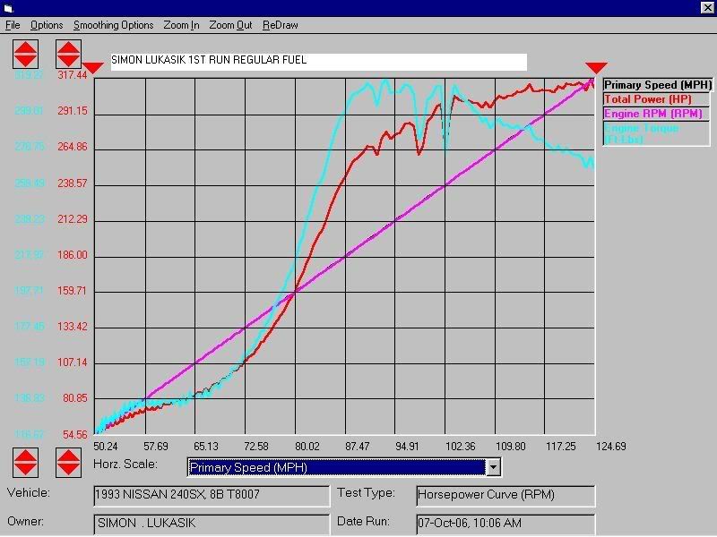

Dynoed my car the other day for the first time ever. Did 4 pulls, 2 on pump gas, and 2 on race gas. It was a mustang dyno, the guy didnt hook up rpm's, just went off roll speed.I wish he would have hooked up rpm, because i think it would make it easier to read. I was having some back firing at higher boost. Could that be because of a boost of vacuum leak? Here are 3 graphs of my runs. Do these numbers sound about right for my mods? I am also at 4500 feet elevation. Also He was doing pulls in 5th Gear... I was thinking 3rd or 4th gear would be better...
RUN 1 Pump Gas 18psi. 317whp 319wtq
RUN 3 110 octane 23psi. 339whp 332wtq
RUN 4 110 octane 20psi. 322whp 312wtq

Whats your AFR reading through out the RPMs? I used to get popping at high rpm when i was running too high of fuel pressure and found my AFR was down at 9.5 Those are some pretty nice numbers on a Mustang Dyno. Some cams and intake manifold will help out alot. Im anxious to get my setup dynoed after i put on a new intake manifold.
Looks pretty nice.
Although I dont think he was in 5th gear. 5th runs to about 160ish @ 7000rpm and the dyno says it only ran to 125mph...
Anyway I would be kinda mad also if they didnt hook up the rpm. You kinda need that to tune it. Wideband is also good, but that often costs extra.
On the first dyno, it looks like it was detonating on the top end. The huge dips could also be detonation. The second graph looks like a lot of detonation, maybe the race gas was not mixed in the tank yet? The last dyno looks smooth, I am willing to be that there was no detonation.
its a mustang dyno and your at a moderatly high elevation id say your getting around 365hp or more and with a better tune you should see improvement without adding anything on your setup because what u have right now is efficent for around 380 might need new clutch tho i suggest rps max series also watch your injectors
At every dyno ive been to they use an exhaust pipe wideband O2 meter. Not as accurate as a dump pipe meter but better than nothing
You better not have a wideband in the dump pipe unless you plan on replacing the sensor every month, it needs to be at least 30 inchs from the exhaust outlets....
you should be able to hit 340-360ish with just the smaller a/r housing...
so 400= + shouldn't be a problem...
and mustang dyno's blow ass!!!!!!!!!!!!!

Which 2871 do you have? There are 3 different versions. One is rated at 400hp, one at 460 and one at 475. Do you know the model # on your turbo?

..you should be able to hit 340-360ish with just the smaller a/r housing...
It will spool faster with the smaller A/R exhaust housing, but will make less power. With cams, the power will pick up dramatically.
The ones that work properly are absolutely awesome. Mustang dynos more accurately show the power of the engine than do the Dyno Jets, since Mustang dynos actually load the car, Dyno Jets just spins a drum.

Anyway, looks like up top youre breaking up becasue of too much fuel or too much timing. Too much fuel could be because of a boost leak or just becasue of too much fuel. Get a wideband and something to tune with and your numbers will jump a nice amount.
