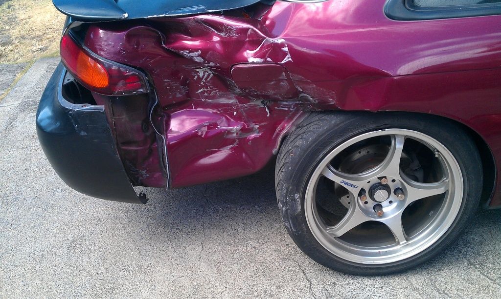

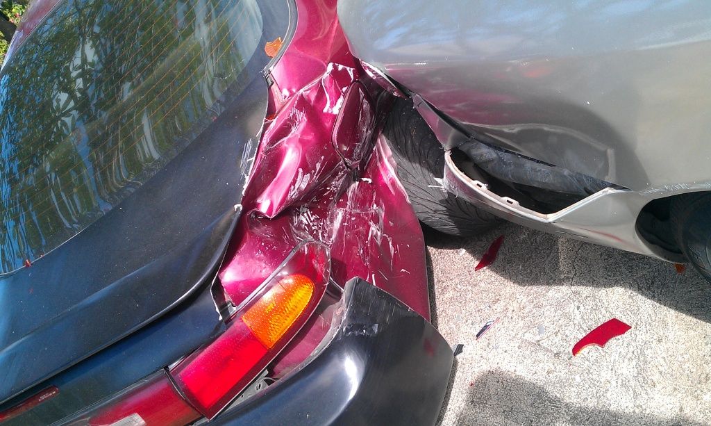

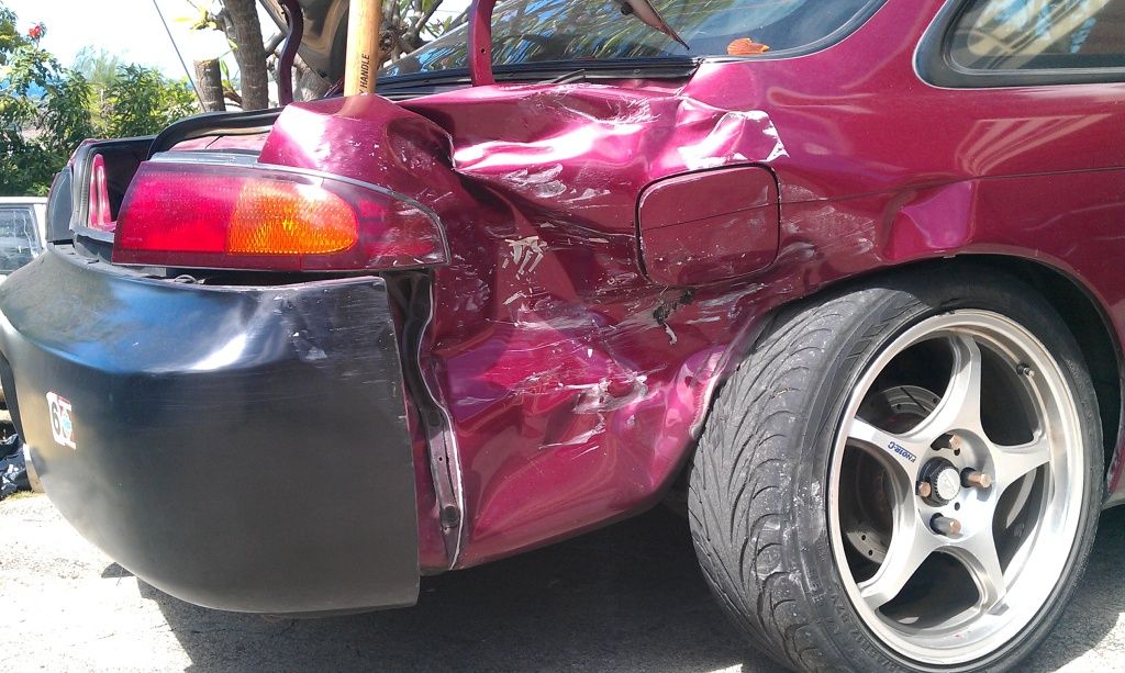

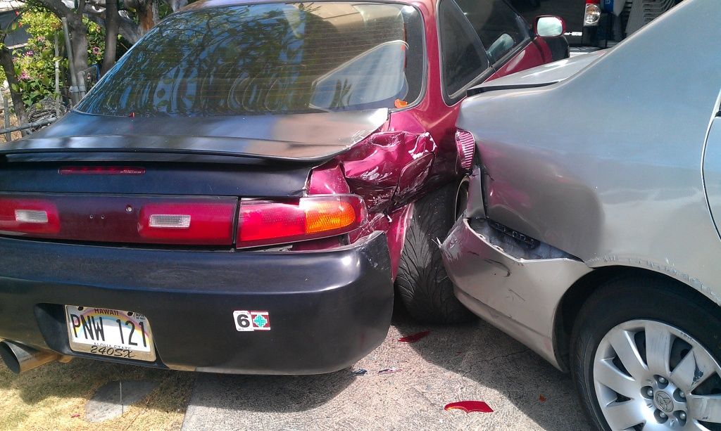

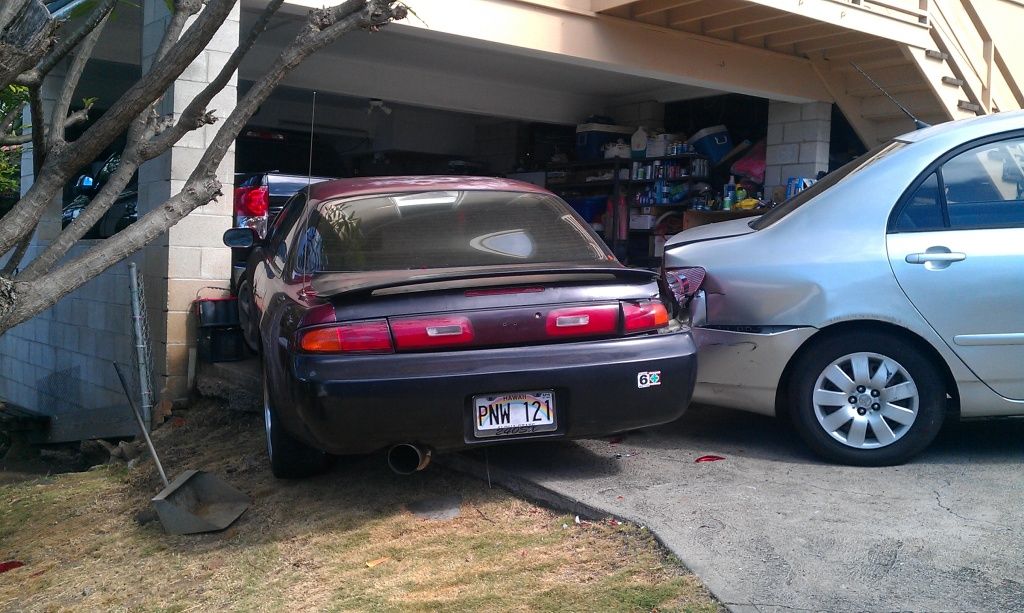

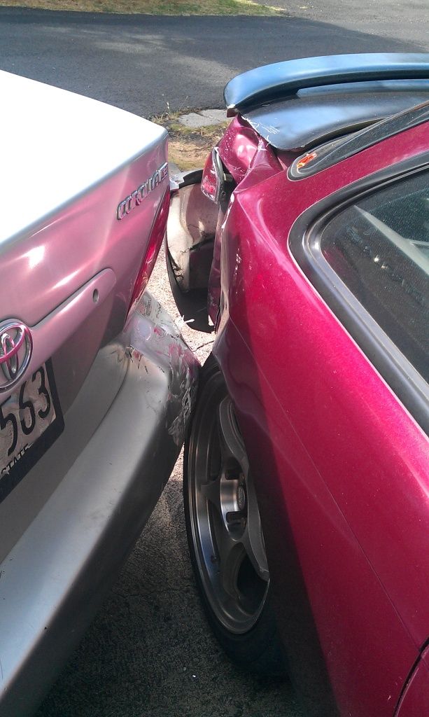

So it looks like she will go into the shop before Summer (Sometime in August)
She will be Fully Repaired and Painted
- Same Color
- Trunk will be done in Matte Black (Of course ;))
- Front & Rear Windshield Trims will be replaced
Right after she comes out she's going up on stands to swap the sub-frames out (Some of you will want to kill me for even driving it the way the Sub-frame is but I have no choice)
- in doing so I will replace the CV boot's because 1 is ripped and it doesn't look like there's any more lube left in there :(
