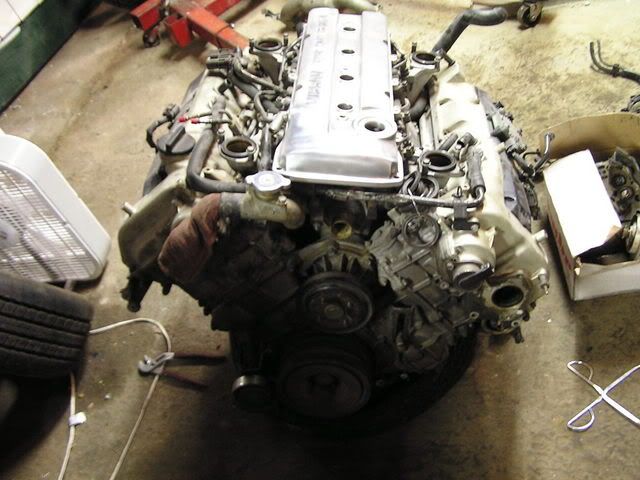

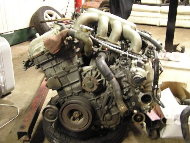

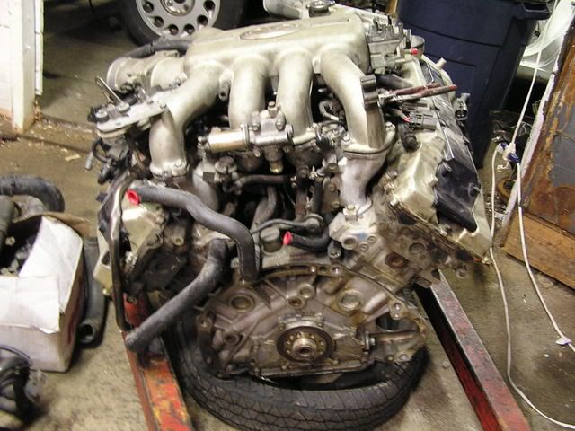

Haha, this thing is HUGE!
Front Veiw
Back Veiw
For alittle size comparison, Even though you dont get the full impression until you're standing next to the motor and staring at the empty engine bay in 3ft away and shaking your head.
Took half the intake manifold off and created the super rare W12 KA69DE!

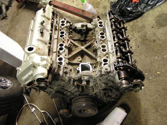

Tyler and casey spent alittle time at the garage uncluttering the motorset and getting ready to put it on the stand(as soon as we get the huge bolts that will fit the block tomorow). These pictures do more justice to how wide a 90degree 4.5L V8 is.
"I like big V's and I cannot lie"....
Something for you to reference off of, the valve cover easily fits between the 16 intake ports.
we're going to grow tulips between the heads. it's good fertile soil.

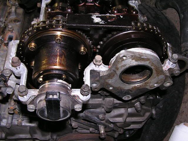

cammage

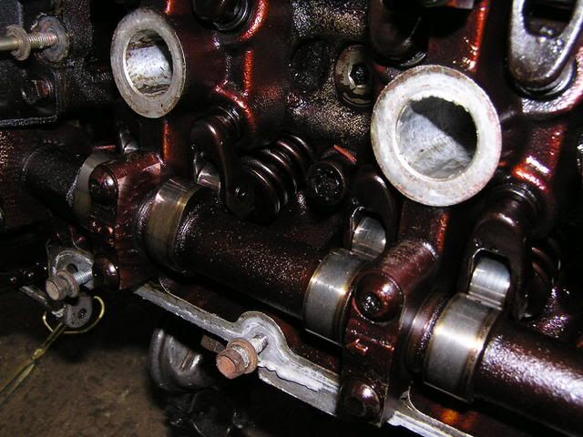

roller rocker arms
