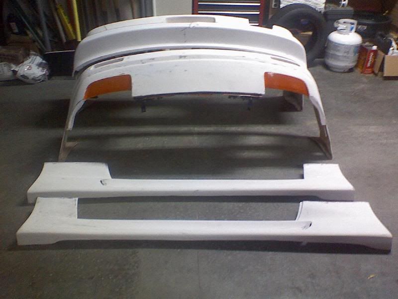

I started by cutting the lip off of the body kit. The thing sits low already, and add an extra low body kit on there; I had less than 3 inches of clearance in the front of my car. I was scraping everywhere. It had to go.
Next was to take off the body kit and start sanding. It took me a while to find the rivets holding it in place, since they were covered in bondo, but I finally got everything off. The front bumper was a breeze, considering 4 zip ties and 2 body tacks held the damn thing on.
It takes a lot to sand off the paint of this car. I don’t know how many coats of clear coat were on here, but it’s next to impossible. I am only half done with the front bumper after hours and hours of work with an electric sander.

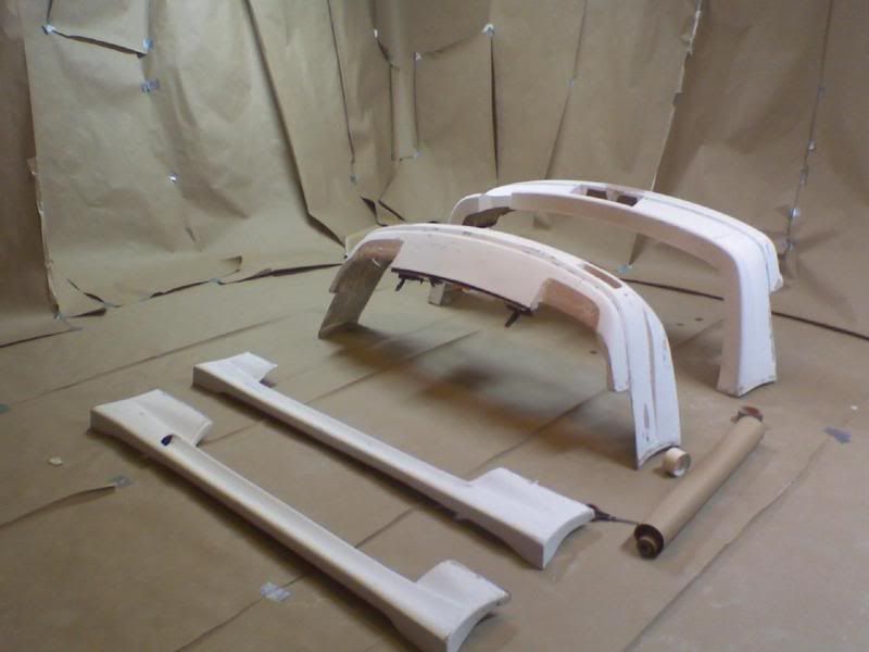

At the end of my first post I was still sanding, about to bondo, and then gonna paint. Well, I did all that, and here it is:

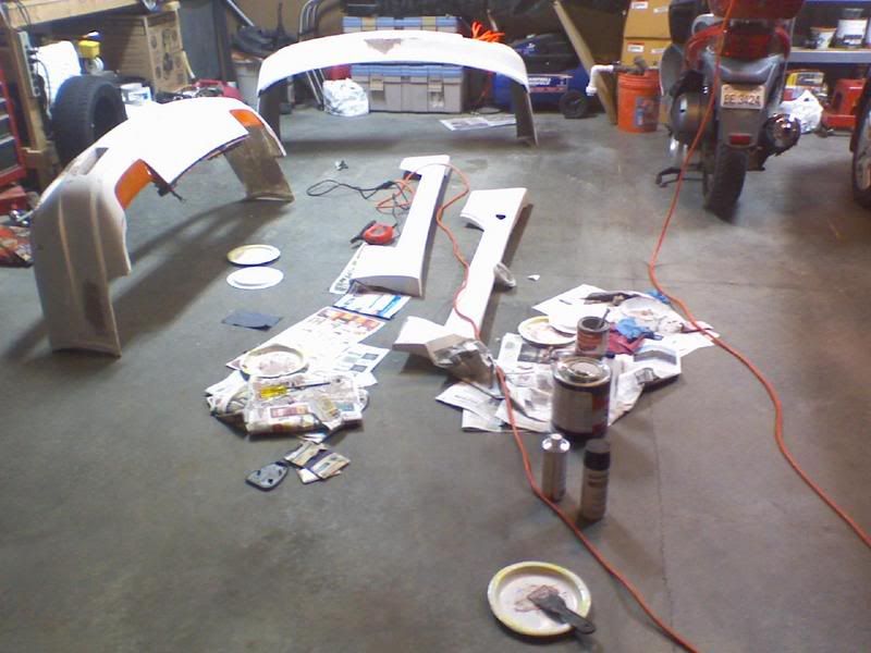

To start, the sanding took WAAAAAAY longer than I thought it was. I must have gone through 30 pieces of sandpaper on my electric sander. It took me a good 4-5 days to get everything sanded down, but I finally got through all of it.
http://img.photobucket.com/albums/v461/nick_neitzel/1119071504.jpg

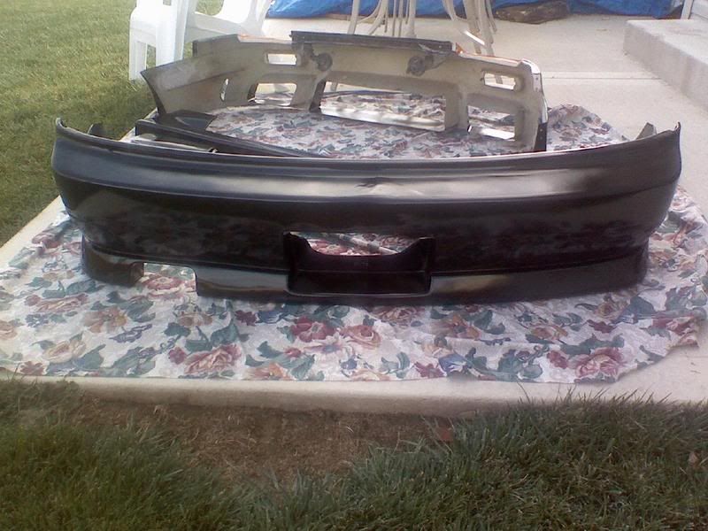

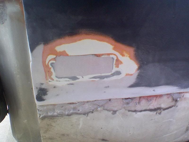

Now that everything was sanded, it was time to start bondoing my body kit. The kit looked like it was drifted into a cow farm and had dings and breaks everywhere. I patched all that I could find and the end result turned out well. I even bondo'd my front and back side turn signals (I know everyone told me not to, but I wanted to see for myself)
http://img.photobucket.com/albums/v461/nick_neitzel/1119072022.jpg

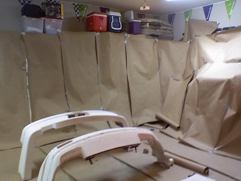

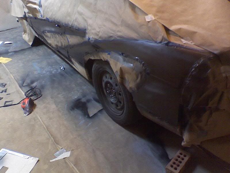

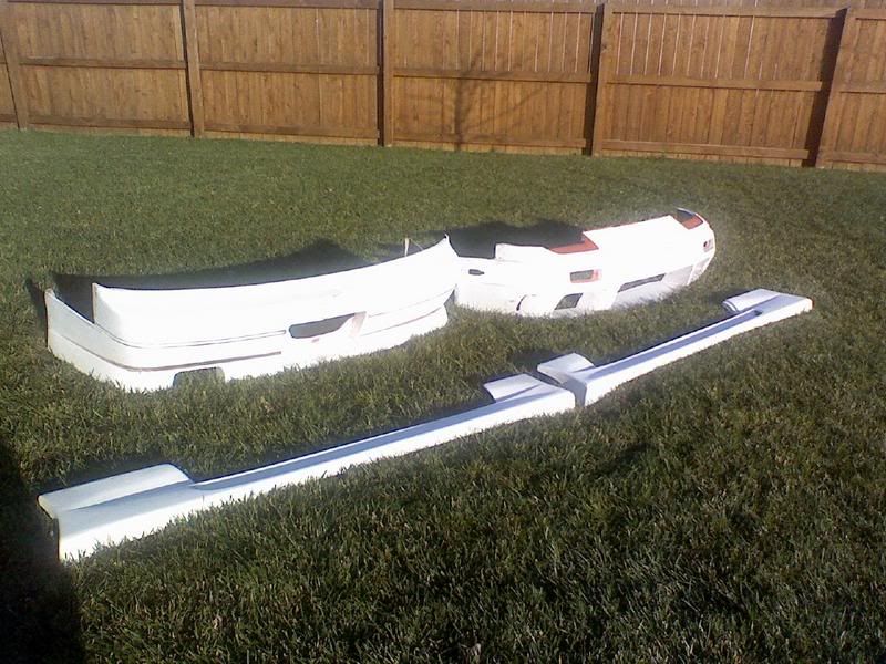

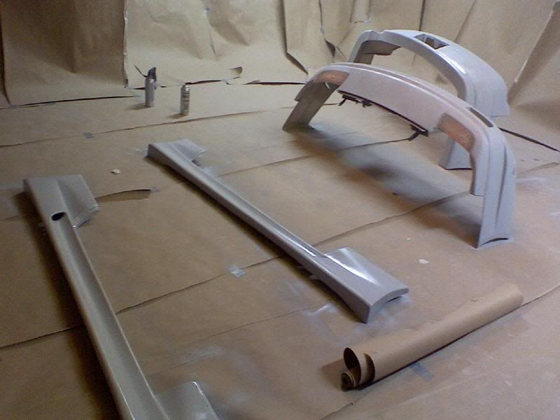

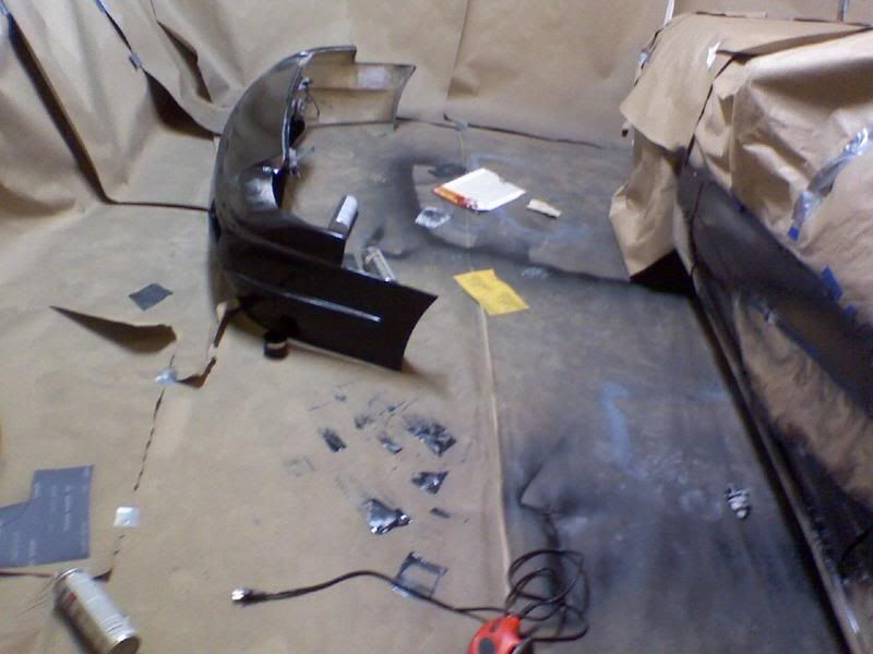

So, then came painting. Painting outside in the cold, wind and dust was not an option. I didn’t know how I was gonna paint this thing. But, a window of opportunity opened to me. My dad left town for a few days, which gave me just enough time to cover the ENTIRE garage in painters paper, tape the car off, and paint everything in the garage.
First came final sanding and priming of the bumpers and skirts. I started my taping at about 11 o clock at night, and didn’t get done sanding, taping, priming, and painting the body kit until about 6:30 am :happyfing

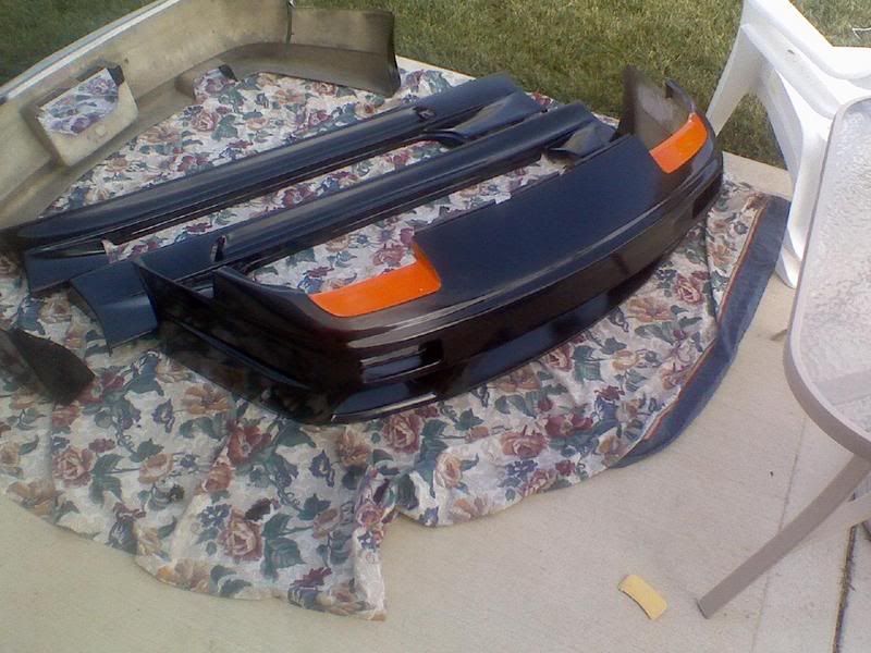

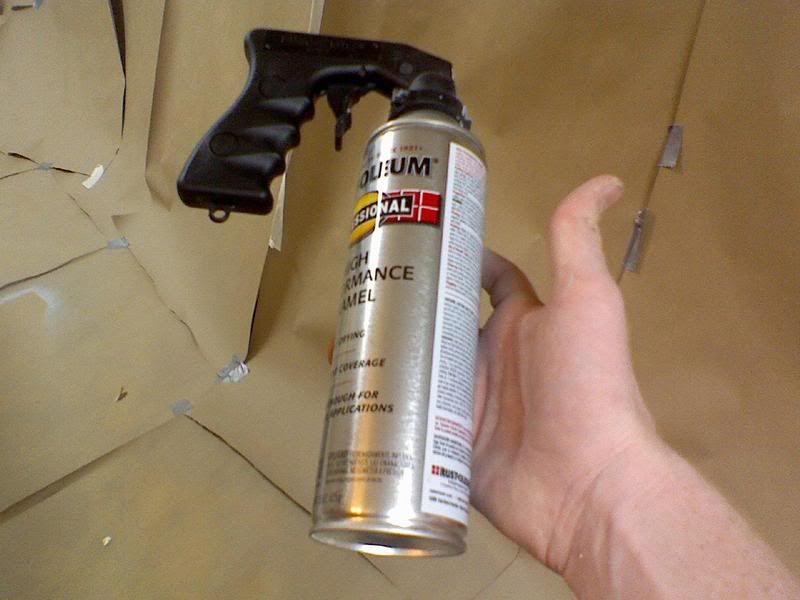

I was tired, so I went to bed, got up about 6 hours later, and started to tape the car off, then I painted it. I did all of this with industrial spray enamel in gloss black (hope it stands up.....)
http://img.photobucket.com/albums/v461/nick_neitzel/1122071109.jpg
http://img.photobucket.com/albums/v461/nick_neitzel/1121070457.jpg

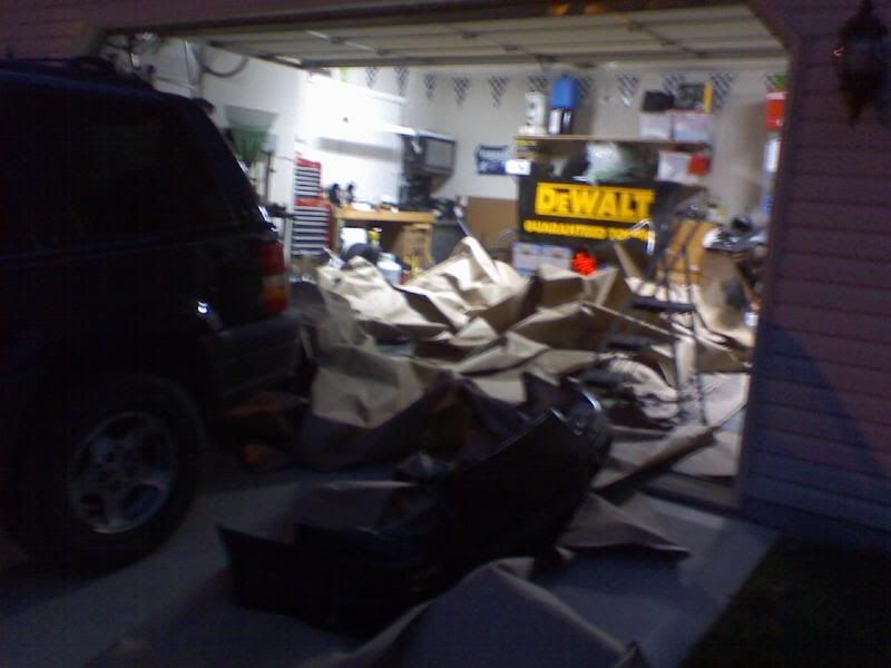

Now, I don’t want everyone in here to say "OMG, you spray painted your car! What a dumbass!" Well, to be honest with you, I was just after making my car look better. I’m not looking to build a show car here, but the old paintjob and f'ed up body kit made my car look like hell. So, I fixed it the cheapest and best way I knew how. And I am quite proud of myself doing all of this on my own with very little knowledge about what I am doing. Just kinda did it.
Back on topic, after everything was painted, I called my dad to ask him when he would be home. Turns out, he was already on his way home and already in Illinois. So, I hurried and tore all the paper off the walls and threw it into a dumpster down the street, and tried to air out my garage as best I could before he got home
The first thing he asked me when he got home is "what did you paint in the garage!?" I told him I didn’t, that I painted it at a friend’s house and had it stored in the garage because it was too cold outside. He bought it... :rotflmao

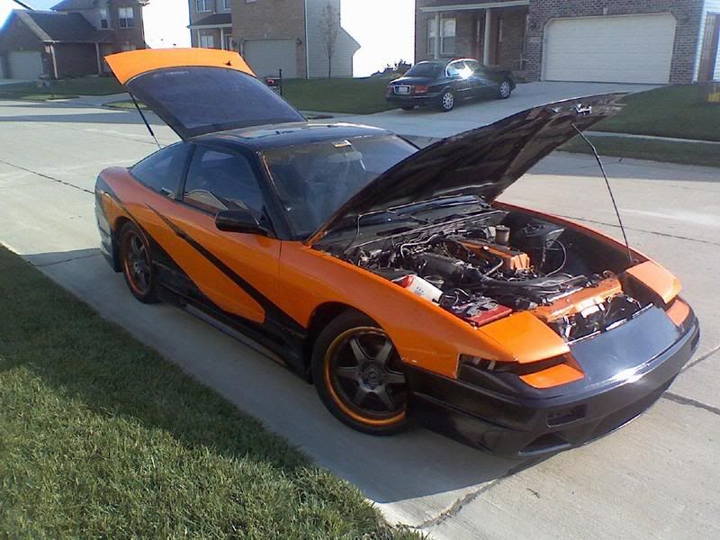

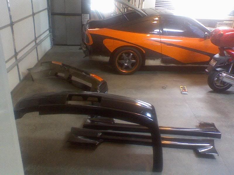

Then I had to remount the body kit, which I am in the process of doing now. I got almost all of the rivets in, just need to put a few screws in and mount the front bumper right.
http://img.photobucket.com/albums/v461/nick_neitzel/1123071409b.jpg
http://img.photobucket.com/albums/v461/nick_neitzel/1123071409.jpg

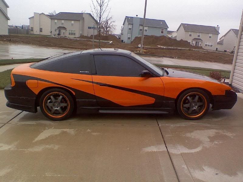

Hope to have pics of the finished car up sometime tomorrow. Gotta work in the morning so hopefully I can get this thing done before I gotta go to work, or else I’ll be getting more rides from family members, which is always embarrassing......
hope to update soon. Tell me what you think.....

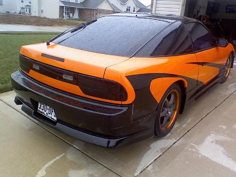

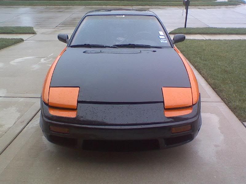

I like that you did the work yourself.
For the little that you knew, you did a good job with what you could.
But...
The bondo on the light hole was not a good idea. Although it looks good with paint over it. It wont hold. Not the way it looks in the pic. It's going to ruin your paint when it brakes off. (and it will.)
None the less. Good job making it work for now. Hope it gets done right in the summer though.
The Paint choice was cheap, but i've seen those paint jobs last over a year. So your job should last easily till summer.
The color choice is not my style, but it looks to be evenly glossy between the two colors.
I cant comment on the rivits since i can't see them very well.
Rivits are rivits though. As long as its holding and you can hide them well then it'll come out good.
Hope they were'nt too tight though, If they were, then it might crack your kit with little flex applied.
All in all. I'd say you did a good job with the time and skill you had.
