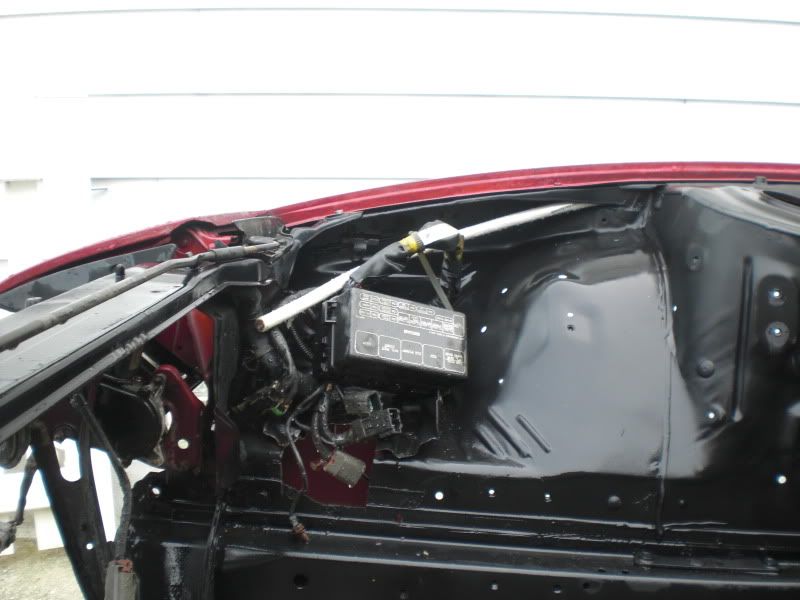

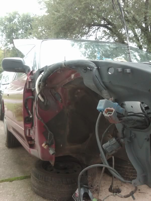

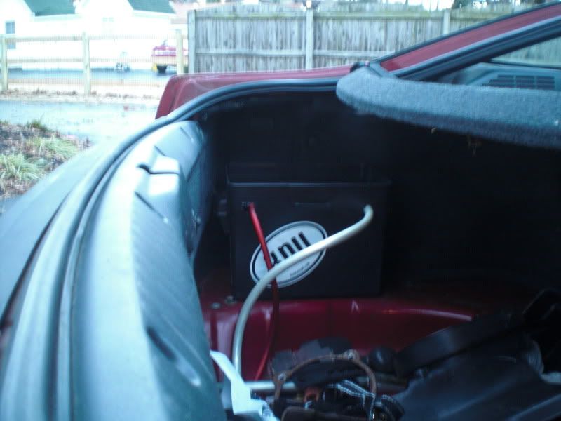

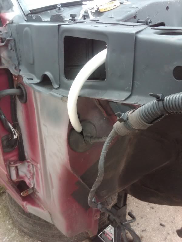

I have a distribution block in my engine bay that goes to the starter, ACC, and battery in the trunk. I ran a 0 gauge wire from the passenger side original battery location, up under the fender (tucked away really nicely), into the cabin. Then after in the car I ran it under the passenger seat where I put a 300amp inline fuse to prevent fires. After the fuse it goes under the carpet and wraps around the sides of the trunk. Let me see if I can get some pictures.

Here is the trunk ( sorry for blurry picture)
The white wire is the 0 gauge relocation
Into the cabin
Before I hooked up the distribution block

Only about a foot of my power wire is exposed under the fender. Other then that it is all enclosed.
