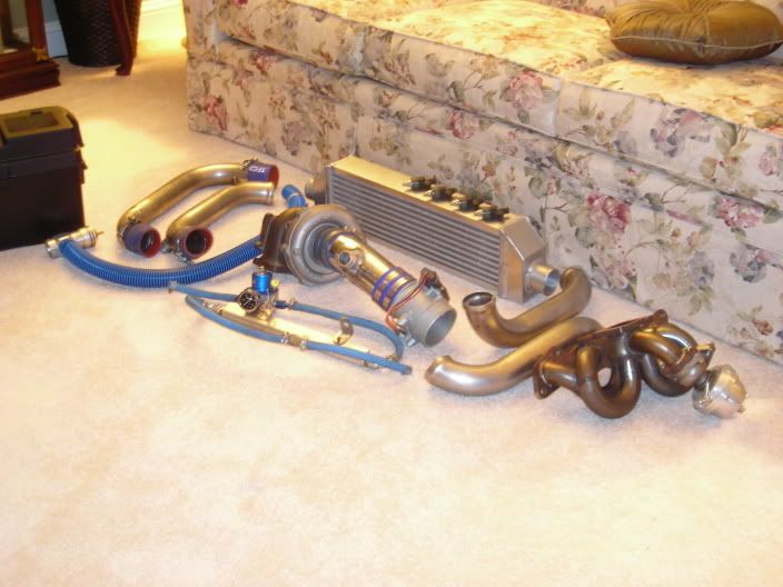

Shipment came in today :D:
93 Cobra MAF (eewwwwww ford....)
JWT Reflashed ECU (for 50 lbs injectors, 93 Cobra MAF and turbo)
Custom equal length tubular turbo manifold
Tial 38mm Wastegate (7 psi spring)
pics:
Ewww lol who ever thought I'd want factory FORD parts on my car lol
Shipment for tomorrow:
5 bolt 3 inch downpipe w/ wastegate flange
oil pan w/ welded bung for oil return
MSD 50 lbs injectors
custom fuel rail
SX fuel pressure regulator
XS power lol recirculated bov
Intercooler w/ Greddy Core
IC Piping
Oil return and feed lines
and picking up a new cone shaped air filter
Yeah I didn't write it oops lol

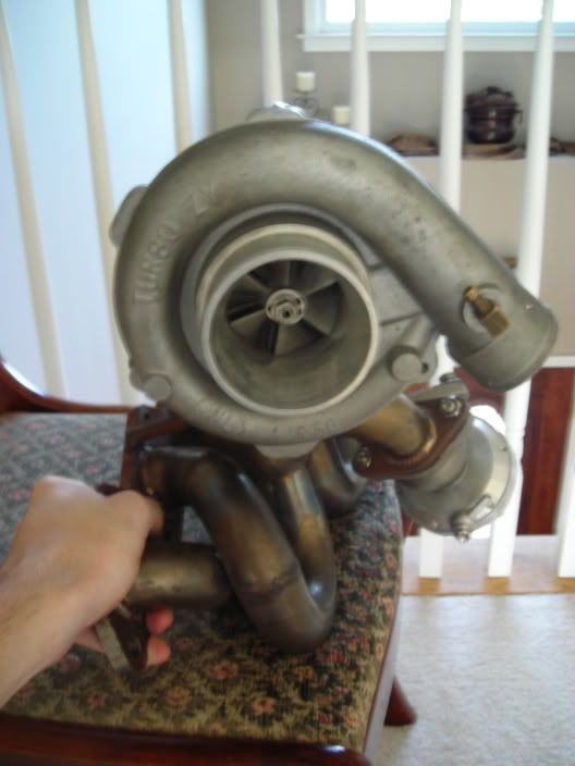

Its a t3/t40e hybrid for now.
In the next few weeks i'll be looking into the GT3071R (i got this turbo free from a friend in high places ... and it was just laying around their shop) but i'm not sure how to go about a water and oil cooled turbo. So after that I was thinking of going with a precision SC 50-something.

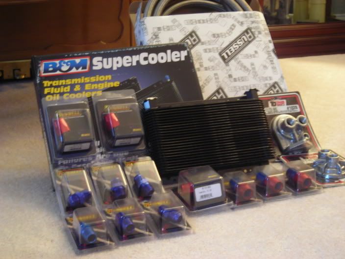

B&M Oil cooler (13.5x9x3.5) w/ 900 CFM fan and hoses for a relocated oil filter as well...
not sure where i'd put the cooler though
