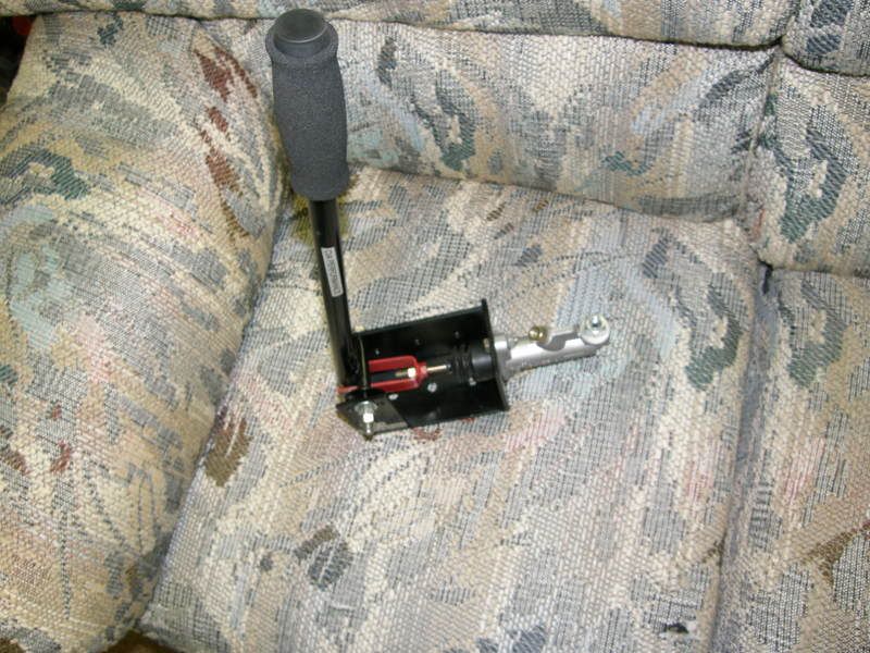

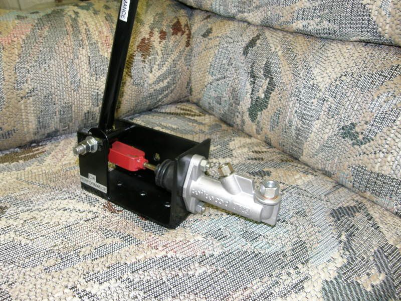

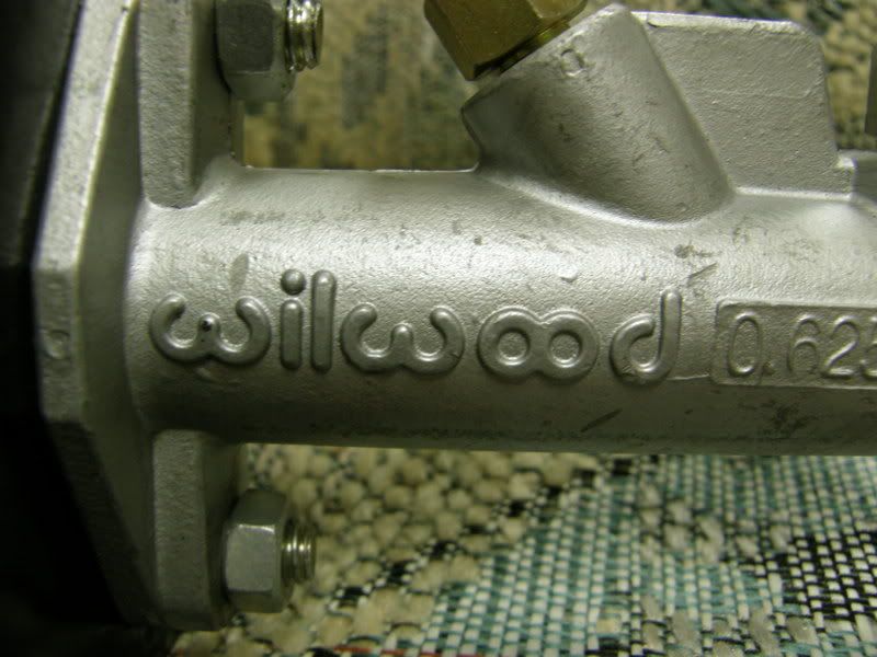

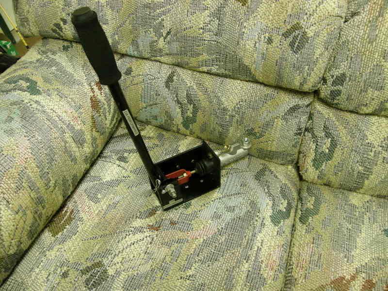

hey if you do decide to go hydraulic me and my brother make these in our fab shop, a lot of local guys here are running them and love em, Ive got one in my race car. Me and a buddy tried cnc's a while back and they never worked the cylinders were shit, so we fabbed these up and use wilwood cylinders on them, if anyone is intrested in some feel free to PM me.
btw the handle is exactly 16in long, the angle of the pic makes them look super long
