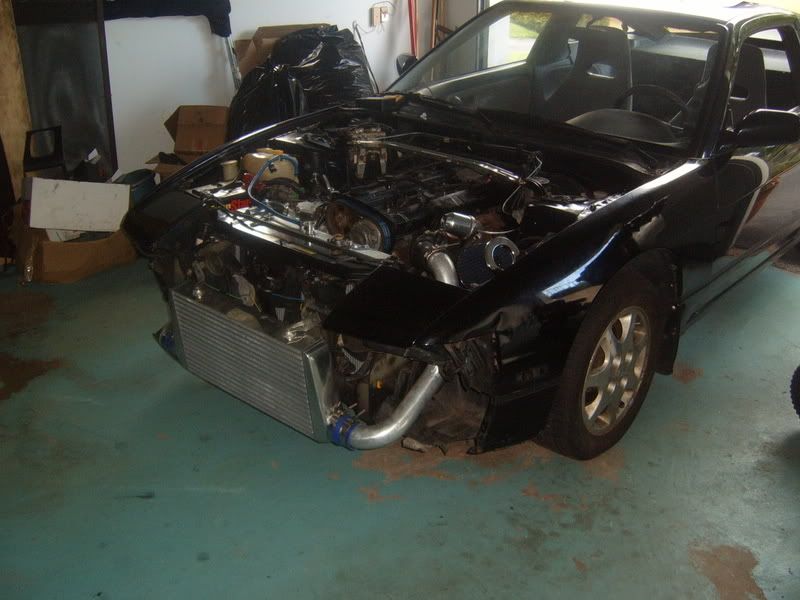

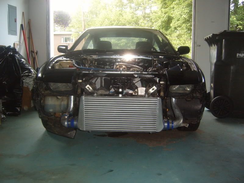

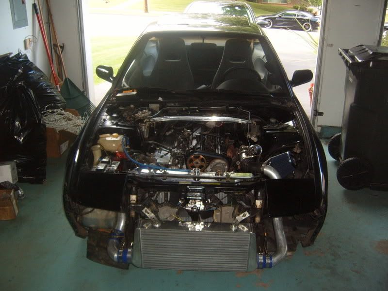

Bah. Just get a SR20 ebay kit and call it a day. Because of my intake mani it was a direct fit!!! Only had to cut it. Heres a couple pics.
Notice those were both atleast 450 bucks. I'm looking to spend under 300.
Also, I'm running the stock intake manifold that runs across the motor.
His is a custom made, similar to a ca/sr/rb26 intake. It doesn't run across the top of the motor. RB20/RB25 have one that runs along the valve cover sideways.
