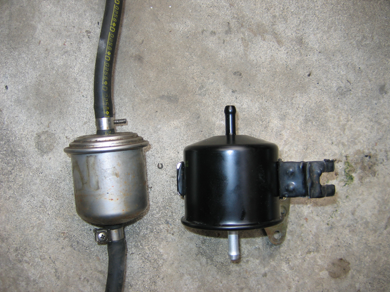

Make the one on the right look like the one on the left. :D One thing I did was replace the fuel lines since the lines on the old filter were probably as old as the car. I went down to the autopart store with a small sample and picked up about 3ft of new hose.
As you can see the bracket still works good on the bigger 300zx filter.
