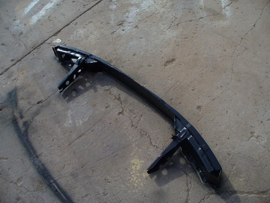

We did have to cut the impact bumper and narrow it/reinforce it with some steel plates
here's what that looked like.

what did y'all use to cut the metal bumper?
what's the point of keeping those bumper when the support/mounting plates are almost non-existent. it wont resist a crash at all that way.
my favorite is Ruskers, custom core and endtanks, fit right where the A/C unit did infront of the radiator, sleeperific too
chop saw.
lol @ plasma cutter w/ guides. no one can see the bumper support so why bother trying to make it perfect?
edit: nevermind, i took another look at your picture. didnt realize you cut it like that. still you weakened it so damn much its probably useless anyway
