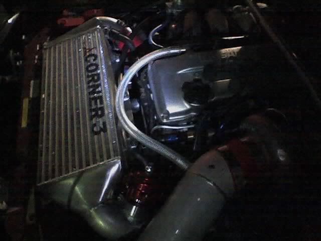

i've spent about 5 grand on my built single cam and under 400 for engine management INCLUDING the wideband.
