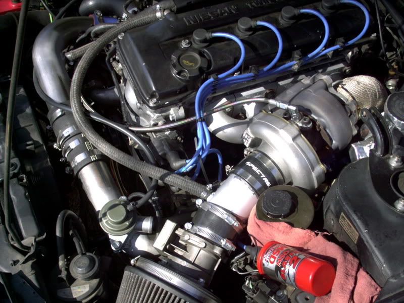

Hi I just turbocharged my ka24de on my 1990 fastback. i know this sounds rediculous, but at 6psi, i am slower than before. :tears
here is my setup:
jgs stage 2 log manifold
t3/t4
3" downpipe
turbosmart wg 35mm
reflashed ecu
walbero fuel pump
1g dsm bov
sr370 cc injectors
i did back off the timing to 15 degrees... to be safe.:yummy
thats basicly it..
now what is happening is i just don't feel any insane rush of power, just a bit of lag then a tiny bit more power, it is a little slower than before when it was n/a and stock!
I am very dissapointed and feel like going back to n/a.
please help me figure this out! Thanks!
here is a pic if it helps.

Did you lose your intercooler (seems to be missing):
i am not using one right now, my reasoning is because the z31 turbo and 280zx turbo don't have one, and they don't have even a bov, and they run more boost, so i should be ok! but for 6psi i should be safe. i am planning on using my smic if and when i raise boost.

i called my friend, who tuned my ecu, he says it was designed to work with stock timing (20 degrees) when i retarded the timing to 15 deg. he says it lowers the timing to 9 degrees when under boost. so whe i bring it back to 20 it will be 14 degrees. i'll bump up the timing tonight and go for another drive.:heyhey
well i brought it back to 20 deg. it is definitly faster, but i'm still not happy with the power. it only seems to have 20-30 hp more than stock.
I guess i'll get a new chip set burned with more aggressive timing and fuel trim. its a bit rich and 14 degrees seems to be so-so.... but heck! its safe and my car runs good. cept two things.... a small lean spot when you first hit the gas hard for a split second. and the other thing is it wants to die, or stumbles when i let it idle down aggressivly.

one, you need a better tune. go to a shop and pay for a better tune. the tune you have now isn't specific for your car, it is basically a guess... and guessing isn't good enough
second, at 6 pounds of boost, all you're gonna gain is 30 ish HP.
a stock sr20 will beat you with only 6 pounds.
if you want to go fast, get an intercooler on there, bump the boost to 8-10 and get it tuned. the better the tune the better the engine will run and the more power you can make.
i say run a fmic - install a fpr - boost gage - boost controler that should help
without a fmic all your doing is pumping hot air into the motor i would recomend one even if its a stock sr20 fmic
and have your ecu re maped

You should be running a walbro fuel pump and you would need a better fpr for the increased flow. So get those two things. Otherwise, you are on teh right track with the new map and ic. I would not expect your car to make more than 30hp extra with no ic.
the biggest mistake you got is that you don't have a wideband, you need one ASAP!,also what type of gap are u running on the spark plugs?also it looks like you have a eBay turbo that could also be the problem,check on your boost gauge to see if your building any boost.

uhhh if you look at his post it said either run a blow through setup or recirc your boc\v. it didnt say that he was running blow though..
anyway..get the fmic. and recirc the bov. wideband and tune. dont go back to NA. trust me you havent seen what that turbo could do. the first time i drove my ca(.4l smaller) with a t28, at 6psi, i about shat my pants. dont worry that will be a fun car. its a learning process which takes time and patience
