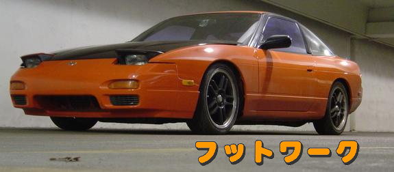

Rev, let's see the car. =o)

yeah, i woulda had to pull the engine for absolutely no reason other than to get the bay sprayed, and that would have just been way too much effort... so i'm waiting until i pull it this summer (new head gasket, valve seals, piston rings), at which point i'll be spraying the bay flat black... i'm actually thinking about redoing the whole car, because i did the body work this last time, and didn't do the best job in the world =\ thinking about getting the car painted triple black. anyway... threadjack, here's pics :D
Yep, heard o' Soco. Where'd you hit up for those pictures?? Some pretty choice locations.
How many peeps you know around here with 240s? Thinkin' of meetin at Ameristar one night to kick it or something....(parking garage full of 240s = sexy)...

mmm, garage full of 240s..... :drool:
meh, not many, actually off the top of my head i can only think of three. but there's a few around, i bet we get 20 or so at the meet in march. these are just samples of a series i took, first pic is on meramec bottom under the highway 21 bridge, pic two and three are on old lemay ferry, and the last pic is in Arnold Park off jeffco blvd, just south of the meramec. as you can see, soco and the surrounding areas make up a nice big decrepit shithole :D
