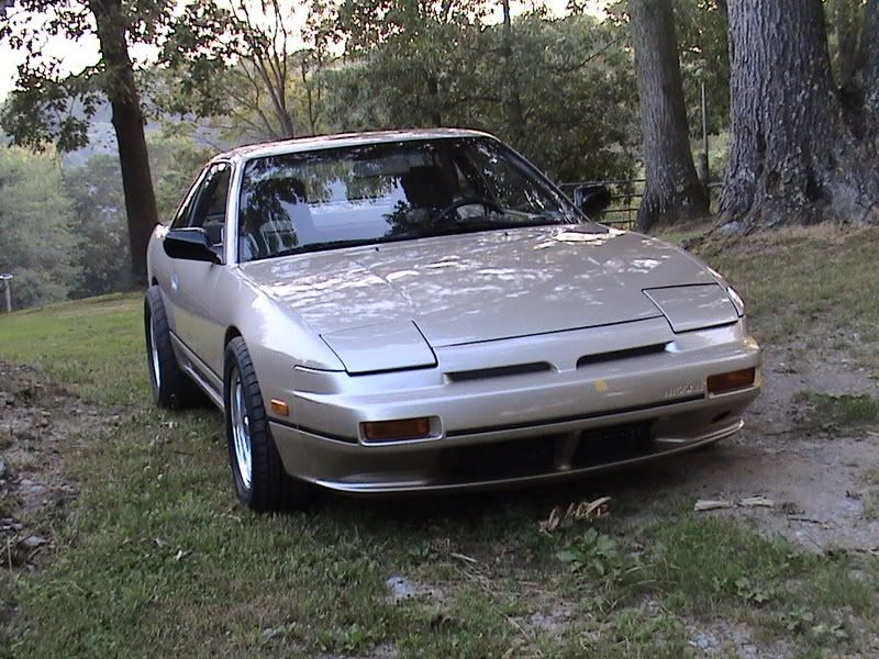

Heres my S13 SR Project in all its glory. Goal is to exploit the SR20's High Power Potential.
