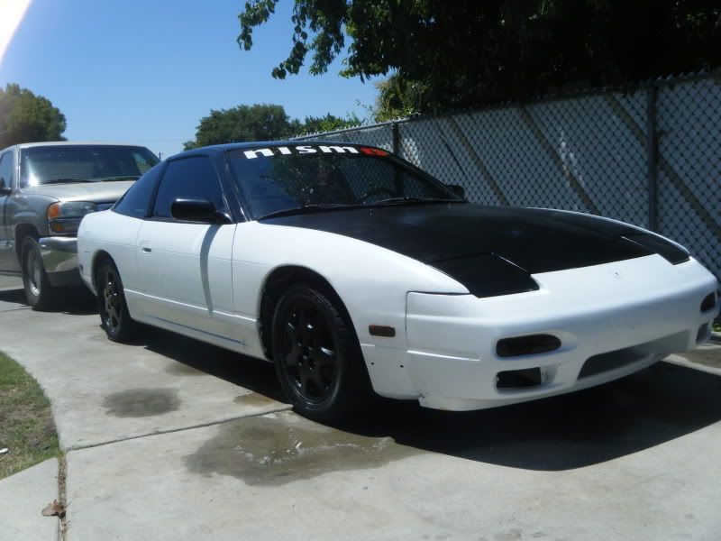

i got tokico hp blues w/ ksport gt lowering springs. i also have a smaller profile tires on the stocks, which is why i have a good size gap in the wheel well. all in all it gave it about a 2" drop.
