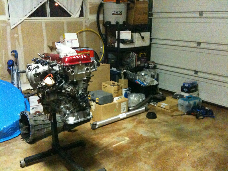

Since my wife and son decided to visit relatives in Japan for a month and a half, I decided that I can actually work on this project again. Right after they flew out, I went ahead and at least moved the SR to my pad. I think my plan now for this is to replace ALL of the gaskets and put in some fresh items (oil pump, water pump, etc.) Now, lemme see if I can finish this before they come home in July....
Current location of SR
After doing the SR, i'm planning on moving the S14 over here and work to get the SR in there...

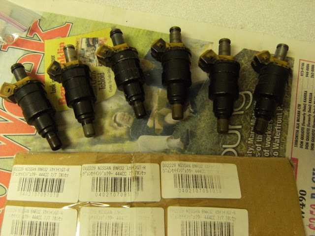

i got my engine from jdm hot also(a rb20det) they are good people. but you should sell me those gtr injectors..

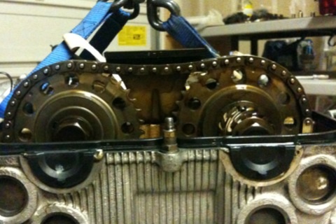

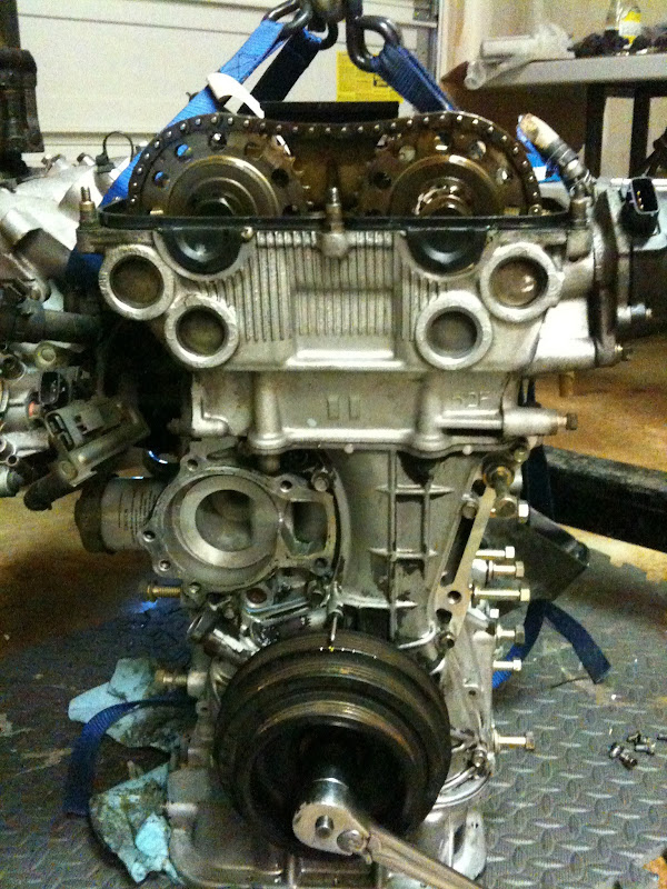

Rotating Crankshaft Again

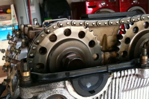

Ok. I went and tried spinning the crankshaft again to get the dots on the cam sprockets to line up.
When I got the dots to line up like the FSM, the silver links on the chain IS NO WHERE NEAR THE DOTS! I guess the person who changed it last didn't put the chain in the correct place :WTF:
I'll just stop right here... get back on it tomorrow night

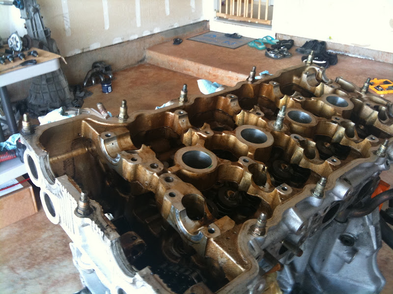

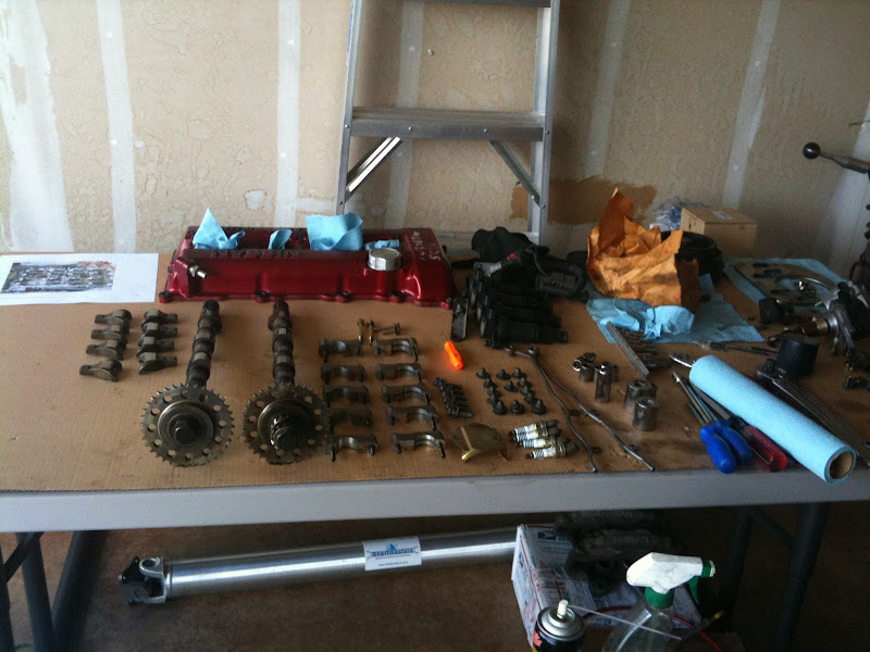

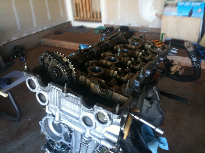

I started today by removing the camshafts and sprockets from the head.
I wasn't worried too much about the timing chain too much as I was planning on replacing it with a new one.
My table with the stuff I removed so I don't forget where they go.

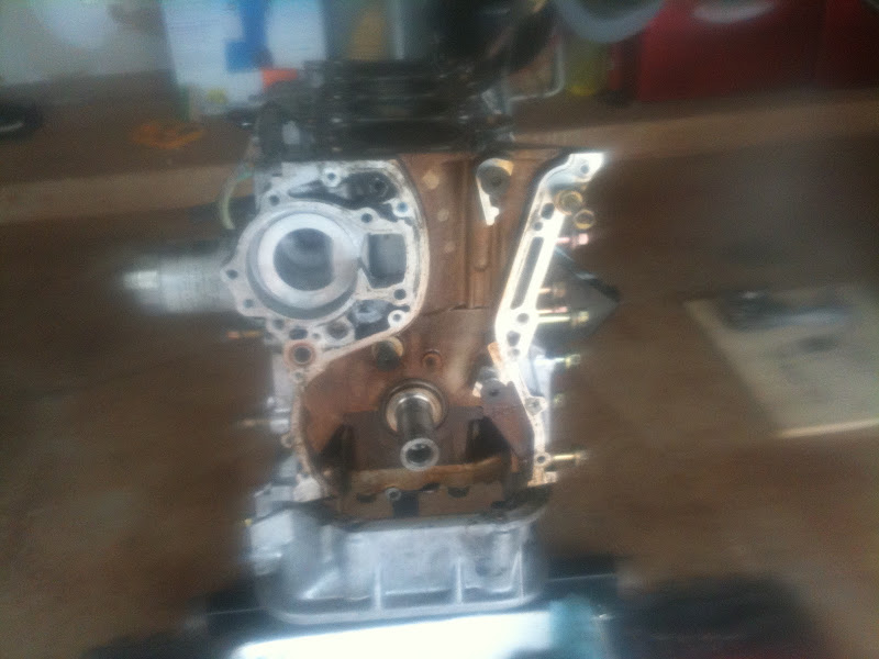

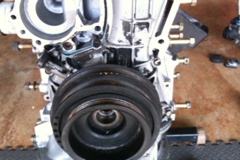

Next, was to remove the oil pump. I didn't realize that in order to remove the oil pump, I had to loosen/remove the upper oil pan. I ended up just loosing it ATM to take it out. I also took out the timing chain and guides as well. (yeah, picture is blurry)

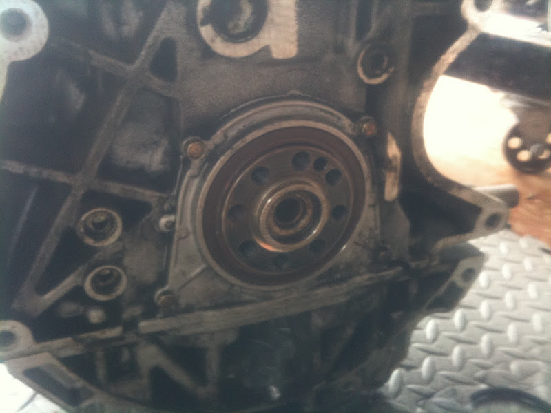

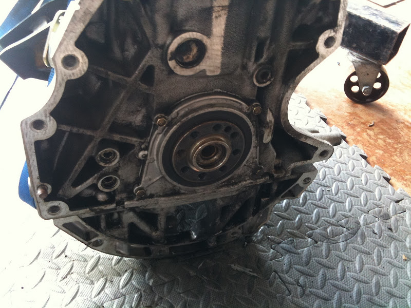

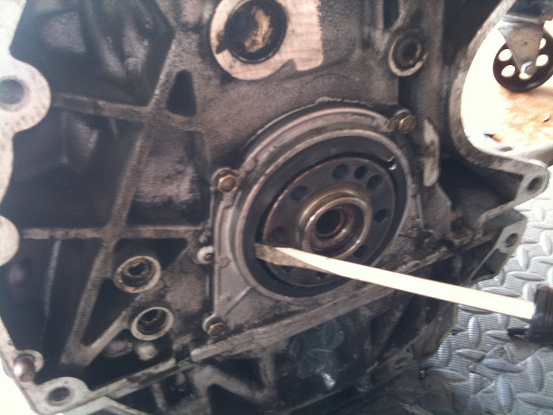

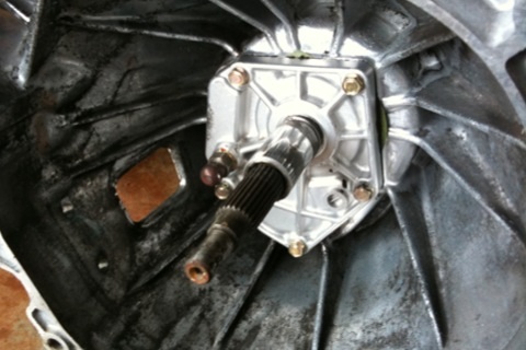

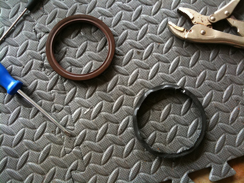

At this point, I decided that I should remove the flywheel. Since I have access to it, I should replace the rear gasket too.
That seal was a b*tch to remove. I ended up taking out the rubber part first (gasket is actually mostly metal), and using a screwdriver to wedge it out.
Old gasket & new gasket
Here it looks after I tapped in the new seal using the old seal, a piece of wood and a rubber mallet.

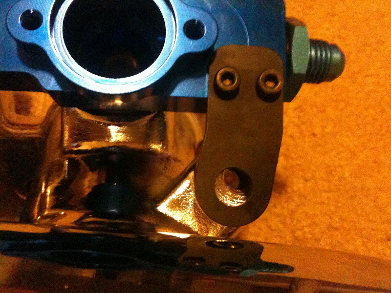

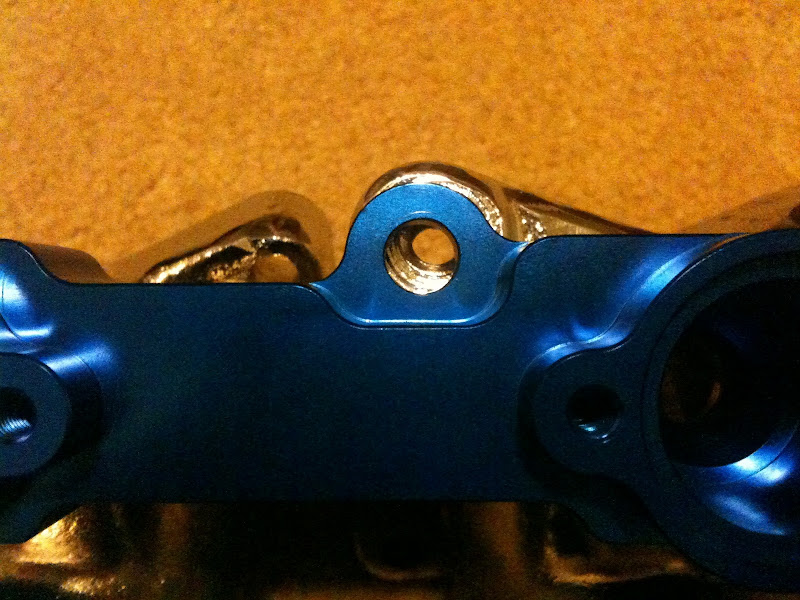

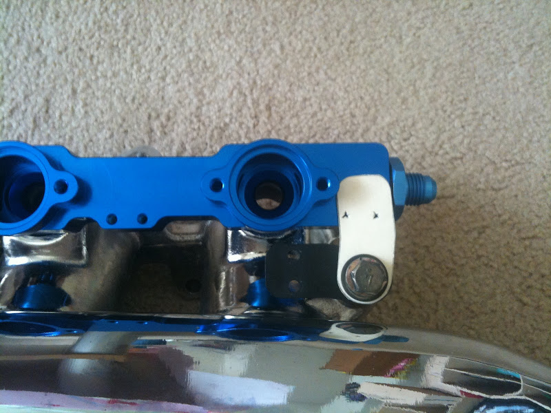

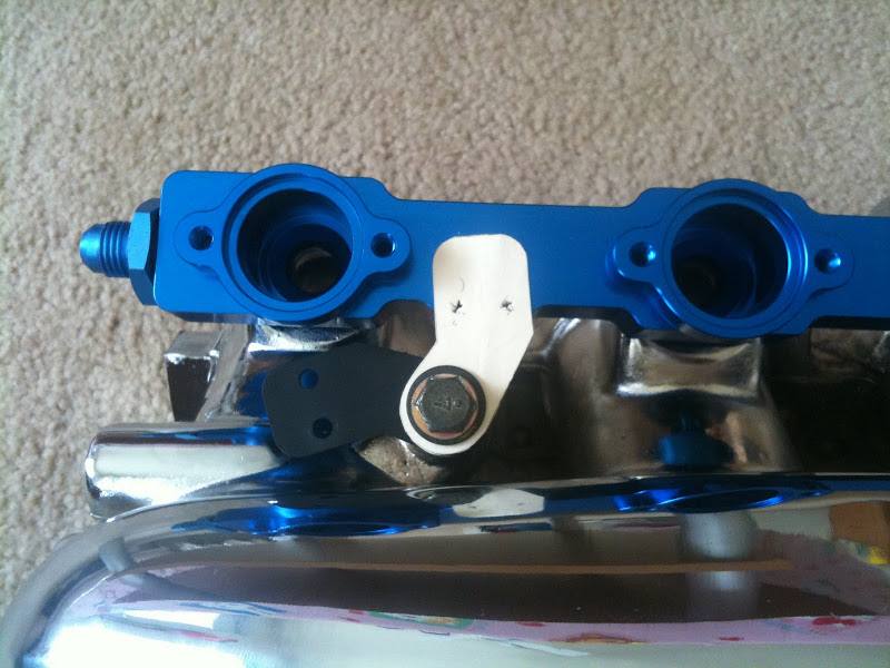

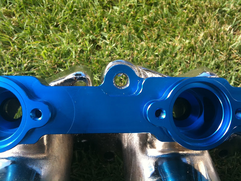

I decided to take a break from the motor and started working on mounting this billet side-feed fuel rail on to my Freddy intake plenum.
After putting it on, NONE of the mounts lined up :WTF:
So I decided to re-drill the lower mounts (using templates made from a manila folder) to make it match.
I also decided to re-drill the top hole to be able to put a bolt to hold the top part of the rail to the plenum.
Looks much better now. Maybe I'll go back and remove part of the lower brackets to make it more clean.
That's it for now. I'm hoping I can drop off the head to the machine shop tomorrow.

Damn, looks like you did some work lol. Well she didn't get back to me yet but I'm goin to her house in Mililani sometime this week to get my tires changed out then I'll ask her. Her GS-R is makin 171whp fully built on Low Comp pistons for turbo but no boost yet, just built block.

I then thought, maybe I should put the new timing chain kit before I have a harder time later. The sprocket was a PITA to put it into place, but it's there and I won't complain too much about it now.

I then installed my camshafts, and verified that the timing chain is where it supposed to be.

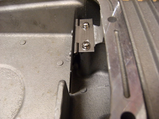

I then started to work on my RAS. I remember that that plate needed to be trimmed. I grabbed my dremel and trimmed it like so:
Installed:
After putting on the oil pump/front cover, I realized that I needed to install a bolt that connects the head and the cover. :1duh I had to wait until my neighbor came home so I could use his impact gun to remove the sprocket.
That got fixed and continued to install the water pump. After putting it on, I realized that I either misplaced or lost the studs. Would a bolt and a locking washer suffice? Or should I just order the studs?

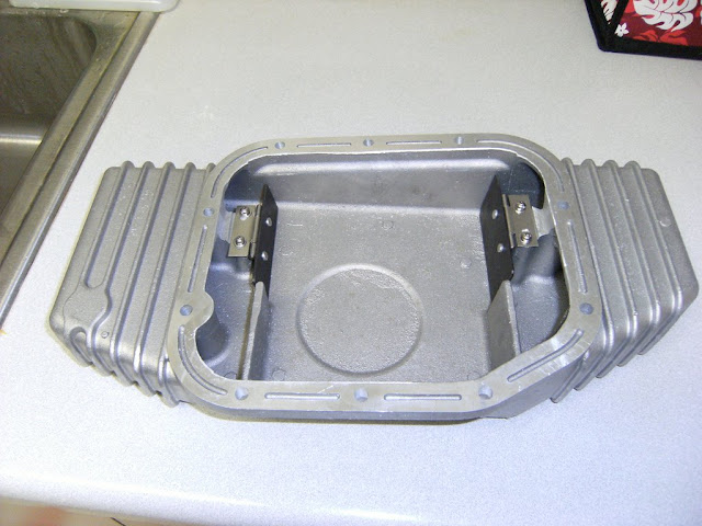

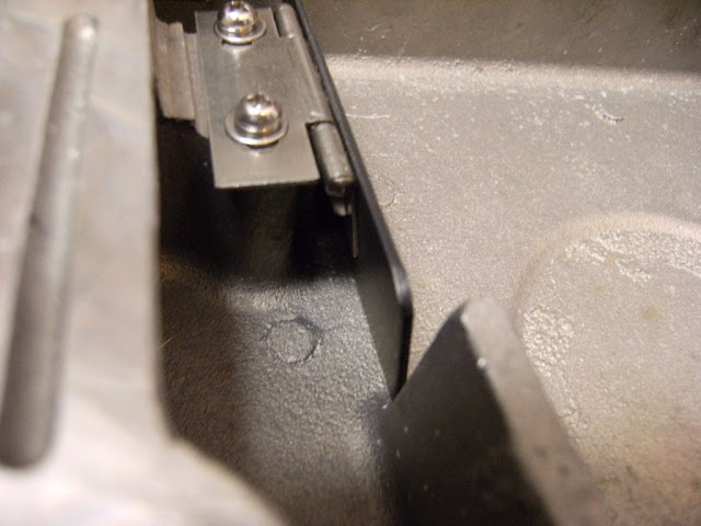

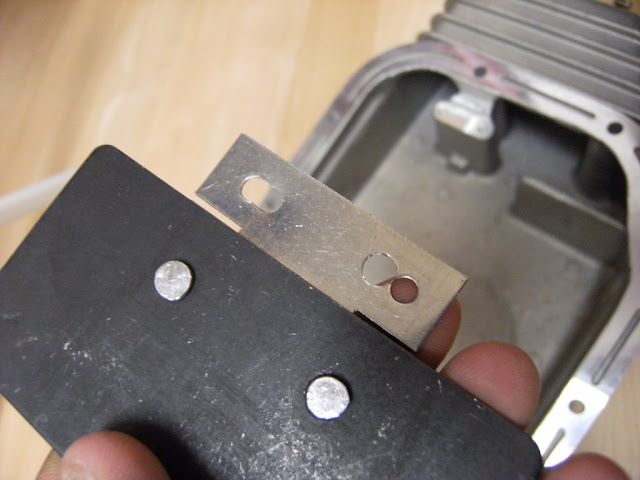

Next since i'm going to be using a freddy knock-off oil pan, I decided to test fit it before I put some liquid gasket. Good thing I did as it didn't close completely. That's what you get when using knock offs, issues..
Found out the oil pan was hitting against that plate. I was thinking to either grind down the area in the pan to fit, but decided to cut the plate.
It fits now.

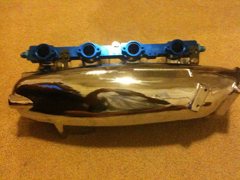

I didn't complete it as my hex bit isn't long enough to tighten all of the bolts. Plus, the Nissan liquid gasket tube was leaking through a lot of small holes around the tube
I'll pick up those things tomorrow. I just wanted to see how it's gonna look with the knock-off intake manifold, so I put it on and took a pic. It looks pretty good.

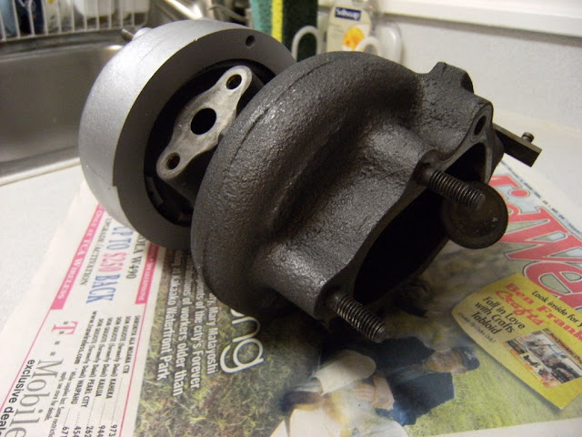

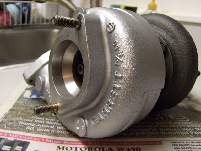

I took apart the KA throttle body (want to see if I can use it for the cruise control), cleaned it, painted it and re-assembled it back together. I think I'll paint the pulleys also.. :p

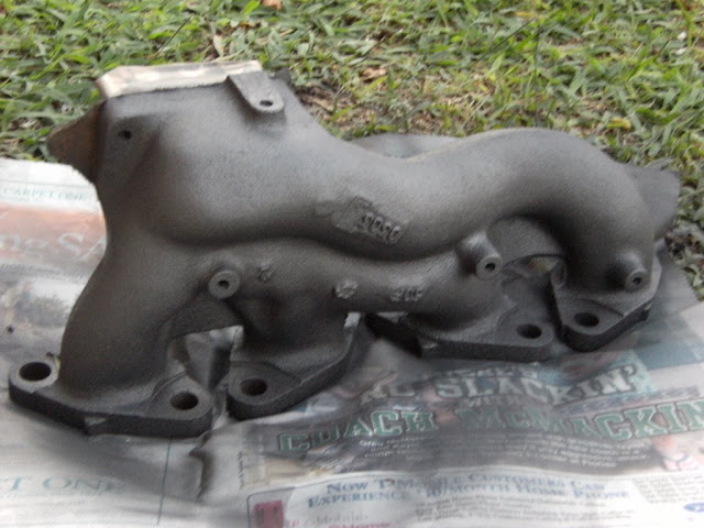

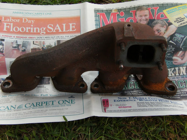

I don't have my exhaust manifold studs yet, but I wanted to do some test fits. After installing the turbo, I didn't like how the coolant line from the block to the turbo sat. I think i'll get a 45° or 90° adapter so it doesn't stick out.
I looked at my exhaust, and thought I should clean it. It came out nice and shiny after using "Nevr-Dull" and a soft rag. It's an old Apexi exhaust (back from '97), but it still looks decent so I might still roll with it.
