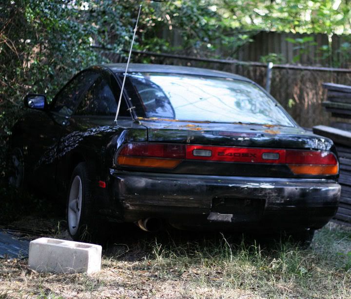

i for some reason dont have much for before pics of it...
only pic i can find of the before.(mom took this pic after i put it there.)

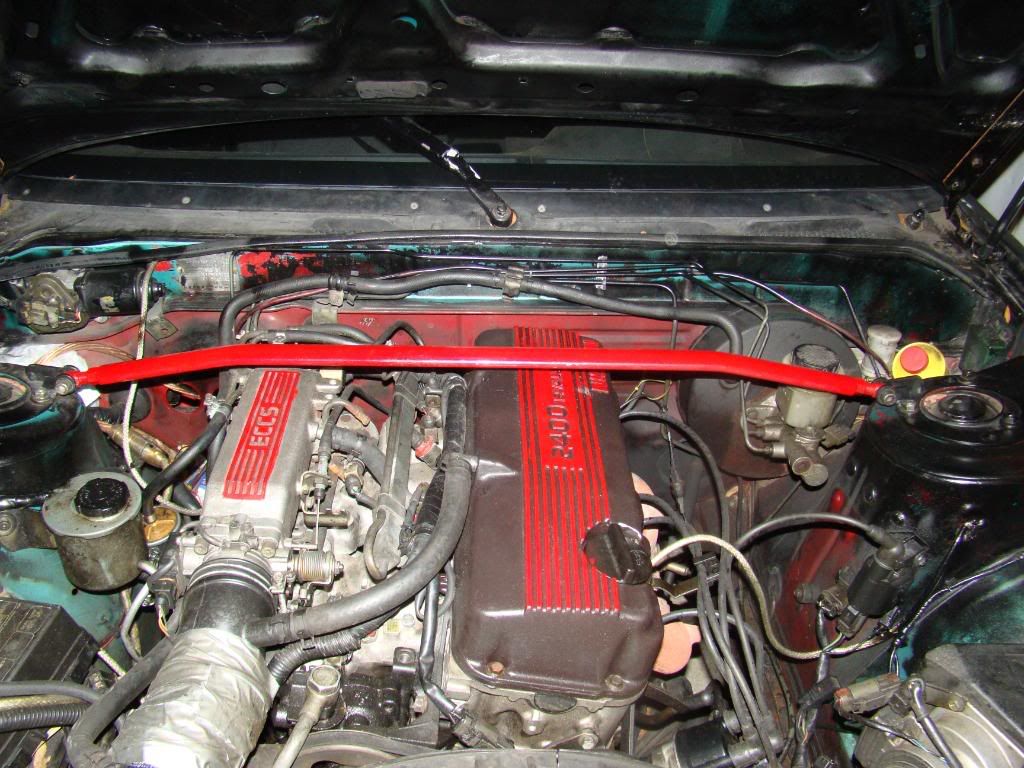

i got a motor from a friend for free. was a high comp sohc deciently built.(so i was told when i got it.)
ran great. dd'd it for about 7 months.

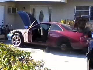

after the accident...
motor was pushed foward 3 inch's.
right before it went to the junkyard.^^^

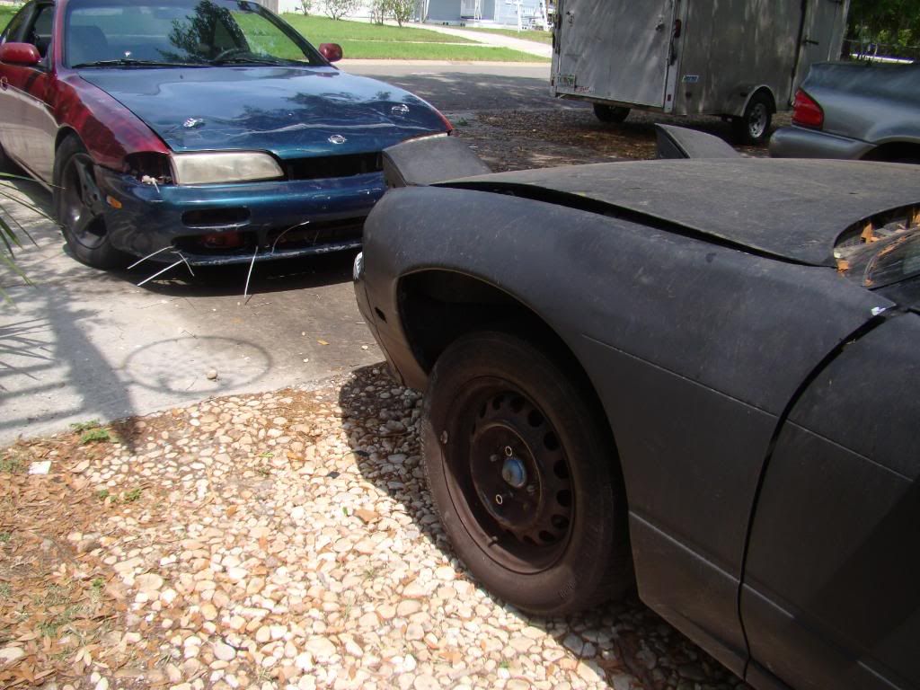

u can see the bumper of 240sx#3(truely 2 but i bought the same one twice...) $900

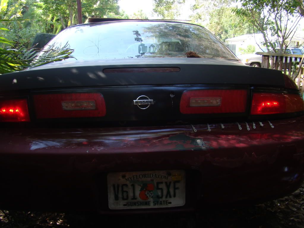

lowered on megan springs.

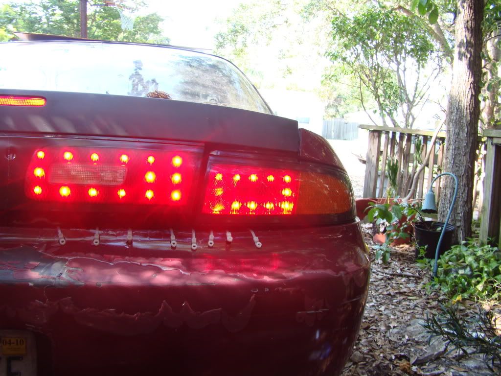

did a bunch of led mods.
both dome lights tail lights turn signals...
some of the leds.
breaks
tails
turns were 3 arrows
<<< like that.

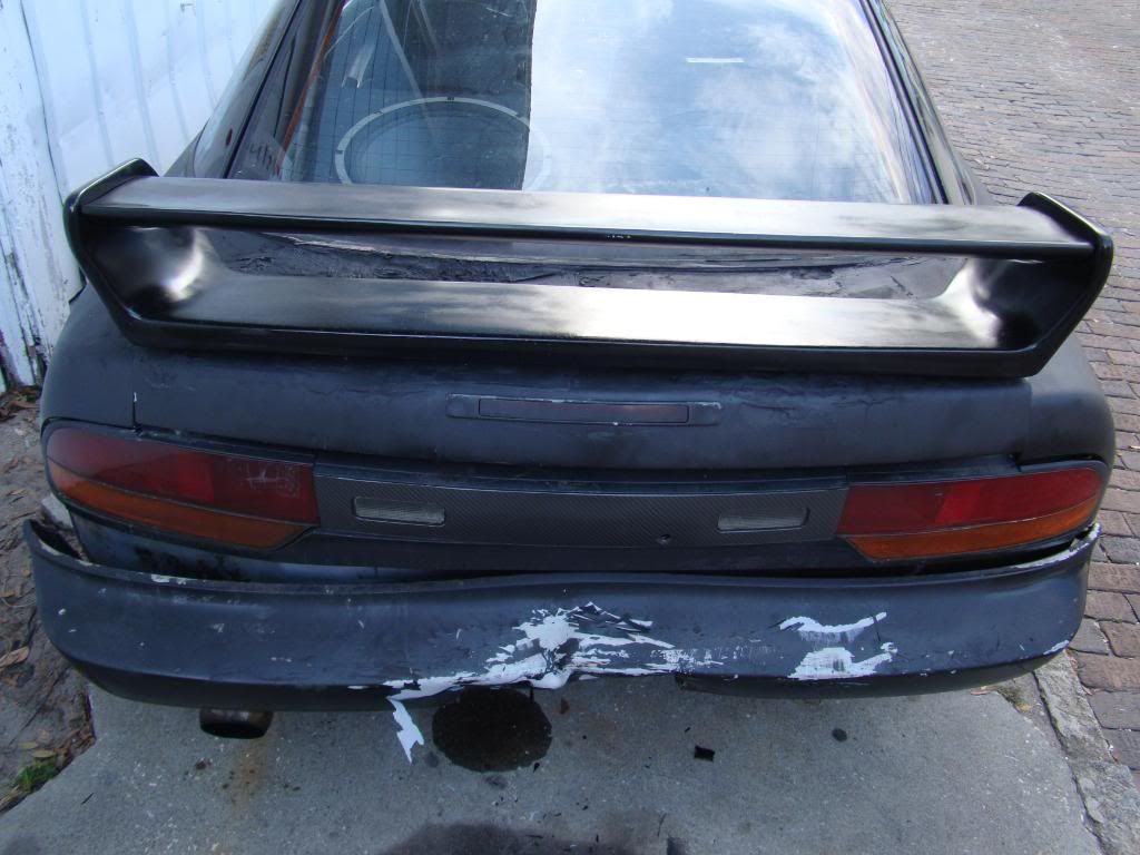

i got tboned roughly 3 weeks after owning.(they call it sideswiping from how he hit me but i say its a tbone.)
guy ran a stopsign to go left and hit me with the front right side of his bumper around the doorhandle area and nearly ripped my bumper off. ended up shifting my rearend about 2 inch's to the pass side.
couldnt get a good pic.

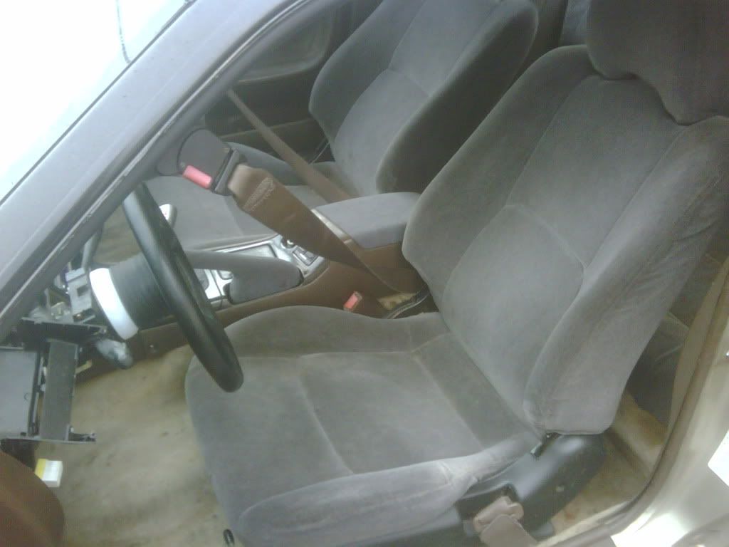

changed the seats first day

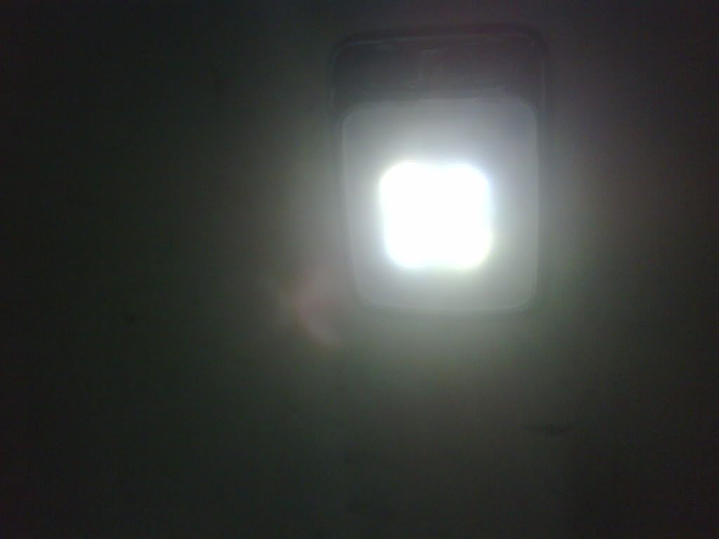

dome light

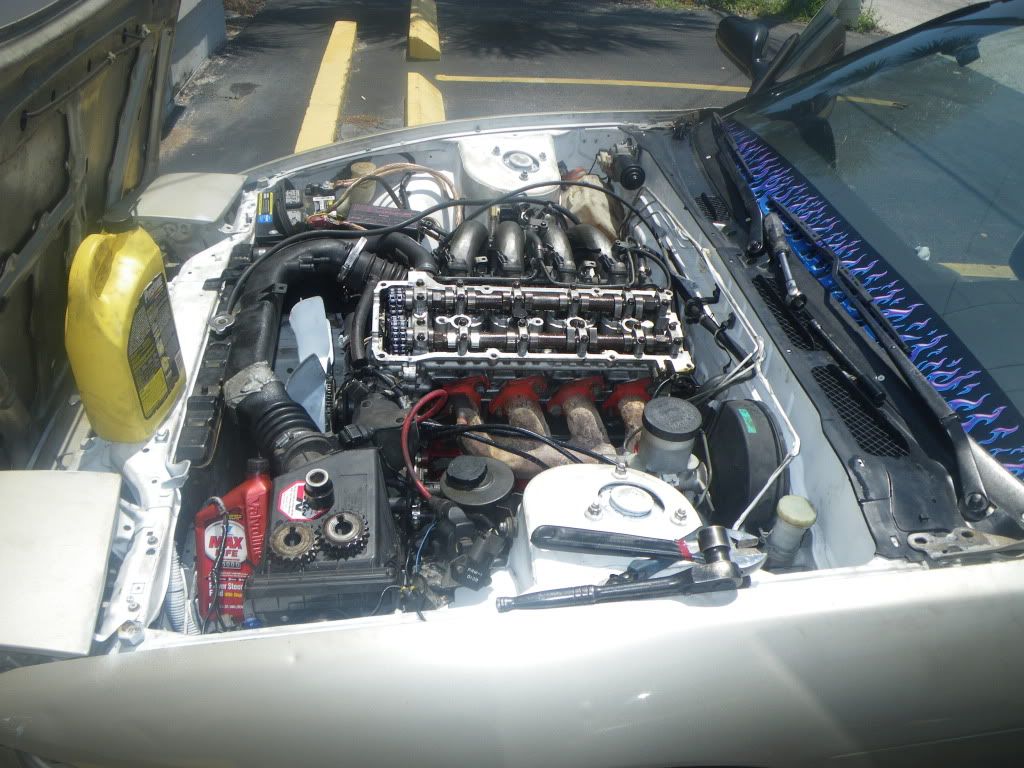

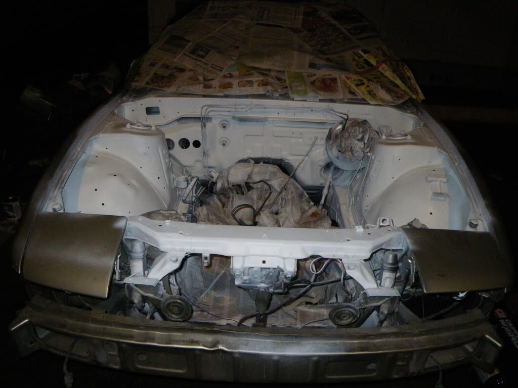

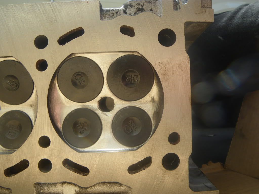

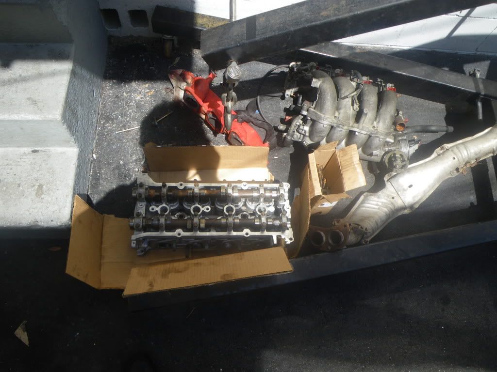

pulled the motor and replaced it with one out of a s14 out of the junkyard.(just tryed to save money and bolt it in and call it done.) Hello blown HG

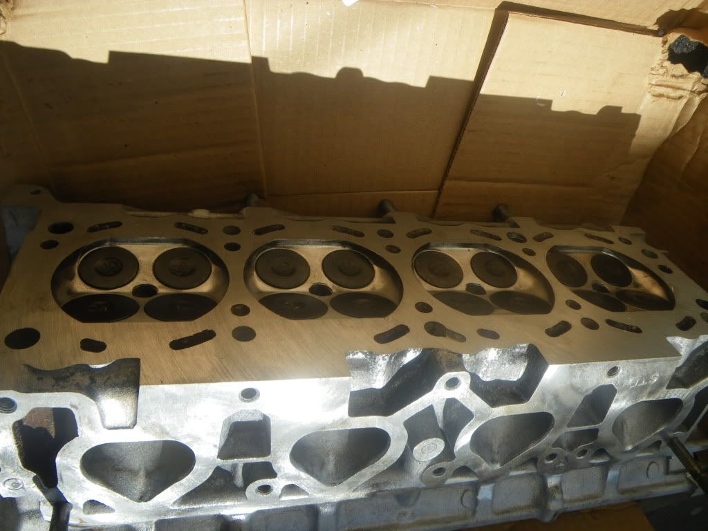

got the head off to find out it had bent valves.
so off to the shop.

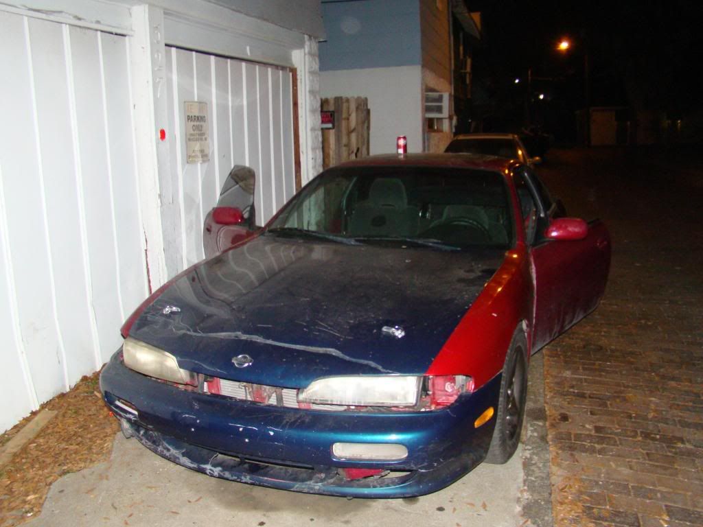

got it back like this
(how they droped it off... asked them to because i was gonna be home like 30 min after they were there.
while waitin on parts i figured i would clean the engine bay up a lil.

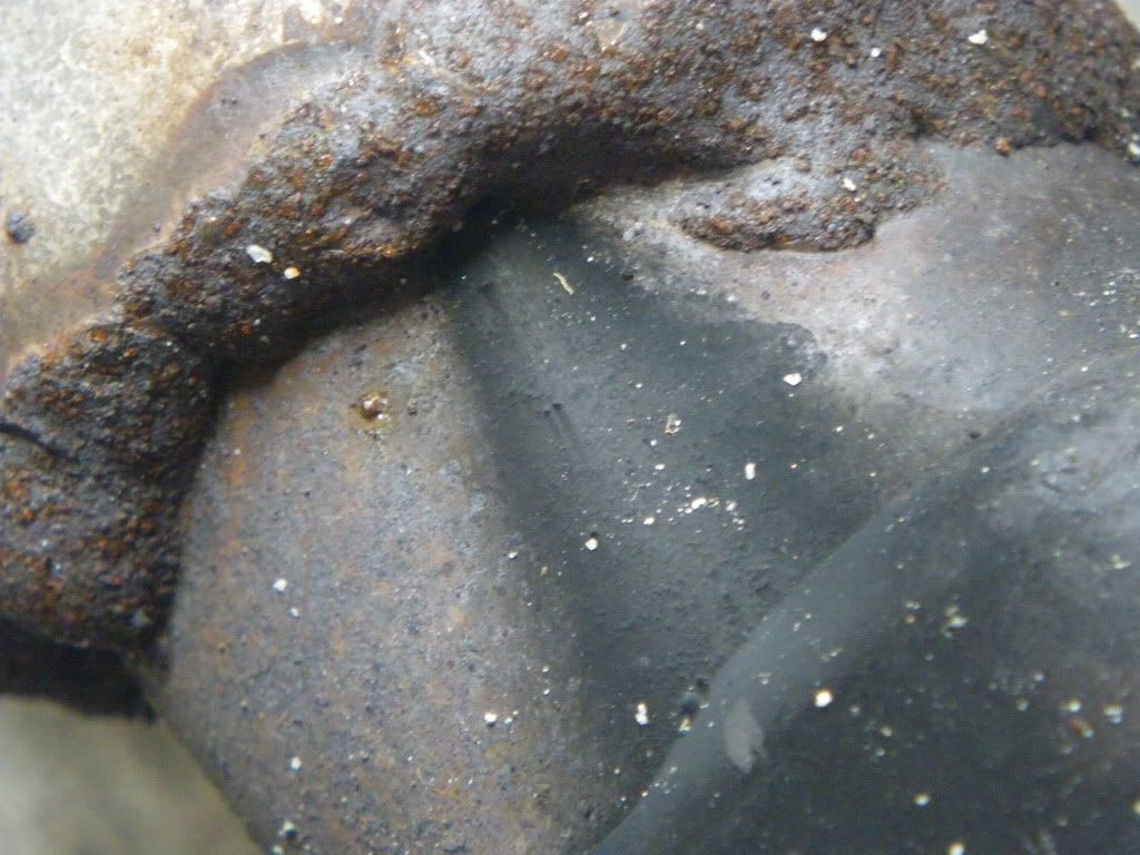

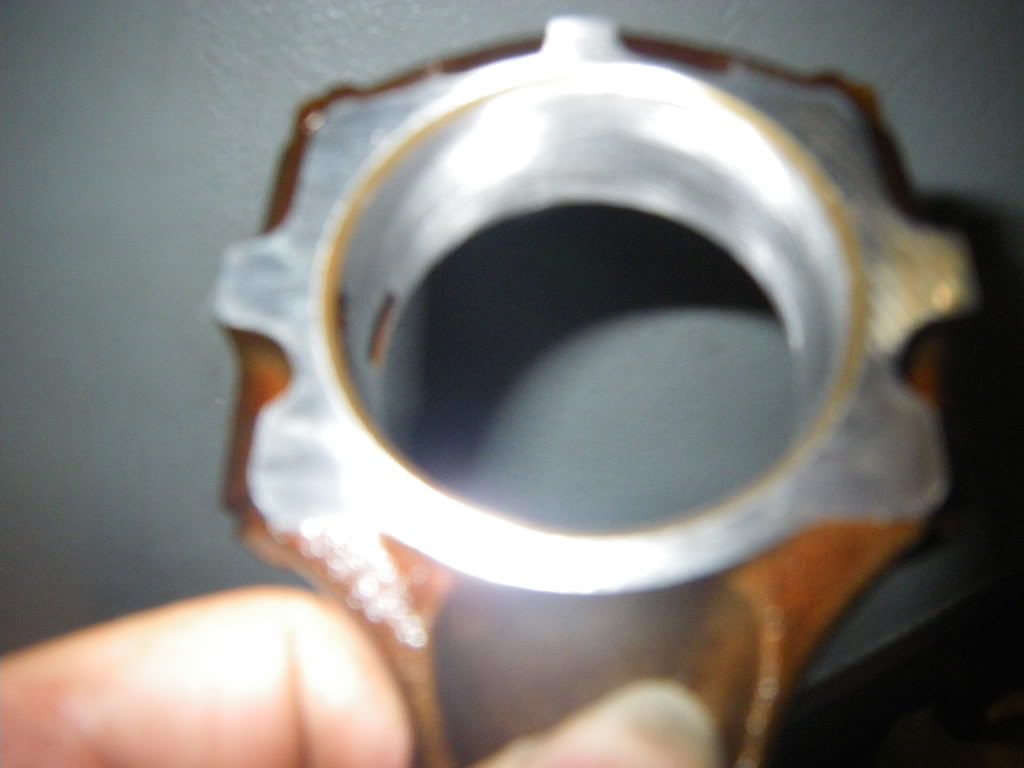

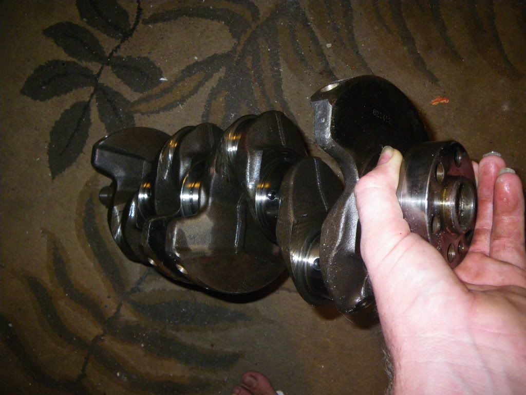

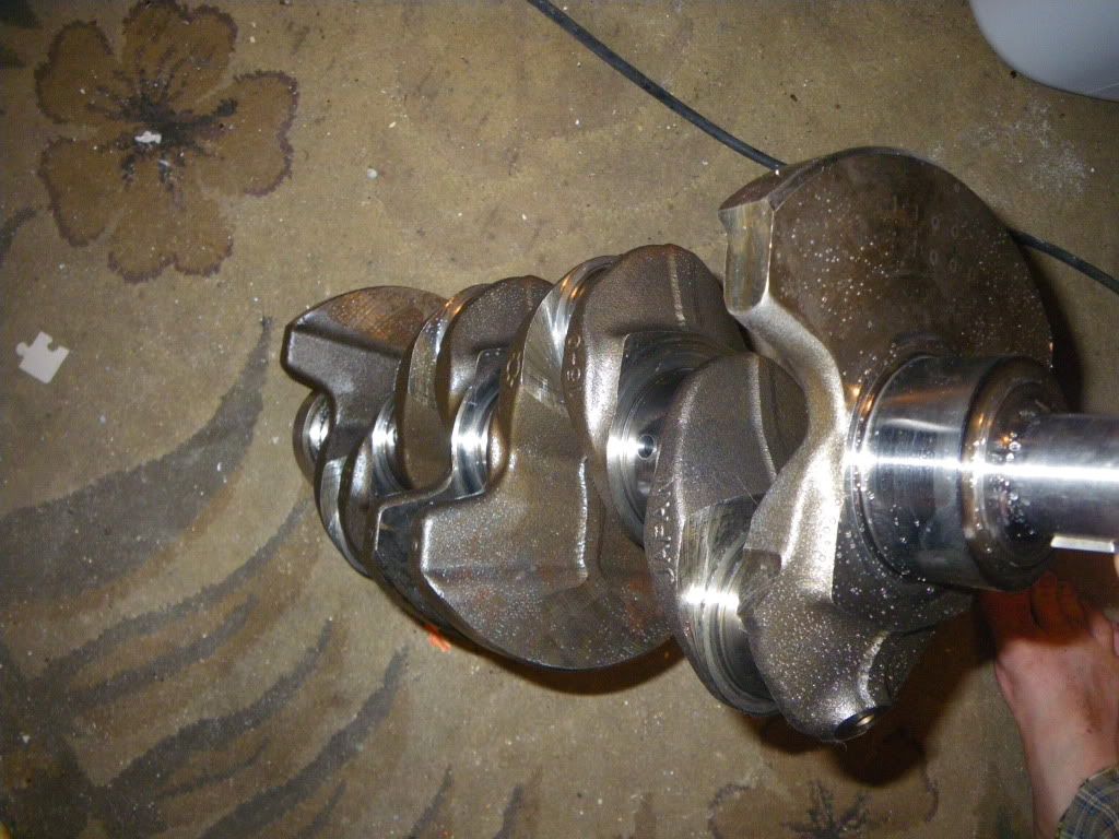

Hello spun rod bearing.(oil squirter broke.)

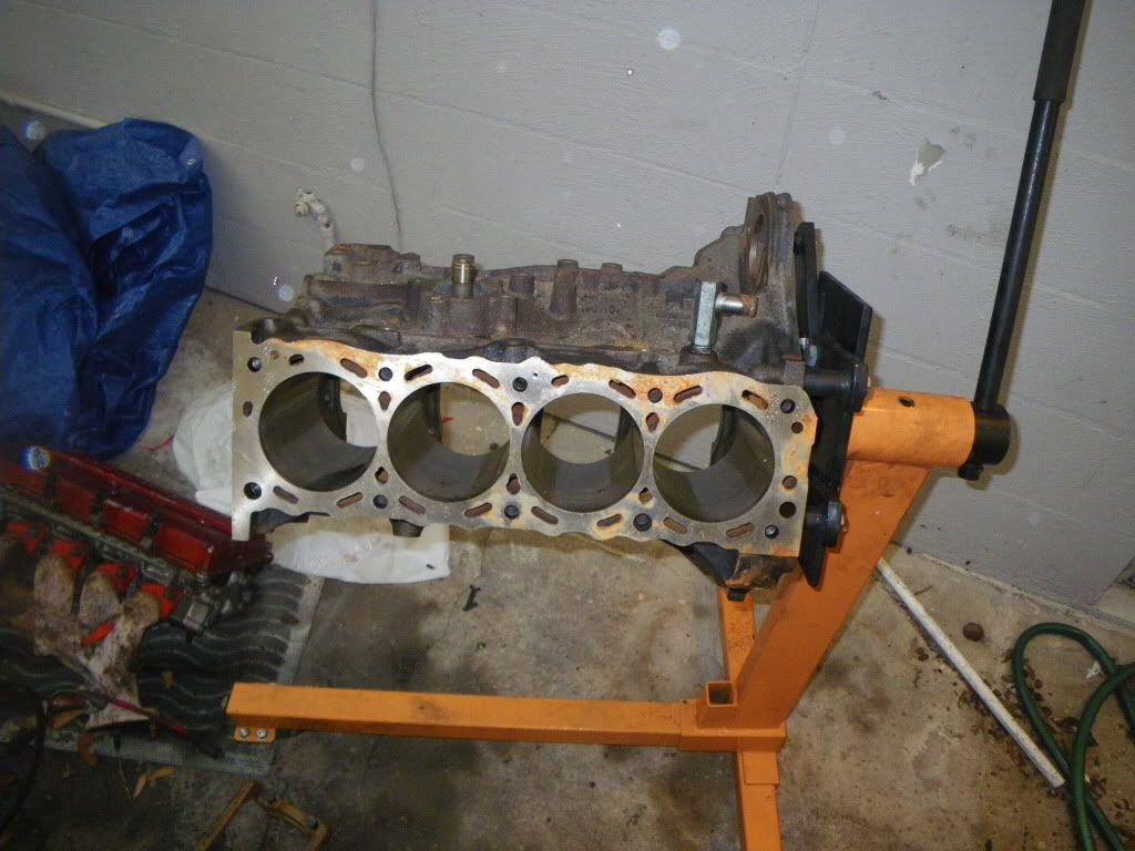

on the teardown i found i had broken timing chain guides. the oil squirter. and a spun rod. got it all machiened cleaned and whatnot.(what ever he said was needed dad was paying and said just make it right...)
just got the block back from the shop.
and atm im at a stand still. gotta get a oil squirter... cant find them around here... that and i gotta wait on my parts for the timing.

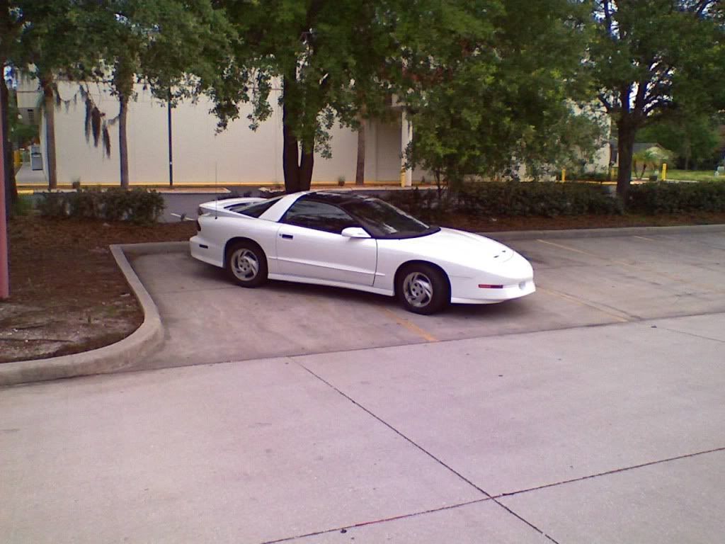

this is my daily. i refuse to bring my trans am were i live(to many kids around here that try to steal shit and its PERFECT! not gonna let a bunch of pussy kids fuck it up.)
