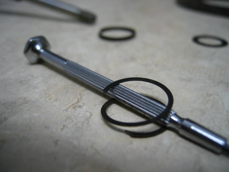

it took me about 2 hours to get a little clip, some people call it a piston ring, its basically a double looped metal o-ring, back in during the reassembly portion. this picture isnt mine, but its what the piece looks like with a screwdriver separating the loops:
it was insane! it acts as a retainer ontop of a washer that sits ontop of a bearing and you have to squeeze it into a little groove that it just doesnt want to go into. I finally popped that sucker in there and rejoiced for a few minutes. i should have the turbo completely rebuilt within the next hour.
