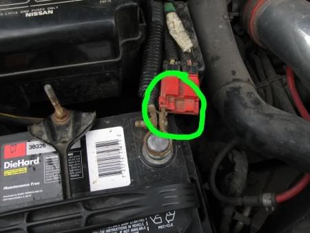

Just wondering how to go about getting the old ones off? Thanks...
Alright so im about to put the new ones on and I notice that...
Part of the connector goes into this red thing, so what is it and does it matter? Thanks...
are you talking about the battery clamp terminals? or the battery hold down clamp? i am pretty confused.
for the battery hold down clamp:
2x 10mm bolts and some twisting should do the trick
terminals clamps:
got the endds off, strip the end of the huge wire and insert new terminals
the red "box" should have a piece of metal coming out of it that the bolt goes through. break the box and peice off the battery clamp(or cut away at the clamp) and bolt the box on the new terminal.
