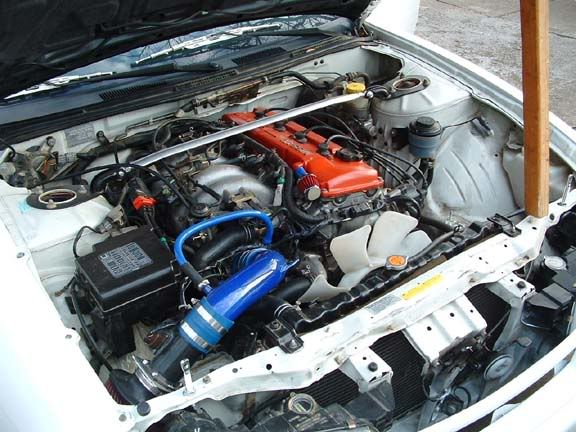

and now some photo...
Procharger C2
possible set ups...
if i do this one then i will do a v-mount with the intercooler and radiator
this might be a little harder to do sence the ka is pushed that far back, but then again the supercharger is no where near and big as that one.
Procharger C2
possible set ups...
