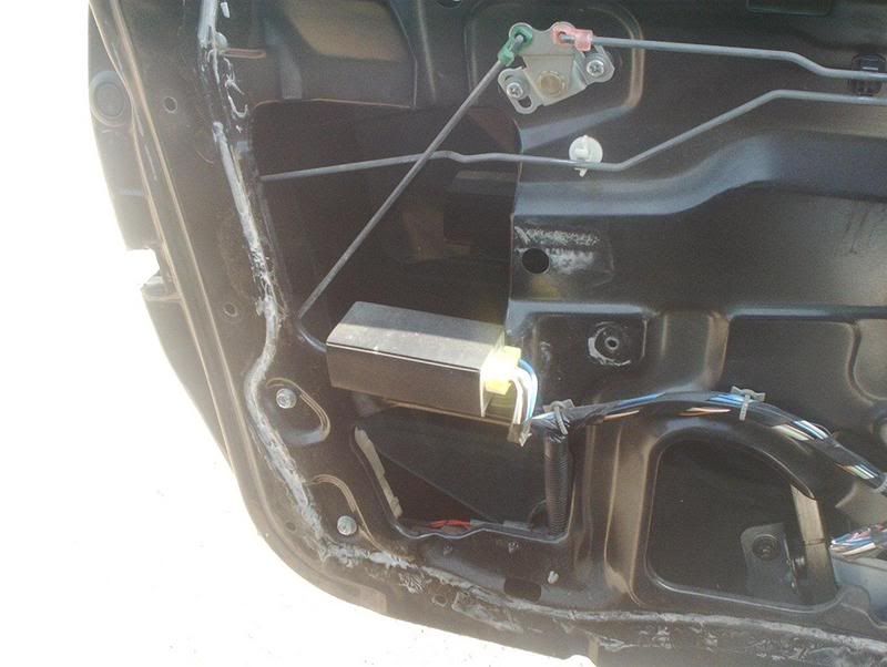

hey, I have the same problem, My window on the driver side wont go down. I took it apart and then i started to hit the button, and i hear clicks from that little box near the end of the door ( Im assuming thats the amp?) anyways I should just replace the amp? is that the case?
