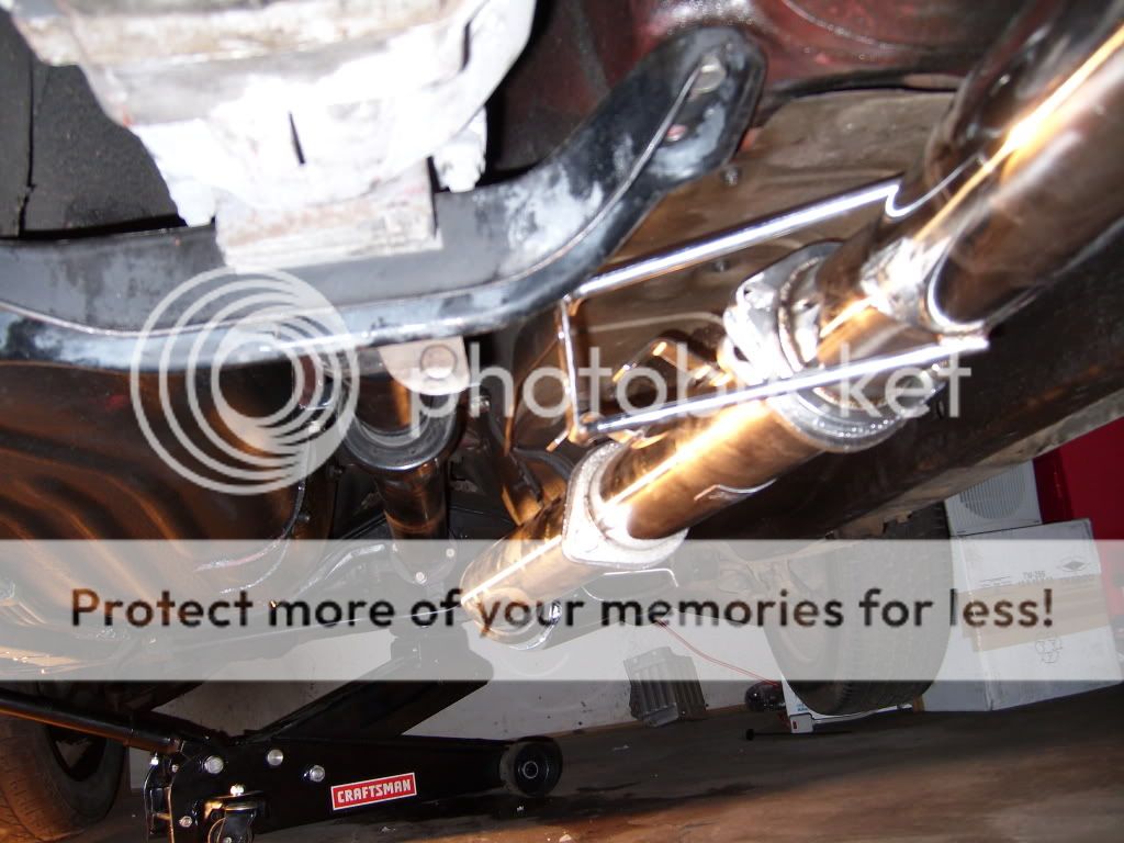

and i got my full 3" exhaust also(from turbo dump-back) good looking welds(not bad for ebay) running a test pipe cause there is no smog inspection downhere. mounting was fairly easy(brought 2 new hangars)
http://i495.photobucket.com/albums/rr317/supersayianjim/project s-rb/layingthepipe.jpg
http://i495.photobucket.com/albums/rr317/supersayianjim/project s-rb/notbadqualityfor2500.jpg
http://i495.photobucket.com/albums/rr317/supersayianjim/project s-rb/yeahitslong.jpg
http://i495.photobucket.com/albums/rr317/supersayianjim/project s-rb/silencerlame.jpg
http://i495.photobucket.com/albums/rr317/supersayianjim/project s-rb/nosilencerbetter.jpg
http://i495.photobucket.com/albums/rr317/supersayianjim/project s-rb/mounted.jpg

after almost 3 days finally ran the pipes(bottom ones) through the car. and reattched bumper done(with that)
http://starcityracing.com/Forums/showthread.php?t=19868&page=3#http://starcityracing.com/Forums/showthread.php?t=19868&page=3#http://starcityracing.com/Forums/showthread.php?t=19868&page=3#http://starcityracing.com/Forums/showthread.php?t=19868&page=3#
iam not sure what kind of grease you use on transmisson parts. all i had was white lithium and i hope thats the one i needed to use.
