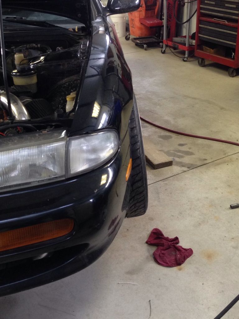

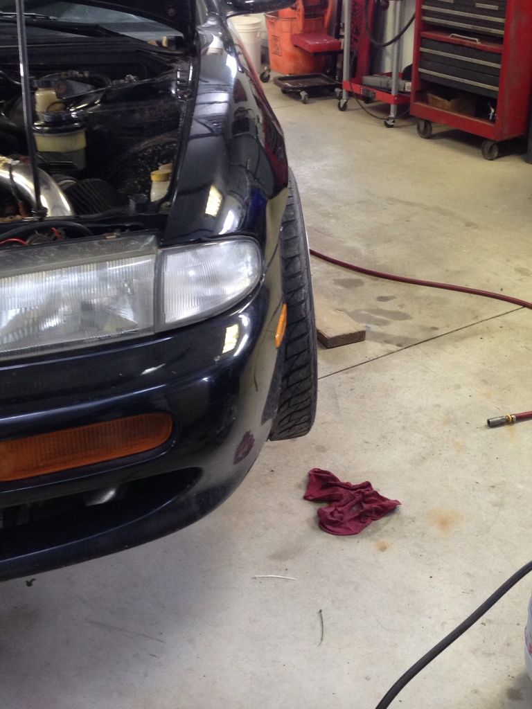

Which lights are you talking about? The one picture from the left, the bulb is just burnt out by the headlight, they do come on with the lights, the two amber lights in the bottom front are turn signals.
Hid cut offs?
Nevermind on the turn signals, I had a moment of cranial rectosis. Yea, you know how regular halogen low beams have a line after a certain point where the light is cut off, putting hids in usually tends to do away with that giving oncoming traffic serious glare. And I would definitely get some camber adjustment before a new set of tires.
Oh ok yeah I get ya now.
Yessir, already adjusted the front, they were pushed in as car as they could go (max camber) and I pulled it out as far as the current bolt holes will allow but they're still in a few degrees so I'm going to use the bolt holes further out. I'll post new pics when I get her al set up..
Is there any way to adjust rear camber?
Yeah this kid was basically just trying to be "cool", meanwhile his brand new tires had gone to shit.
Thanks I'll check that out in the back, I definitely want to get the camber straightened back out before I put new rubber on her.

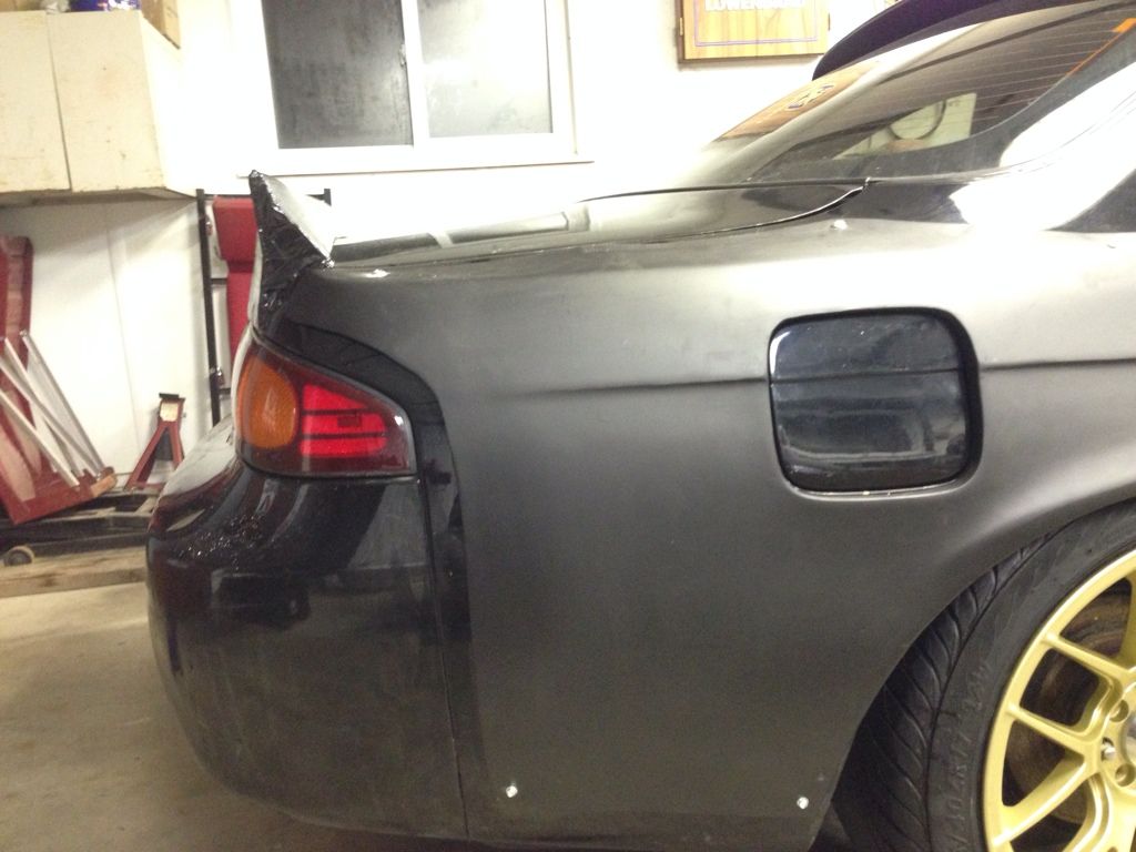

30mm rear overfenders

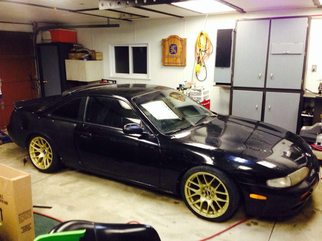

Just adjusted the coilovers to a mad Jdm drift stance.
...Well it looks better to me anyways hahah

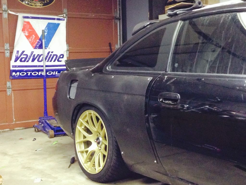

Quarters mocked up
They're duraflex so they aren't the greatest... Especially the gas door filler panel...
I plan to mold the panels on though so everything will be fixed

Adjusted coils
This is how they were when I started with it, now the collars are all sorta stacked up at the base and I turned the centres down

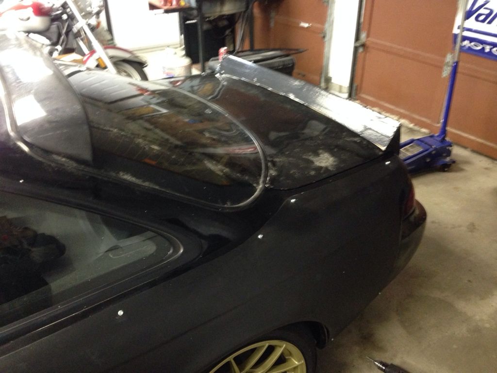

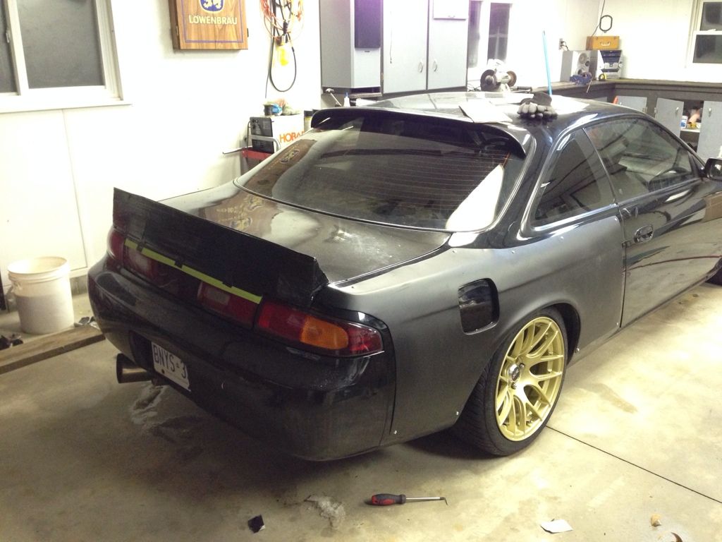

Screwed the quarters on today for a more accurate kinda idea of how they'll look.

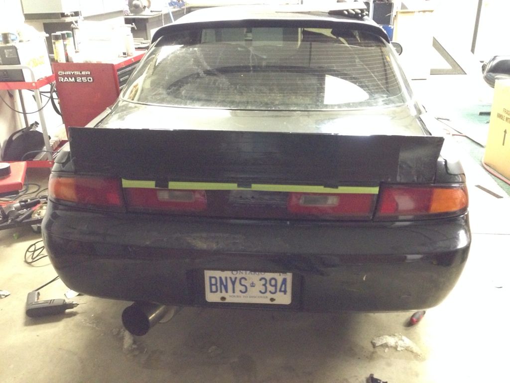

Also just messed around with some cardboard and duct tape lol
This isn't the final product obviously, if I end up going through with it it will be molded in glass.
Didn't really have any dimensions to go off if so this was just winging it basically, looks awkward from the back though , might be too tall but like I said just messing around here
I like it, I just try not to comment on build threads unless I have a question or have something intelligent to say. what kind of overs are those? you get fronts too? what kind of screws are those and how secure are they with screws?
Yea I noticed that too, not much activity here
The overs are duraflex (extreme dimensions) they're 30mm and not the greatest fit or quality, but they were only $199 for the set (+shipping and import fees for me though)
They will be molded on when I bring her into work, I only have about 10 screw is I. Each side right now, like I said just seeing how they'll look and rough idea of how they'll look. They're actually pretty sturdy once mounted on the car, off the car they are rather thin and feel fragile almost.
I don't have any plans for fronts yet as I would like to go to a kouki front clip in the future so it will stay stock with the exception of a GReddy lip I have on order aswell.

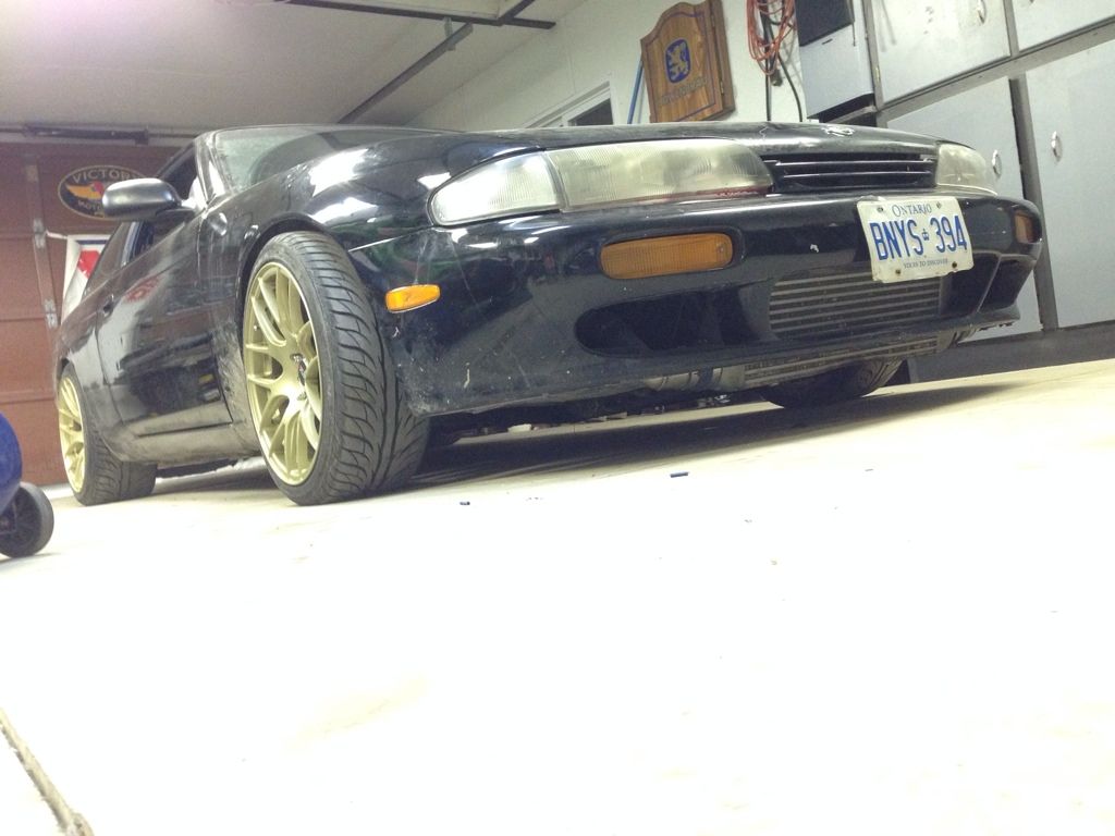

This is a really noob question I know, but my intercooler hangs a few inches below the front bumper causing it to apparently take a beating, right in the centre it is pushed up quite a bit and the bottom few rows of fins are damaged and all folded over, obviously this isn't optimal for performance, but will this affect it so much to start overheating or anything I should worry bout?
Kinda hard to see but here:

Yeah I need one of those fancy low pro jacks they sell at princess auto, currently even if I drive up on a couple 2x4's stepped, I still can't fit it under
