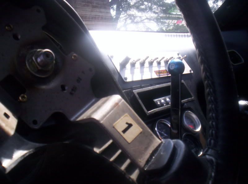

i rewired my whole chasis harness. I run everything off a single switch board with 7 switches.
switches are
1 start
2 ign
3 fans
4 headlights highbeam and low beam
5 turn signals
6 acc
7 tail lights and brake lights (smart to shut them off for late night drifting in parking lots with cameras)
Only do this if you are a complete baller and have lots of time on your hands if its your first time.
I can do one in a weekend if i want to now.
Get diagrams, get red bull, and dont give up.
and if you have more specific questions post em up, i probably have an answer.

a switch board would def. be ultra ballin! but that will take a bunch of work. i know i can do it since i can read wiring diagrams pretty well. but i dont need such a complicated set-up. i'll probably think about this in the future. thanks man. do you happen to have pictures of your board? hook it up mang ^^.
yeah its just a painless board hang on a sec i will find it, the car is very similar to the way it looks in the picture the way it sits now.

hey japside4life, do you happen to have a wiring diagram for your rig? im curious on how you did it. although, i probably wont be doing it, im interested on how you went about doing it.
well i didnt really make a wiring diagram i might draw one up in paint or somting for the switch board and relays with battery and cut off. Here is what i basically did
Battery(alternator power goes directly to battery post, and of course a hot wire going to your starter for the battery terminal).
Run a hot wire from the battery post now to a battery cut off switch, now the next part you can do a couple diffrent ways, best and cleanest way I would recomend is run a heavy gauge wire from the battery switch to your fuse box and relays to power them up, just splice your individual wires into the heavy gauge wire.
As for your relay grounds, i made multiple different grounding locations just to make the grounding circuit better, some relays like your fuel pump actually ground to the ecu so remember to have a fsm with diagrams just to double check your work.
Ok now you have power going to your relays and switch panel i will give you a quick run down of how i set my car up now (of course other peoples needs for thier cars may be different, my car is pretty much just a track car, but it does see the occasional late night street drift or it is taken out to play on the weekends).
Switch #1-This is your starter button, a starter button can be found at autozone, you just need 12v B+ power ran to it, then when the switch is activated 12v goes to two wires that you need to add to the switch, with this switch you are powering up the starter solenoid wire, and the start signal for the ecu (i think its the orange wire in the white connecter that goes to the ecu its been a while since i did my rewiring so that color may or may not be correct).
Switch #2 (ign switch) This is just an on/off toggle switch i used a pretty heavy duty switch and wire for this ign switch because i power up two relays with it, my ign switch powers up the ecu relay, and the fuel pump relay, refer to your fsm on what wires to give power to get your ecu to turn on as well as your fuel pump. I believe the s13 sr20det i used the black/white wire for ign power, there is an ecu back up power wire also i think its red, this also needs to be wired in (eventhough its "back up power" the car will not start with out this wired up).
Switch #3 Electric fans--- i just used an on/off toggle again and a relay to activate the fans, yeah they run all the time, no its not a problem. Yes you could wire them to a temp control also, i didnt do this because a temp control is just one more thing to fail to cause your engine to go..... Also my car gets the shit kick out of it everytime i drive it so it never gets "too cool".
Switch#4 turn signals---yeah im crazy turn signals on a switch panel---- Use an on/off/on toggle switch for this and use the factory flasher relay it will make your life much easier. Just copy the diagram from the fsm and you will be golden.
Switch#5-- headlights---highbeam and lowbeam--- yeah you guessed it, once again use a 3 way toggle switch for this also on/off/on. You will also need a Diode (for the brain dead its a one way electrical check valve which means current will only flow one way). This allows the highbeam and low beam. i have it set up when i turn my switch to high beams current flows through the wire connected to the high beam contact of the switch to the high beams, then it flows through the diode (which is connected to both the high beam and low beam contacts of the switch) to activate the low beams. This means you have uber awesomer night vision. Once again run the wires like stock its not hard, if you have headlight motors they can be made to work kind of a pita, i have a silvia front end though so im a slacker, err i mean i rock.
switch#6 taillights and brake lights---w00t its awesome to be able to shut them off seperate from the headlights for mad t1ght n1ght1m3 jdm dorifto. Ok power goes through the switch, then run two wires from the switch, one to your brake on/off switch and run one to your tail light power wire= finished product super awesomer.
switch #7 Acc- i run gauges off this its cool, your gauges come with wiring diagrams sweet!
Switch #8 I dont have anything hooked up to my 8th switch lol, but you may choose the option for wipers or even do a 9th switch and have wipers and your blower motor.
Anti theft for your car, you could go about this a few ways, get one of those nifty keys and cylinders from jegs, you could get a removable steering wheel, you could pull a fuse that you have hidden. The possibilities are endless to keep the ninjas from stealing your stuff.
-i know reading this can be hard to understand, especially with me behind the keyboard, if anyone has questions post away and i will try to explain them better.
