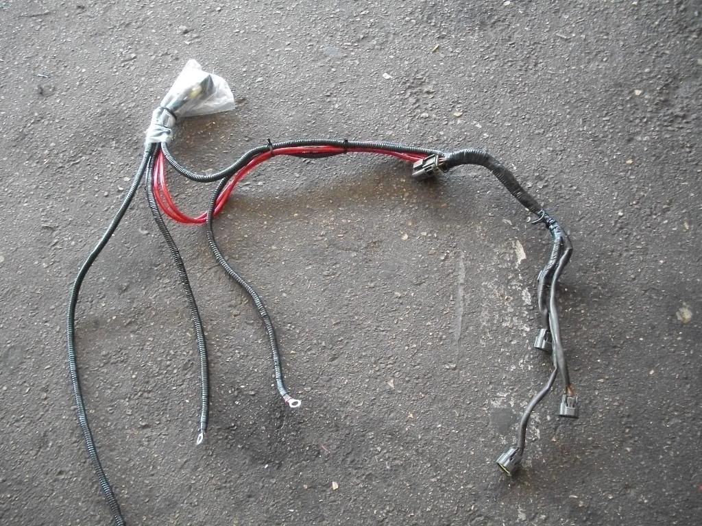

ok...im no one special..
but ive got an awesome idea...
dual trigger
ignition
current
upgrade.....
yashio factory offers a similar idea....
YASHIO Factory HomePage
it sells for 203.00
my idea is way cheaper
and i can almost insure a 1-2v increase on coilpack power
and its a plug and play affair....
custom ignition harness upgrades available now...
as far as to order...non avail...
pm me if anyones interested....
by the way i did this on my ka once upon a time
and i shot fire out the exhaust due to such a hot spark
these r the pics of the harness..i used 8g amp wire and soldered and double wrapped with tape and loom
:beer2:
MOST 40 AMP RELAY R THE SAME THESE R THE PINS TO WIRE UP FOR COILPACK REWIRE
PIN 87 12V
PIN 86 GROUND
PIN 85 COILPACK TRIGGER OR SWITCHED IGNITION
PIN 30 OUTPUT TO COILPACKS
