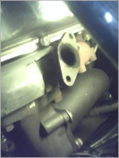

hey guys im having problems with my wastegate not regulating the boost and im wondering if it is the way i have my wastegate set up.
im thinking that it is not getting enough exhaust flow to actually open the wastegate. This is the only thing i can think off why my wastegate wont regulate. i have quadriple check all my vacuum lines and made sure that it is hooked up correctly. unless there is a special thing you have to do on the rb25 or something.
where did you guys mount the external wastegate on the stock manifold? pics would be helpful. Thanks

its a tial wastegate..well i had it like around the 5th port, i am going to move it where everything meets. and it is hooked up right. vacuum at the side of the wastegate and the top is vent.

hey post a pic of that if ya can, im gonna be doin it very soon too. do u think the wg position was the problem because i was gonna weld mine in the same place.
Z
Yeah I got the same turbo setup and don't really have the $$ for a new manifold that has a pre welded w/g flange so yeah I'd like to see how and where to mount the w/g.
· Registered
120 Posts
it can either run back into the downpipe further down like 18inches from the turbo. or you can just have it vent into the atmosphere which is loud which i like. if u didnt run a pipe the exhaust gases and flame would burn and melt everything, plus make it all sooty...
