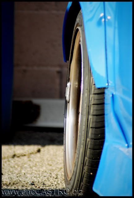

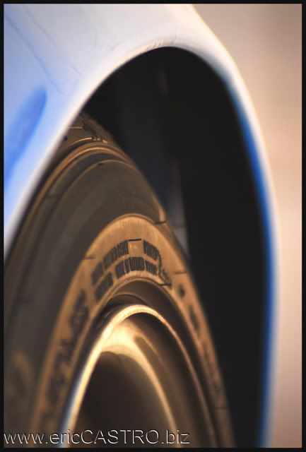

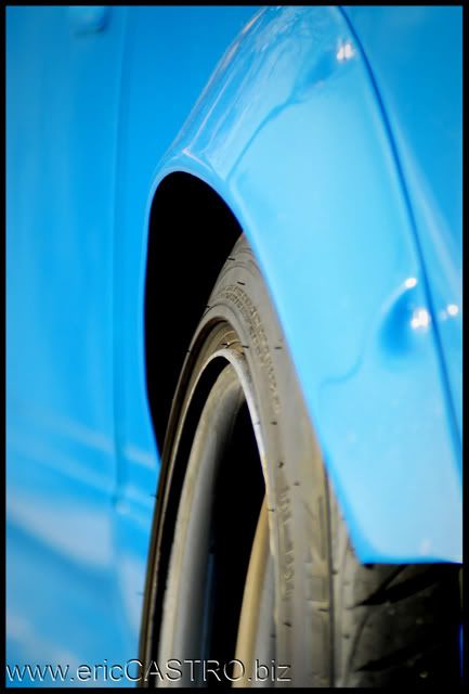

REARS 205, 50's on 15x8 negative offset
^someone said " if you have 205 stretched tires, it looks so gay cuz the tire from the back looks so small and tiny." IMO, 240sx is a small car.
FRONTS 195,50 on 15x8 negative offset
AND BOTH TOGETHER
