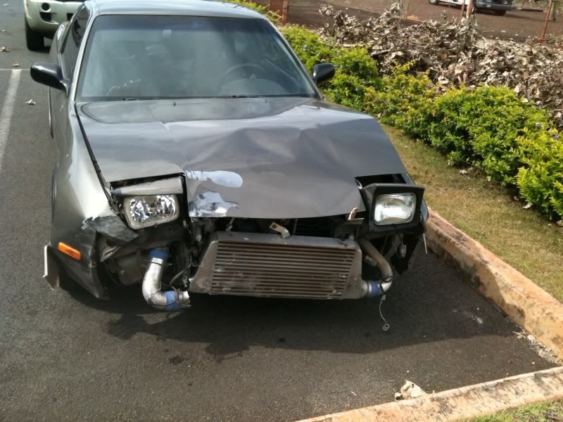

So I crashed my car last week tuesday and was looking for another shell. I found a Zenki s14. And I was just wondering if everything will match up and bolt up? I.E. sr20det motor I have in the s13, the trans etc, etc.

I got some back pains....Some douche ran me off the road(he was coming head on towards me) so i avoided him and he ran -_-.

and ouch, that doesnt look too good
ouch, damn that sucks bro. hope your insurance covers everything. i hate people that drive all stupid for no reason. GL with everything bro...
Thanks guys.....unfortunately I didn't have full coverage -_-. And if I did that car would have been totaled. For the harness did you mean the ecu harness?
