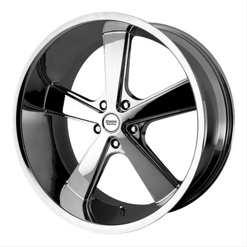

I got the third wheel painted, but it started to sprinkle so I didn't dip it. I did however test fit some 22"s. My roommate was jealous of how flush they were with no spacers or anything. They're going on the ranger after they get cleaned up and the lips painted black.
