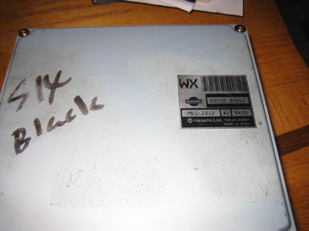

He could have swapped the covers, that happend to me before. The freshalloy forums ahd someone with the same ecu as you and they got their front clip from australia. Thats all i know
E5 is from a 94-96 180sx black top 5 speed
E6 is from a 94-96 180sx blacktop automatic
WC is from a 94-98 S14 Silvia
62 is from a 91-93 180sx or S13 Silvia 5 speed
61,63 is from a 91-93 180sx or S13 Silvia automatic
J4 is from a 97-98 180sx Type X 5speed

i think i found my answer, it also could be an rb20/25 det ecu
i found several on ebay that have the same 1st serial numbers 23710

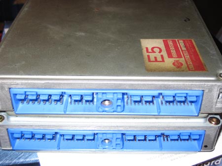

What ecu is this
I just wanted to know if any knew what ecu that has a number 72? I took it of my freinds ka24e and I didn't think it came with the car originally.
1,915 Posts
^not the same.
Different years have different pins in different locations.
Take the two different 180 ECU's. RPM pins are right next to each other but not in same place.
One is second from left and the other is third from left in same sect.
Thats a big difference when your splicing stuff together.

its a vvt ecu, probably a kouki or even an s15. the zenki ecu is WE and the rb25 is a TJ
