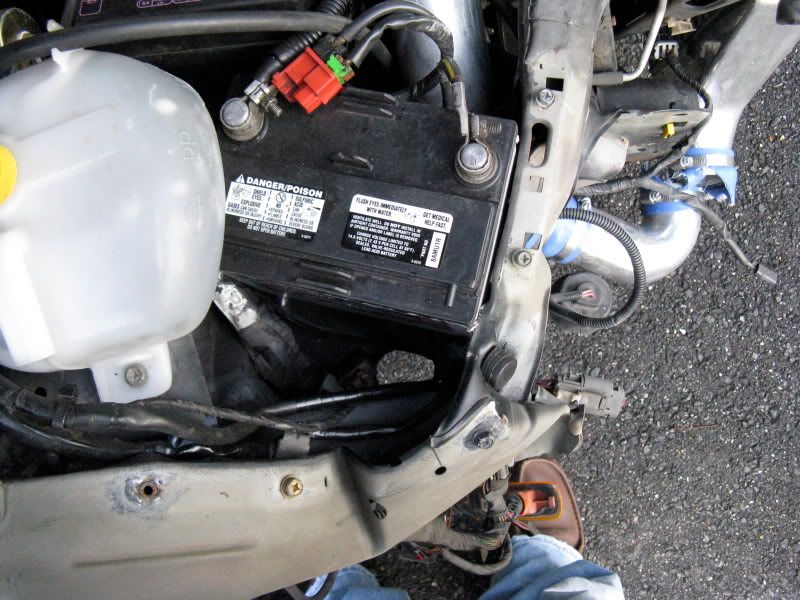

After getting my car out of the county tow yard I was able to strip the bumpers down and see how much real damage there was. I'm deciding on what to do now.

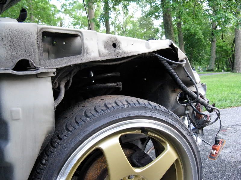

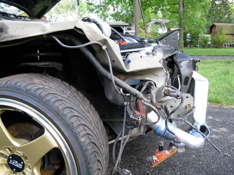

Something is still bent, look at how far back your tire sits in your wheel well and your strut is almost behind its center line, when it should be just ahead. I would bet you pulled the whole area where the tension rod mounts backward when the wheel got pulled backward. Start comparing everything to the other side, it should be mirror images.
#33 ·
I have compared it to the other side and I honestly can't see a difference. I was thinking the same exact thing about how the part where the tension rod mounts to the frame being pushed back, but it looks like it lines up at the bottom. The top part of the frame is the only part that go bent.
Could my car be so NOT aligned that the wheel would sit like that due to horrible caster??
#35 ·
Alright after farther examination I realized I actually do have some bent parts.
Tension Rod Bracket, Tension Rod, and Transverse link assembly (LCA) (other piece tension rod connects too)
I'm going to check the junkyard for some pricing on these parts, but as for now she still just sits.

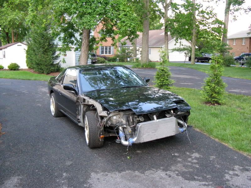

#51 ·
My parts came in the other day and I went out and did work right away. Everything went in pretty nicely except on hole for the bolts on the Nismo Power Brace was stripped. I'm going to re-thread the hole sometime soon. Also after fitting everything back into place and aligning it to a point where I could drive I went to bleed the brakes and stripped the shit out of the bleeder bolt. I have tried liquid wrench, pb plaster, and vice grips but nothing seems to work. Looks like z32 are coming sooner than expected. :thumbsup
