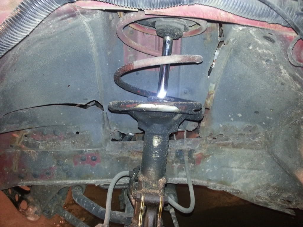

Got her home and found this.
I was more pissed at myself for not seeing it beforehand. Excitement got the best of me after looking for a car for over 5 years. Traveling south to get a super clean car was not really an option. I am/was prepared to deal with rust, just never thought I’d see this.

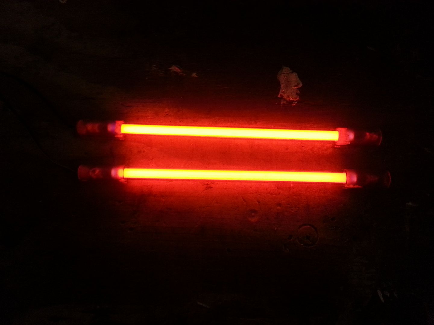

After talking with a local forum member about everything he did with his 93, I figured it would be best to pull the interior to check for any more serious rust issues. I found some very… interesting, yet scary wiring for the radio.
Rats nest from hell, and found some fancy neon tubes that strobe to bass. HAH! Dumb…

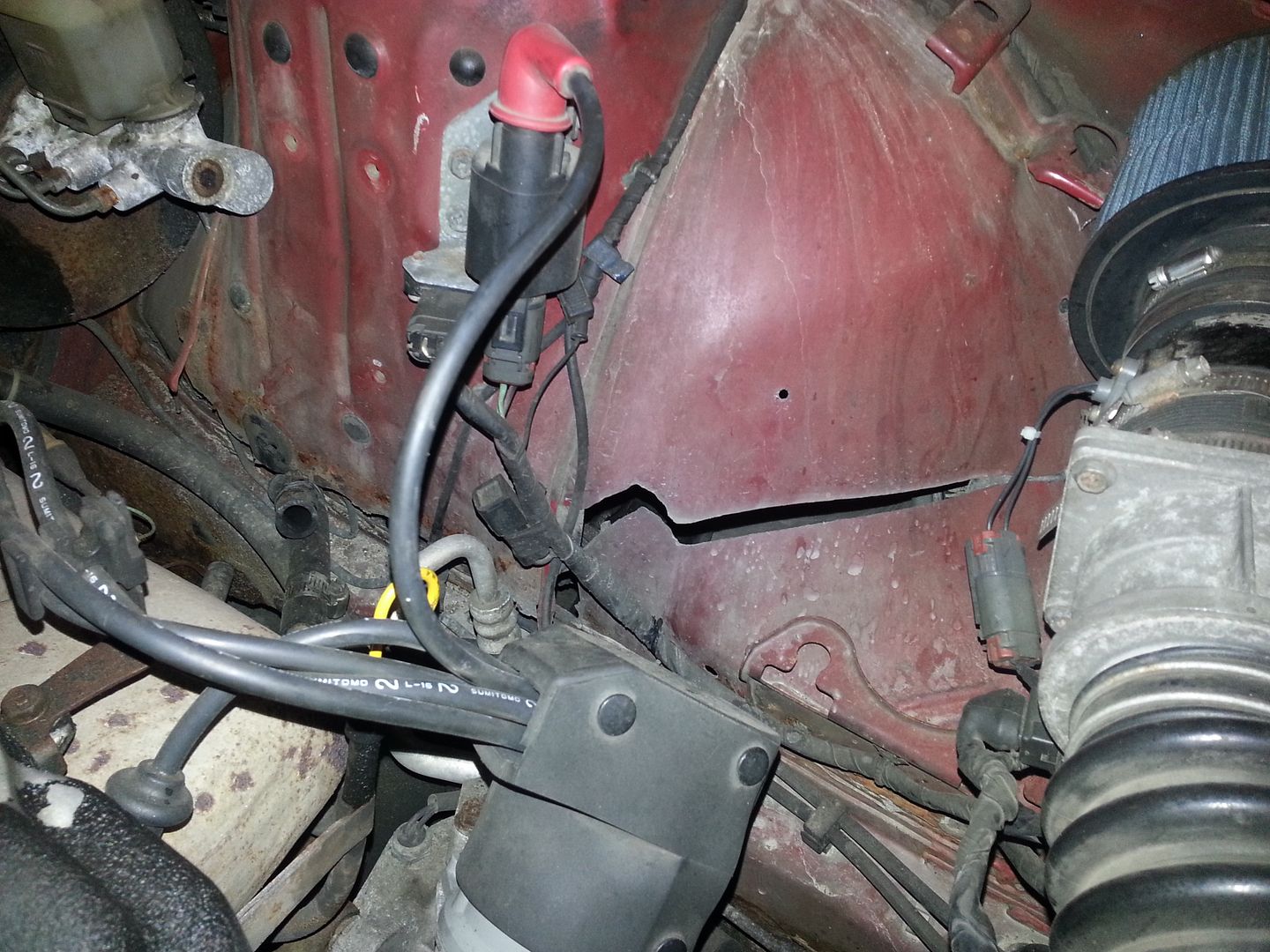

Everything looks really good considering it’s a 22 year old car. Only problem spot is right below the seat mounts on the transmission tunnel.

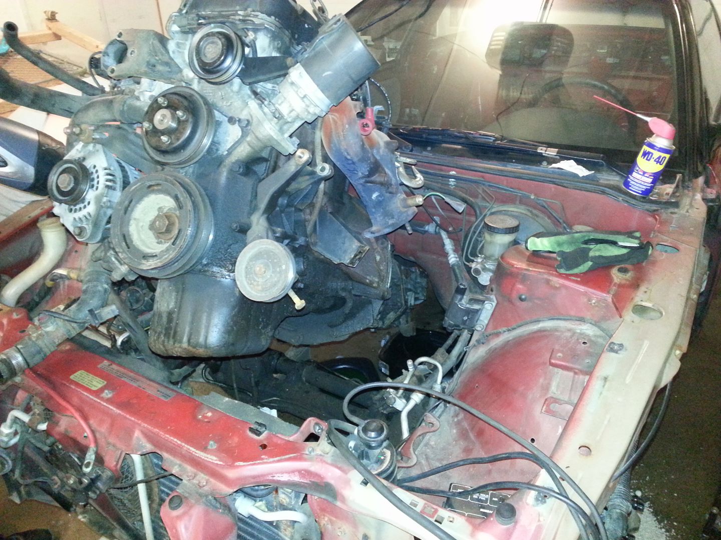

Since the interior checked out, relatively ok, I figured it’s time to get to the engine and transmission. 2 piece driveshaft is ANNOYING. The bolts on the rear for the pinion suck! No ratchets, no impact, just wrenches. Carrier bearing zips right off with the cordless impact. Ready to pull them out!
Shifter was removed when we pulled it. Just trying to keep things organized, stuck it back on there.
You can see my rusty rail on the driver’s side, and where the tower split.

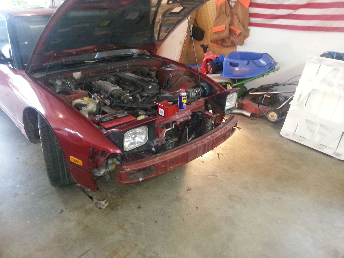

This is where she sits after last weekend.

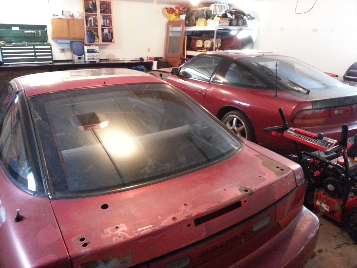

Picked this piggy up about an hour from home today. Runs and drives for $450. Rusty though. Parts car! No exhaust from the header back, so my neighbors probably hate me right now. Oh well.
