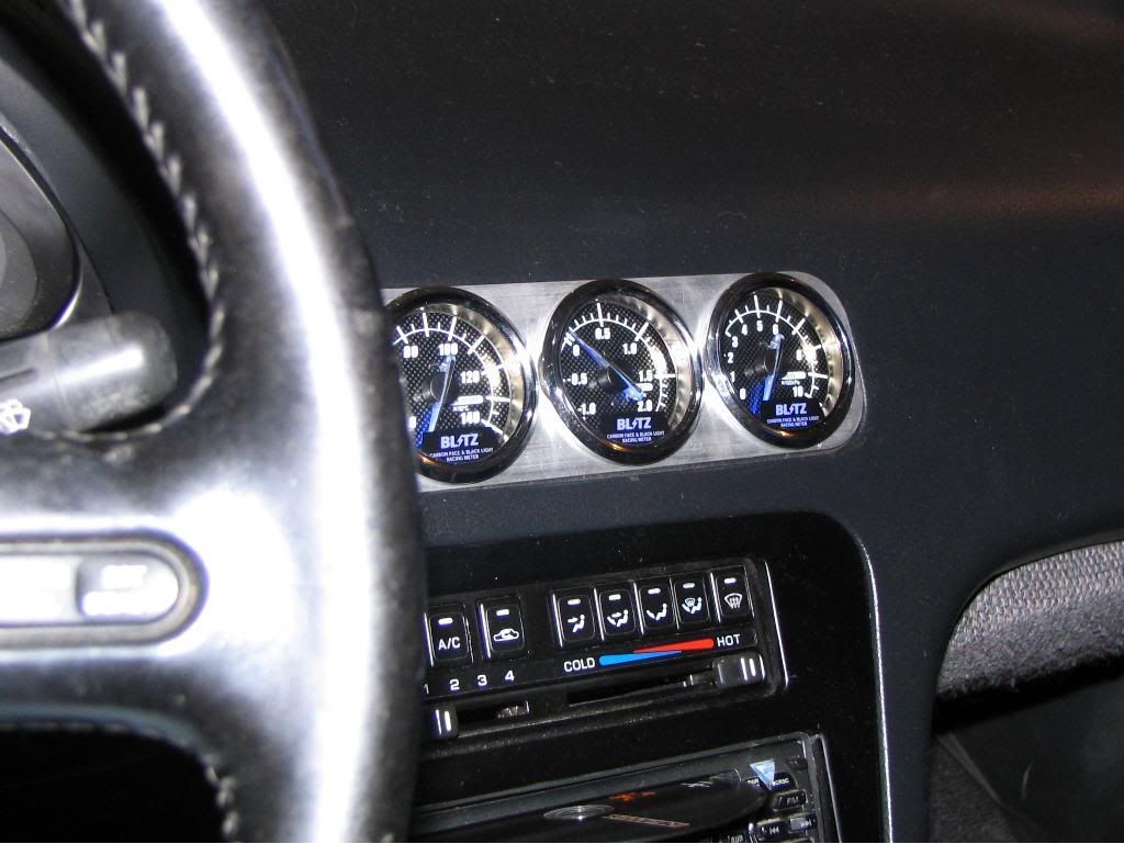

I got a few PM's asking how I got my Blitz gauges to sit flush in my dash so here's a few pics to help you guys out.

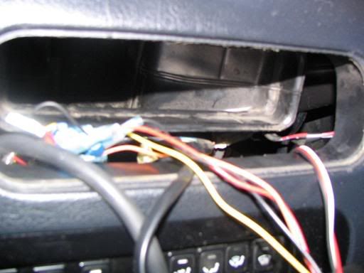

After you pull the vents themselves, it should look something like this:
Note the lip on the bottom of the inside of where the vents were. That lip is going to keep the gauges from sitting flush, because they're round (duh) and sit on that.

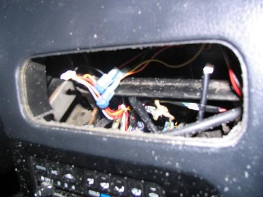

So all I did was take a dremel tool and cut off this inner lip like this:
Now they should sit flush and wont slide around thru corners. Final product should sit like this:
Hope that helps you guys out.
