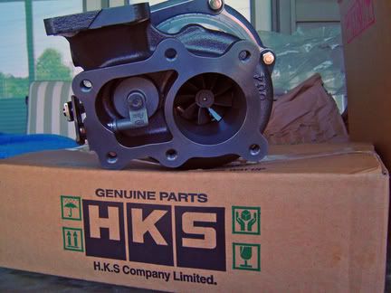

Just got this shit... Apexi PFC, Apexi PFC boost controller, Nismo 555cc injectors, and the very lovely HKS GT-RS turbine kit.... can't wait to install and get tuned!

Damn you've got some good stuff coming... Let us know how that EMS goes for you
hahahaha.
was about to say that it looks like someone went crazy on nengun.
good deal man, let us know what happens.

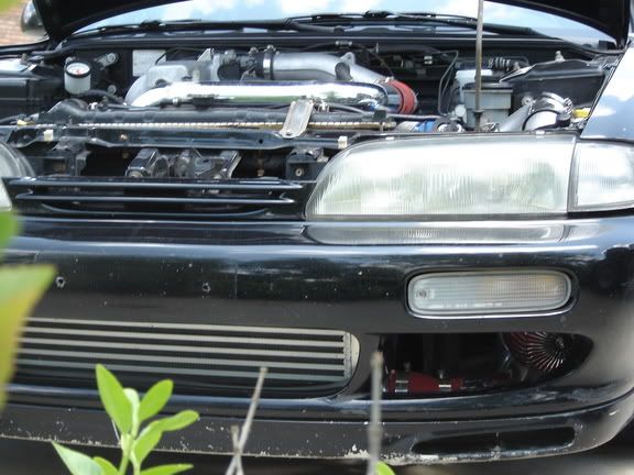

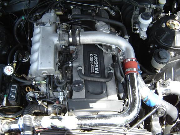

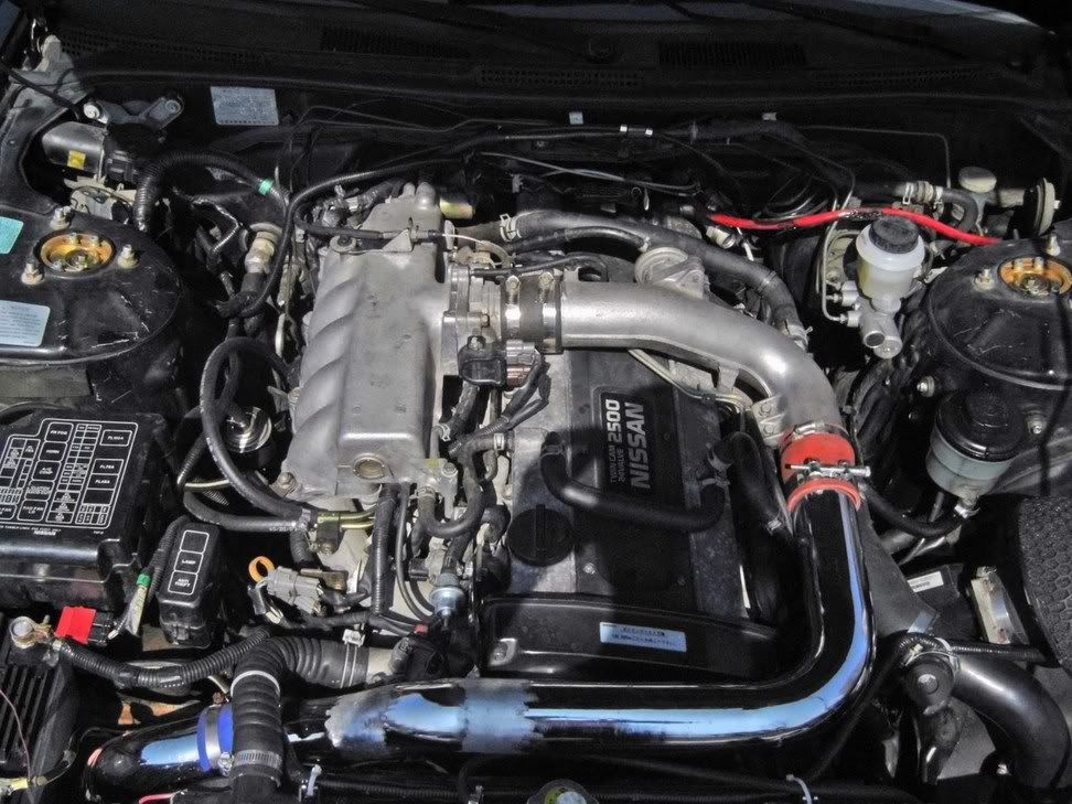

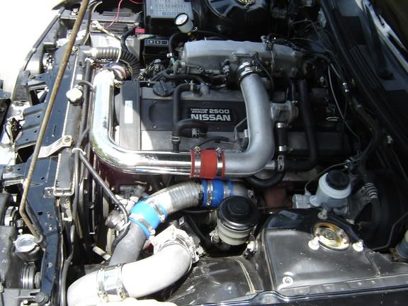

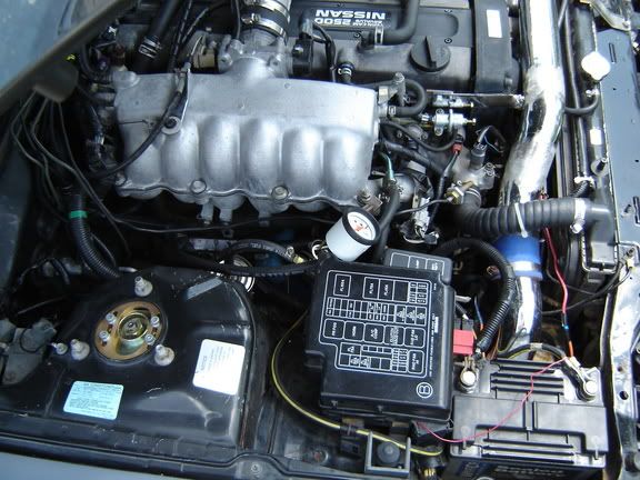

These are pictures I took right after it was finished... since then I've cleaned up the engine bay with some degreaser and a pressure washer... cleaned up some of the clutterness.... and made a 3" cold air intake, replaced the rubber hose inbetween the hotpipe and compressor, removed the front license plate holder, cut out the platic in the front air dam, and removed the pinstripe, installed a F.P. gauge in the fuel line....
Could you guys suggest some ideas on cleaning up my engine bay... I really want it to look less cluttered and clean it up some more... i have no idea where to start.. but like i said earlier these are old pictures and i'll post the new ones up tomorrow
I'll take more pictures when I'm replacing the turbo and everything else... hope you guys like....
What kind of fuel regulator are you running? Also, is that fuel pressure gauge I saw in there? Looks great, also noticed the z32 brake upgrade
Nismo FPR.. and yessir that is an Autometer mechanical F.P. gauge... i need to shorten up my fuel lines and mount that FP gauge to a fixed position.
The brakes are from my clip... i still have yet to upgrade the rears... I heard it's a bitch of a job... but thanks for the compliments i really do appreciate them!

Nice choice on parts. I'm sure that thing will haul some serious ass once installed and tuned. How much boost are you going to run? Do you have an aftermarket headgasket or at least a new one yet?

I don't think so... in order to do that i'd have to tune each injector individually... i don't know if the PFC can do that
Sure you can. When you look in the settings you can set the percentage to each injector. When you tune your fuel map, just tune as you would normally with added percentage in the leaner cylinders. It's not the most precise way to do it, but with those mods I wouldn't worry too much about it.

JDMking: i'm using Mckinney mount kit
OpeLok: thanks for the compliments! After the install that is the very next step... I've gotta find a tuner!! No i don't have a new head gasket... I discussed with jonpowell that the 555cc injectors are good to about 360hp at 80% (safely not maximum) and the stock head gasket will most definately hold that kind of power... but if it happens to pop... just shut it down immediately and replace.
HKS states that this turbo will produce 400ps at 88.3kpa which all converts to 394HP at 12.8psi ... I will probably have it set at 12psi all day long but we'll see when it's finally tuned.
Nismo241: thanx for the insight... it's always good to learn new things about the PFC.. but I'm definately not gonna be the one tuning it
