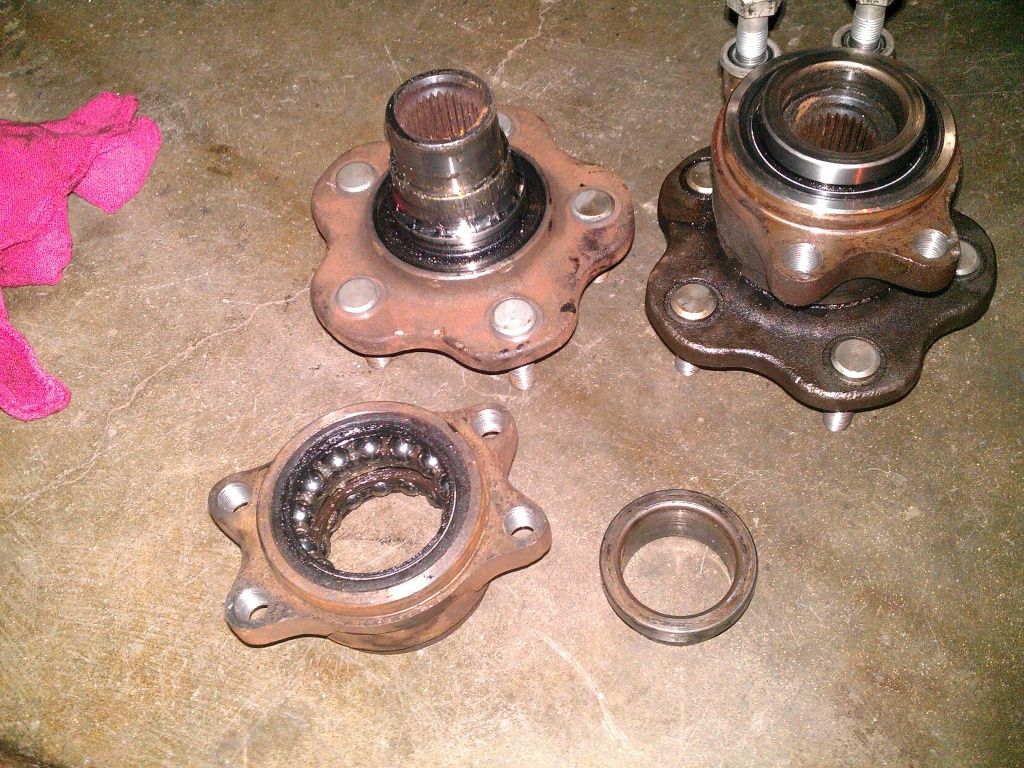

- Change the Rear Wheel Bearings because they came apart

- Ichiba 5-Lug conversion: New Timken Rear Bearings

How do you pull the bearings out of the ichiba hubs? I have no clue.

The rears need to be pressed out just like stock.
More than likely the inside race is gonna get stuck to the Hub so you'll have to carefully cut it off:
