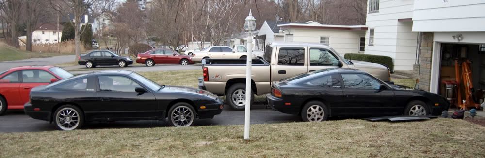

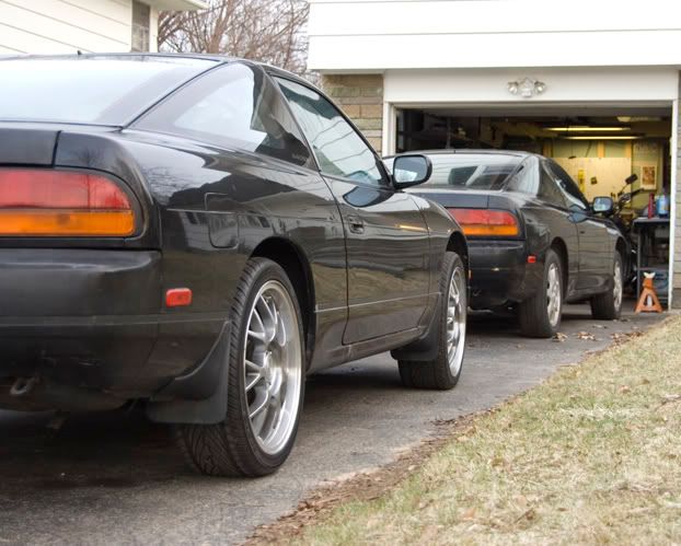

I just picked this guy up on the cheap, $800. FL car recently brought up to NY. Guy I bought if from said it overheated, I havent had a chance to fiddle with it yet but snapped some shots when I got it home. Pretty cool and rare set up for the s13s (few Datsun guys have done it, they love their Webers!)

Any pictures of the rest of the car?
