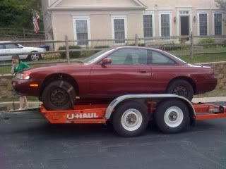

Hello all. I bought my first s14 on Friday. Ive owned 4 s13's and I think it's time for something new. I had contemplated an s12 sr20 build but couldnt find a mark I s12, only mark II's. So I went with an s14 shell I found in reading pa. The redtop that is currently in my s13 will be going into the s14 over the next 1-2 weeks. As I get parts in the mail.
Whatcha think?

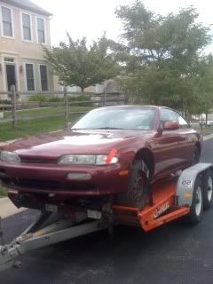

The driver side headlight is pushed back about 3 inches, It broke one of the pieces of threaded rode of the side of the headlight and bent the fender mounting point back. I think I can glue the headlight back together.

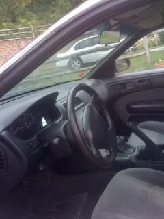

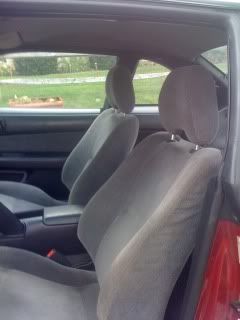

Interior is all there except for the trunk and the ecu kick panel

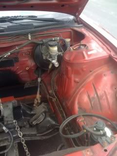

the engine bay is clean, and no rust on the rails. Although floor is rusted through in 2 small places. right behind the driver and passenger seat brackets. Not a big deal to fix, just annoying.
Does anybody know what this is. I think its a little valve for controlling coolant to the heater core. Im just not sure if I need to keep it, or what. If I can take it out, installing the sr will be a little less of a headache.
Also what is this? Its in the corner near the wiper motor.
First picture: Yes that's the heater control valve. Keep it or toss it, doesn't matter.
Second Picture: That's some sort of electrical box :p haha, I still have mine. Not sure If i need it or not, but i can go outside start my car and unplug it, if it doesnt do anything then we know we dont need it.
No it's so you can control if you want the Heater on/Coolant flow or not. tossing it is like taking out your Thermostat, you have no control and it'll take forever to get to temp. Not to mention you'll have heater 24/7.
