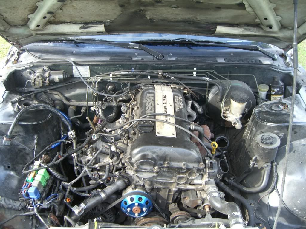

it has altima fans right now looks yucky with the zip ties gunna put flex-a-lights sometime. but its a s14 top notch sr20det on a solid 6lbs of boost and pulls harder than a mother!

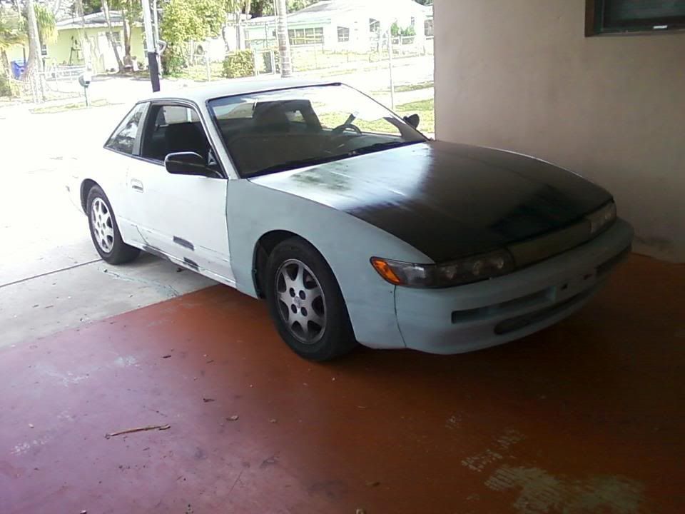

Ok so I feel its time to bring this thread back from the dead for a big update. Last time I posted in this thread my car was looking something like this

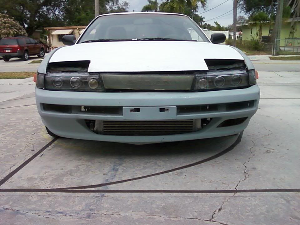

I had finaly gotten most thing strait and sanded down. then found me a pretty decent front end.

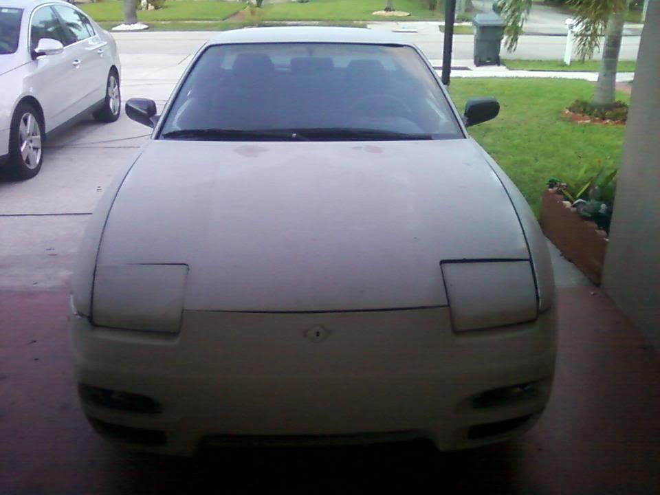

It came with some clear D-max corners that were broke and just completely ugly as all hell so I ordered some OEM corners from good ole japan.
I got tired of looking at the holes for the chuchi hood so I had an extra one laying around so I tack welded some metal stips across the holes and fiberglassed them up for the time being till I could find a hood.

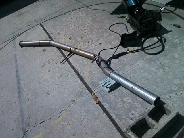

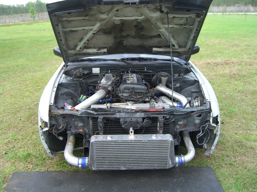

Went to the local muffler shop and told them to give me all the scrap and spare 3" exhaust pipe they have and Built me a exhaust. had it as a strait pipe but just recently welded back on my apexi can.

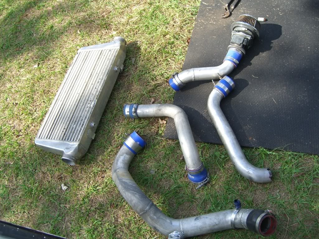

IC piping off

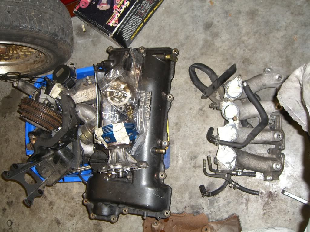

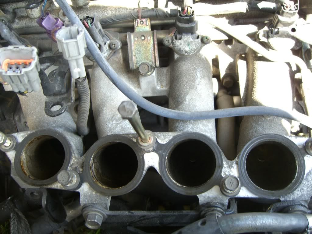

Intake mani off.

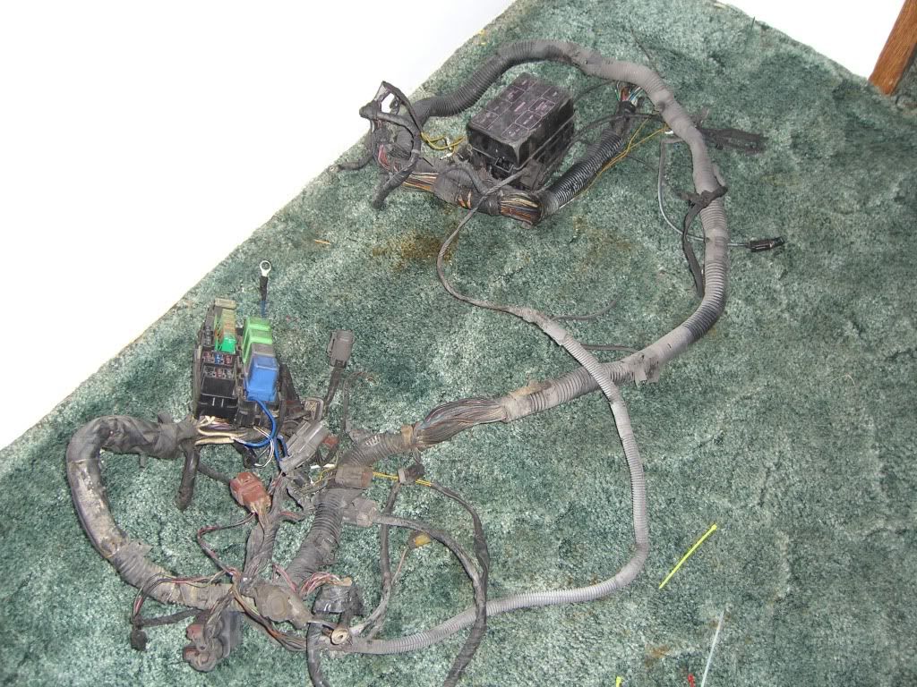

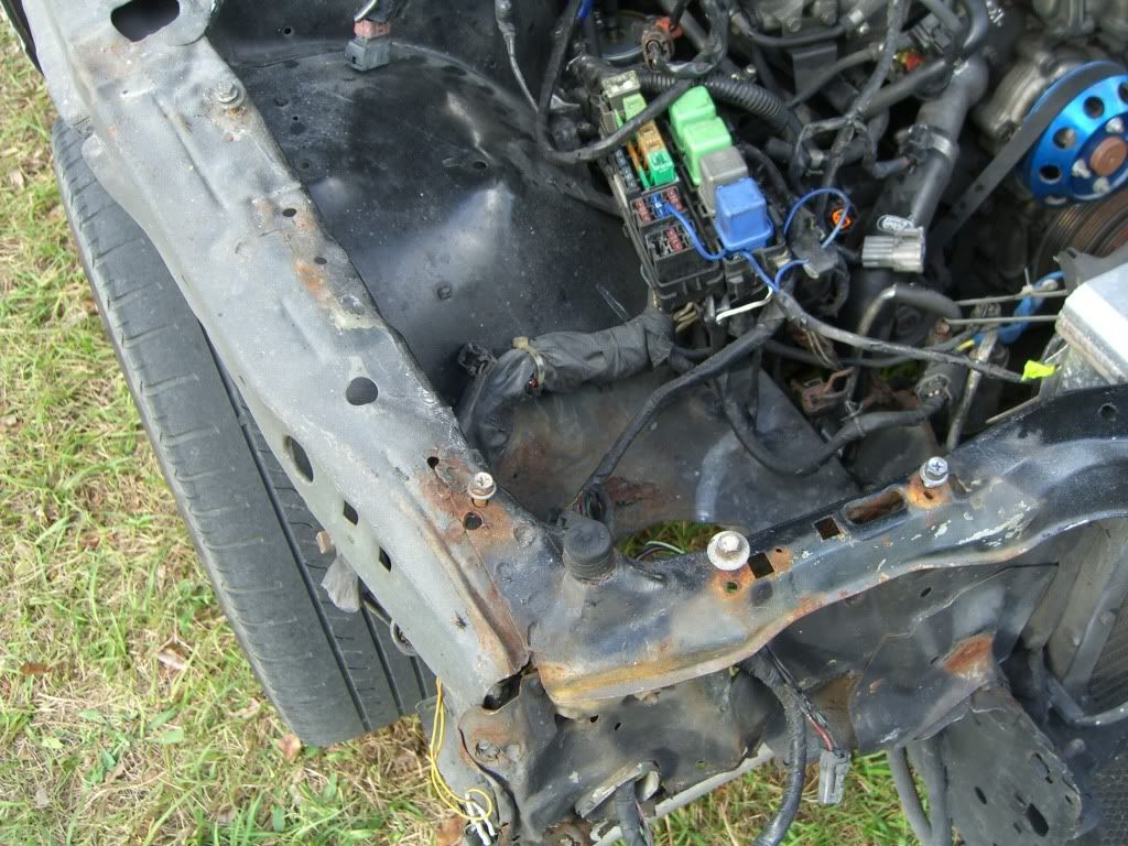

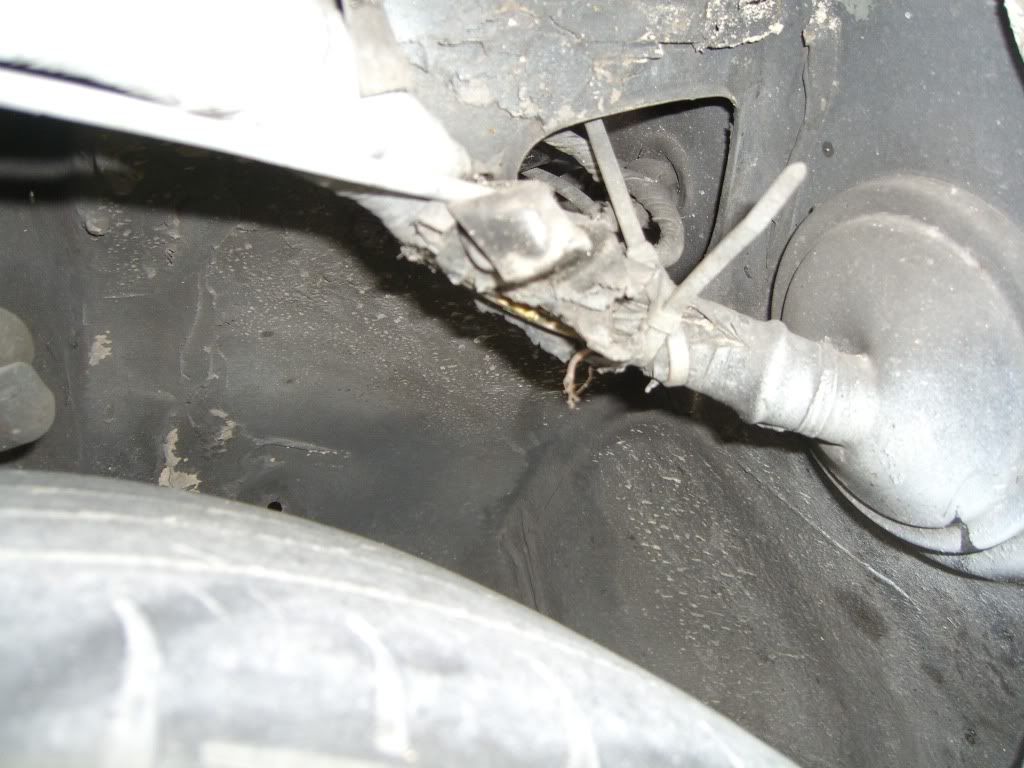

Still SMH at that harness. its mangled and not my fault. I removed the radiator, headlight mounting brackets, hood latch, engine harness, and the chassis harness. I ended up having to cut the harness in the wheel well to get through the fire wall because the smarty befor me decided it was a great idea to tangle the harness in the bay with the dash harness with left me no choice but to cut. plus it was owned by tire at an event and zipties failed.
so I said fuck it, and cut it.
laid everything out and started to deloom this mess.

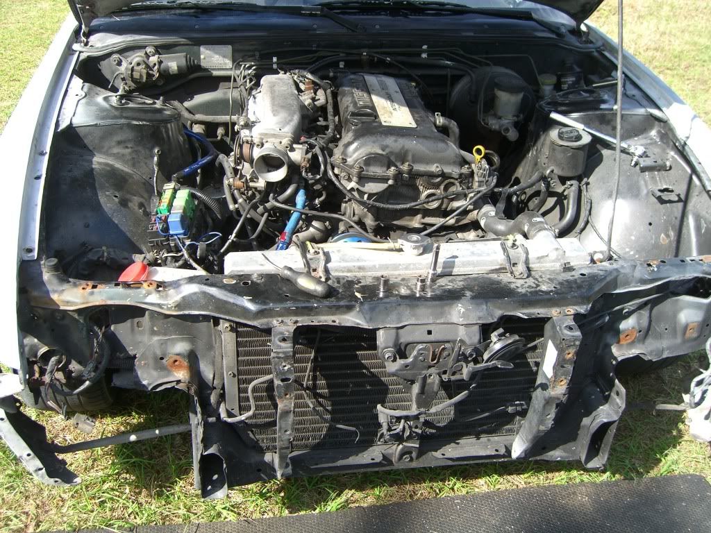

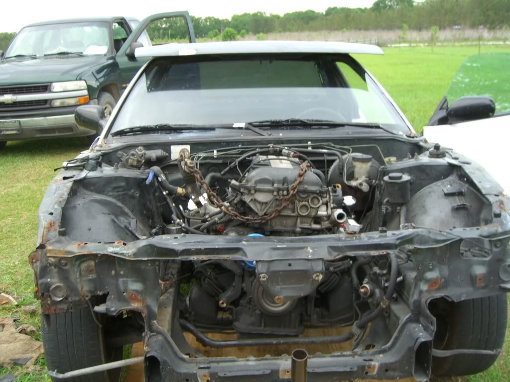

Decided that there is to much rust on the core support and this is going to be a trac car I am cutting out the core support and tubbing the fenders when I pull the SR.

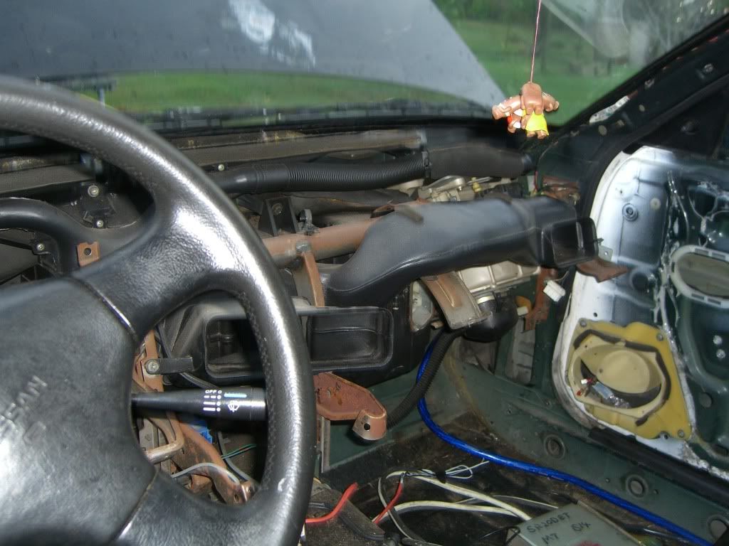

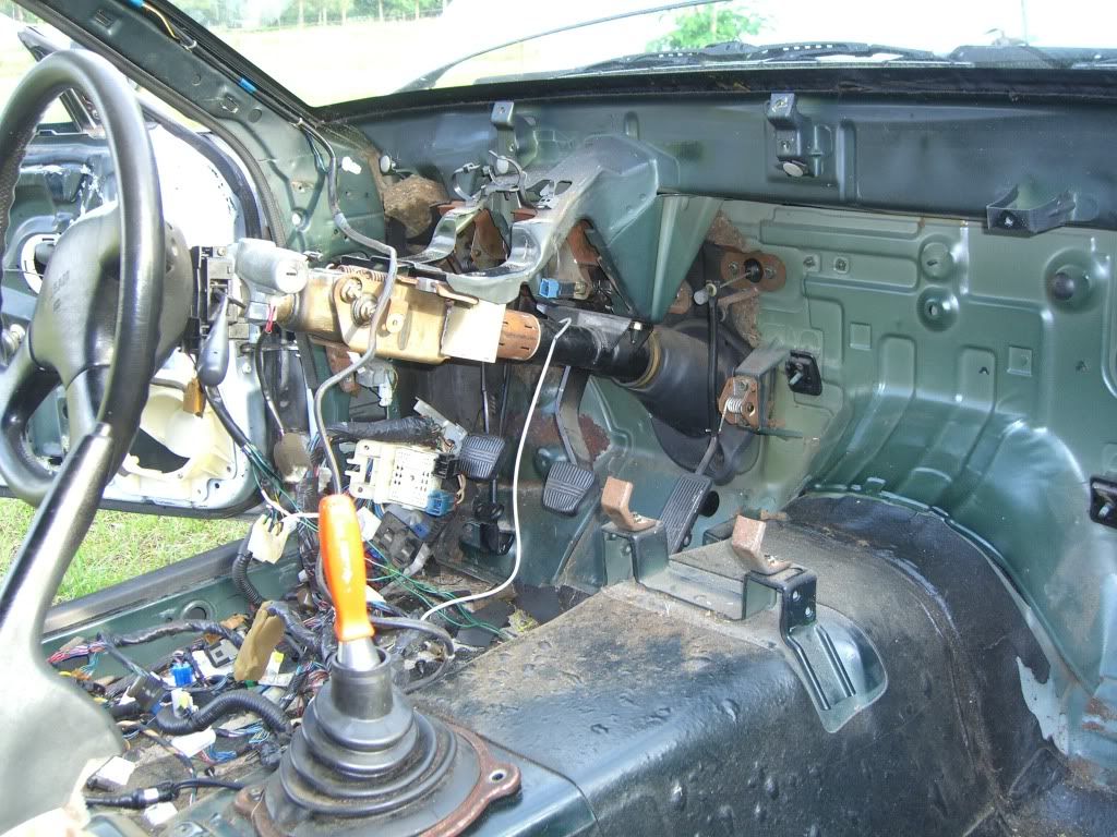

started pulling out dash and dash harness.
removed the dash and harness

And this is where she is sitting as of now
Ready to be pulled and disassembled. Should be getting my taxes here soon ARP studs, gasket kit, cosworth head gasket, rod and main bearings, if the walls are too bad in the #1 (where the knock is) cylder its getting bored out. but im going to assume its not to bad. block is getting tanked and decked. all oem parts going in for a OEM spec rebuild. then the rest of my money is going to a cage. also WTT my s14 front and rear seats for a driverside bucket and rail. Any input is much appreciated. =]

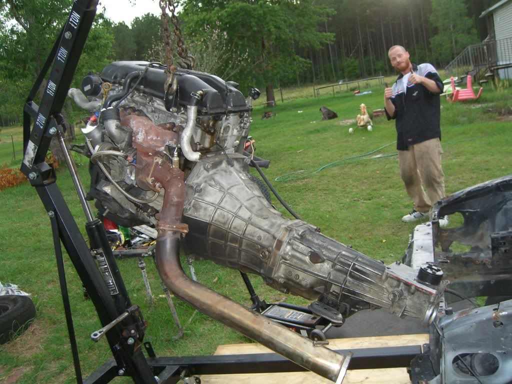

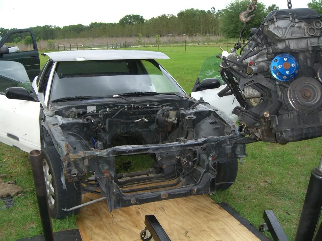

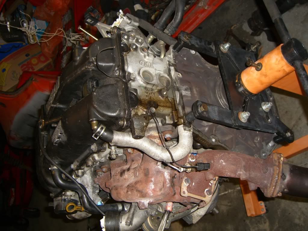

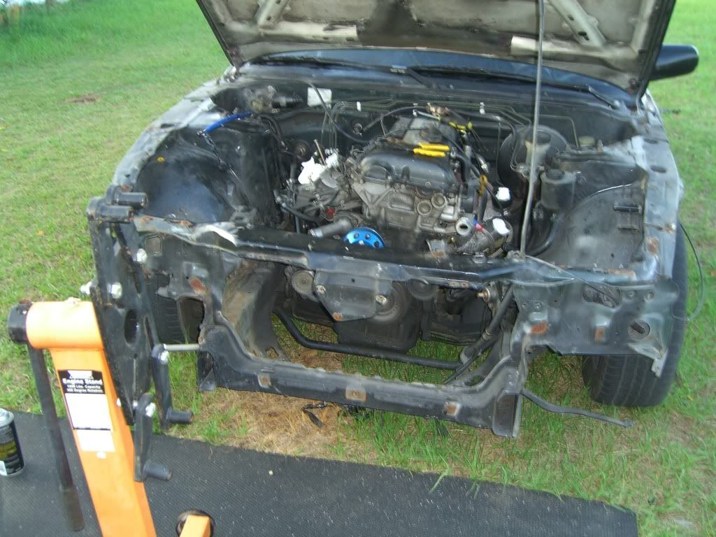

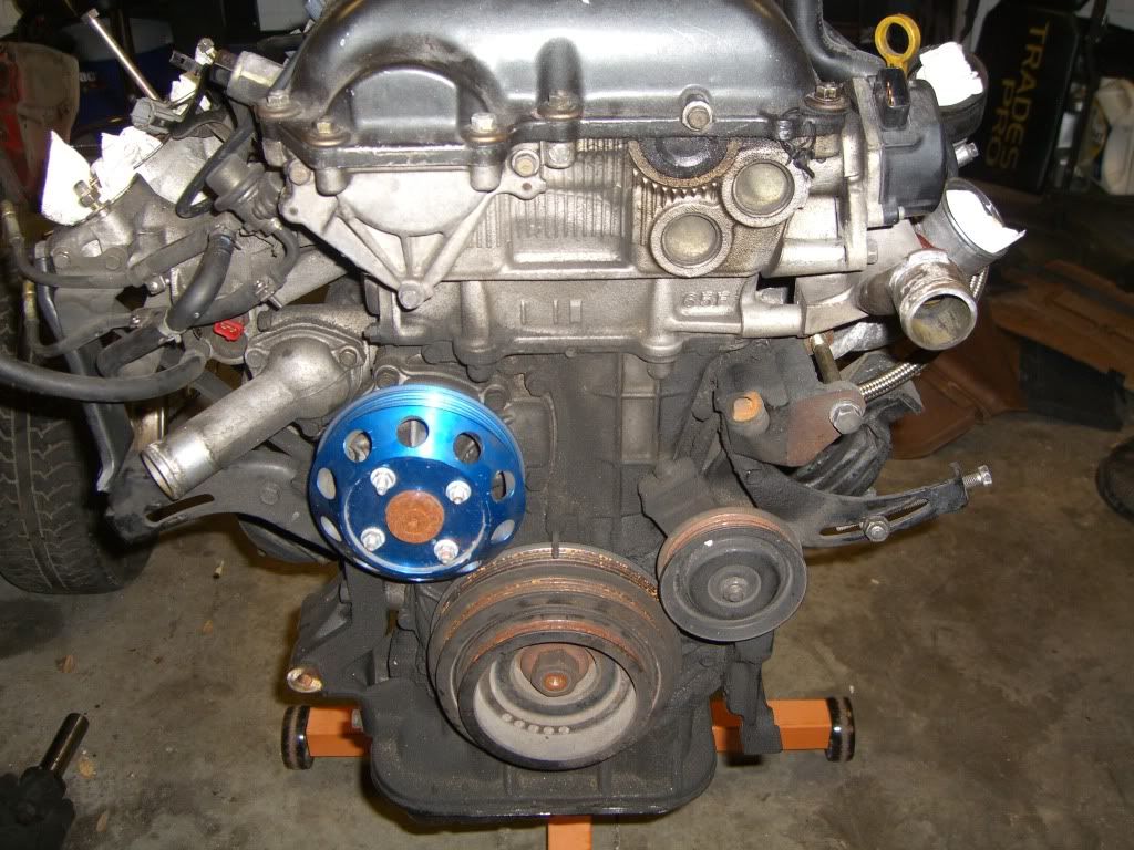

Well This is going to be a HUGE update. Well sense my last post quite a few things have gone down and the coupe is no longer the project at hand anymore! But for the sake of documentation I will continue where I left off. Pulling the SR

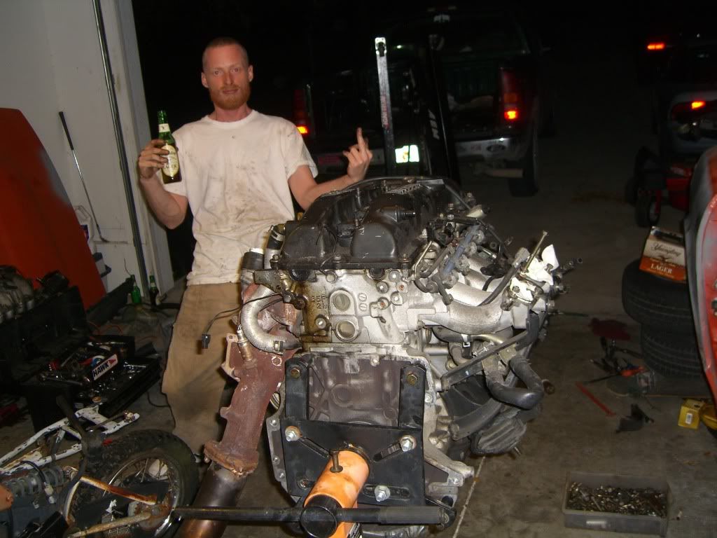

HAHA my buddy and mentor Marshal SR is out (insert fist pump ) :thumbsup

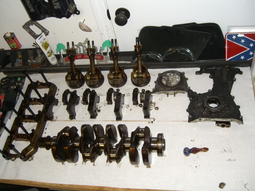

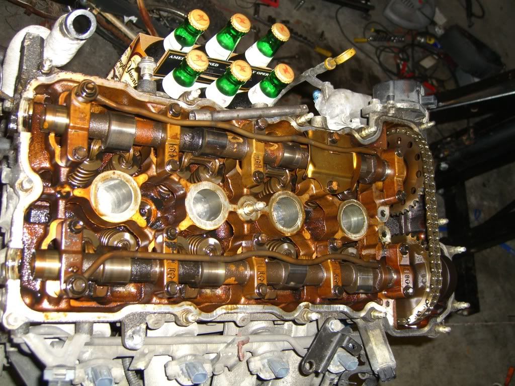

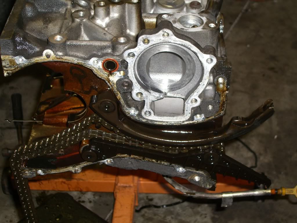

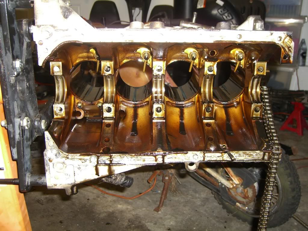

And so the break down begins. I want to add we pulled motor at 6 PM and had long block completely disassembled by 5 AM went through 2 boxes of hungry Howie's, with spicy crust, and about 4, 6 packs. got some shit DONE!

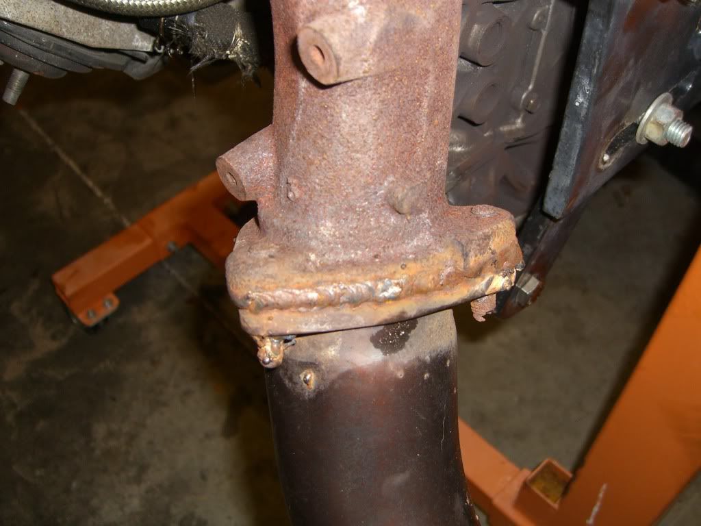

I welded my down pipe to my J pipe a wile back due to the studs one was stripped, one was broken and the other was fine couldn't replace with engine in so I got aggravated with the exhaust leak and welded that bitch solid.

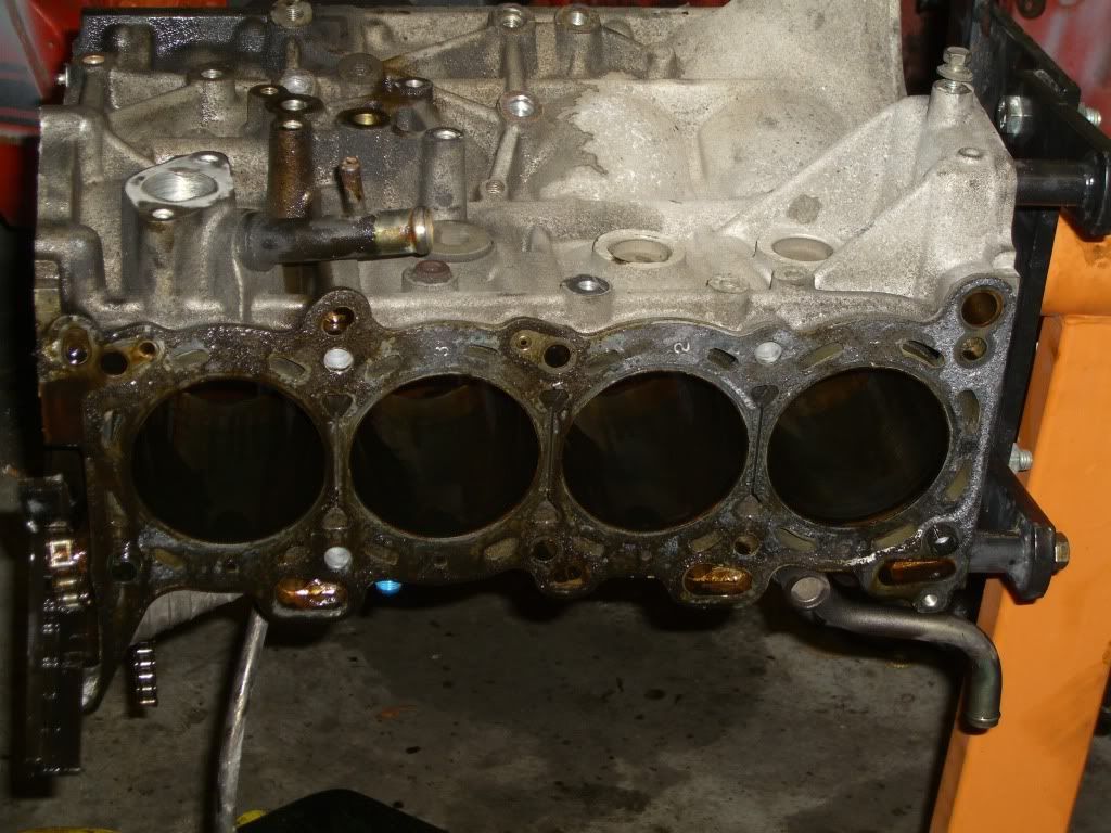

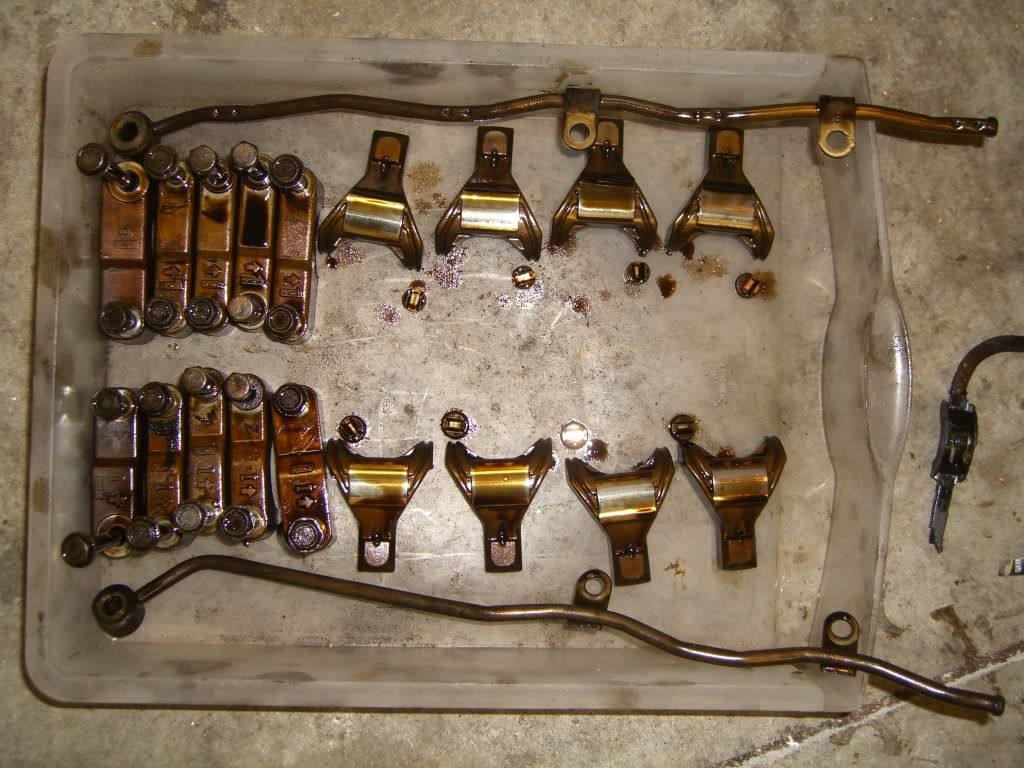

Head was relatively clean ^ not bad.
Parts bin ^

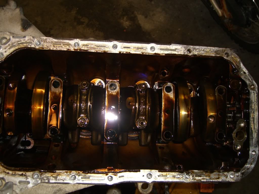

Lower pan and crank was yucky ass molasses color which is no bueno.
OEM cross hatching is still there so +1 for under 60k SR
Organization is key, if there's anything I have learned from Marshal its organization. I now have CAR OCD because of that guy.

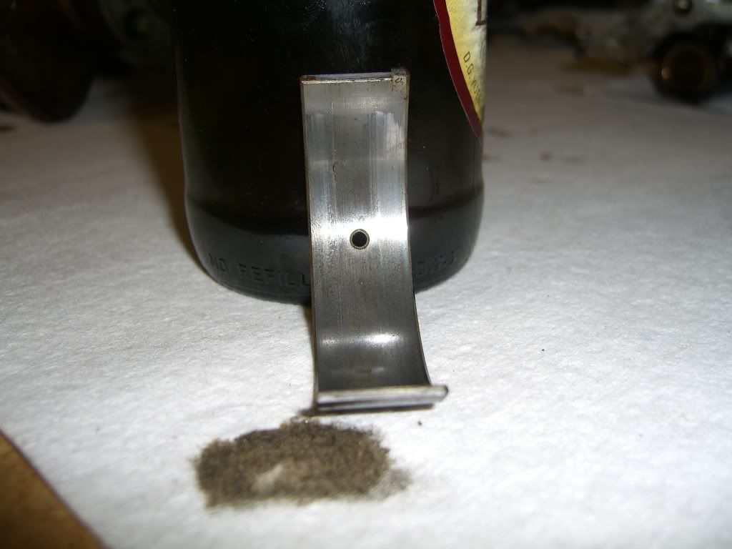

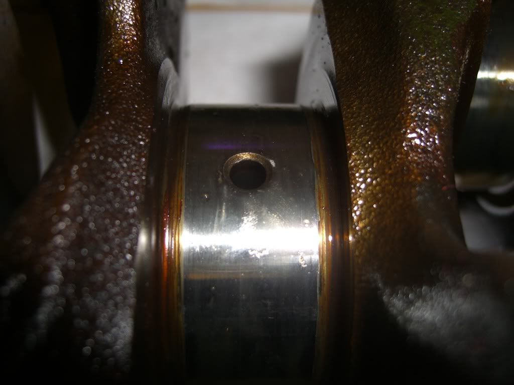

#1 cylinder crank looks fine I caught the problem before damage occurred so that's a good sign.

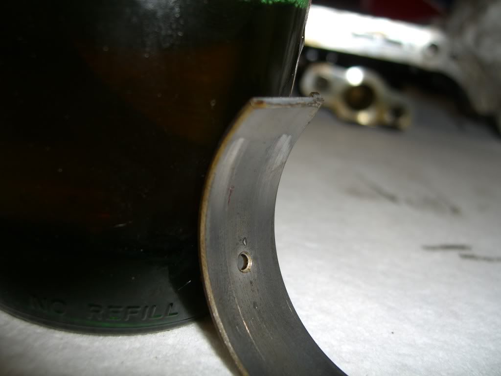

The culprits dam bearings.
And as for now motor is still sitting waiting to send Head, block, crank, to get decked, tanked and specked out. And I still need to order parts to rebuild. I had all the cash needed for the cost of rebuild but then found damage to the frame rail of the coupe and stumbled upon a REALLY REALLY REALLY good buy and couldn't pass it up so engine is at stand still.

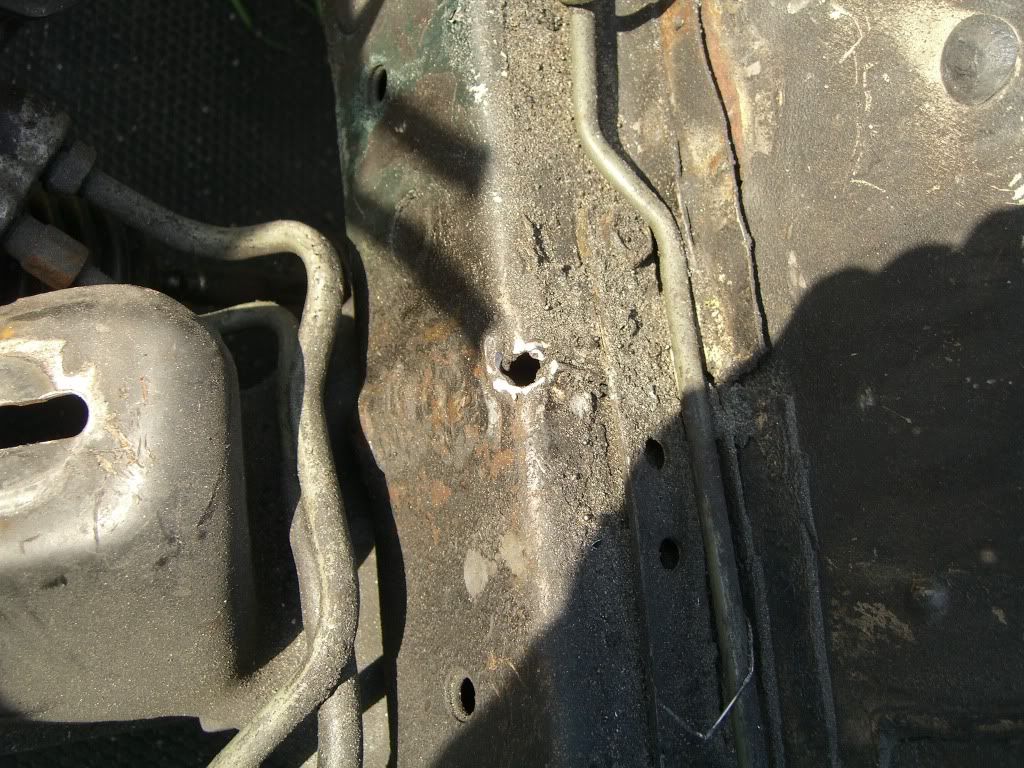

Frame damage that I could not have known about, nor was I told about when I both the car. but oh well

its hard for me to see the damage in the pic... and +1 for catching the rod knock before it did any damage!
