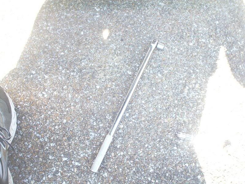

Socket wrench

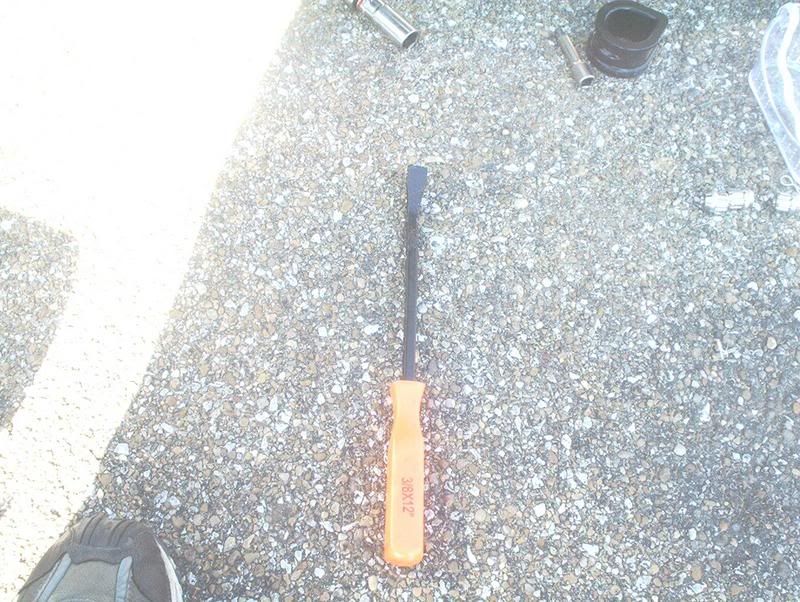

17mm deep well socket and an extension
pry bar

Pry bar
Breaker bar
