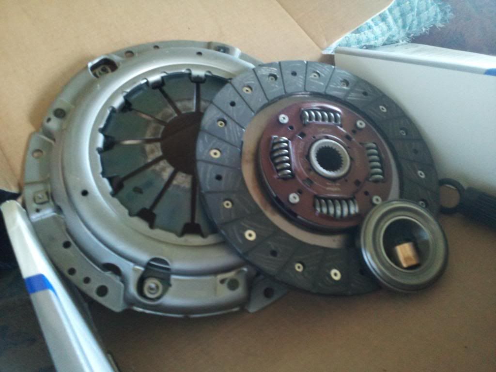

Also got my Exedy in today.

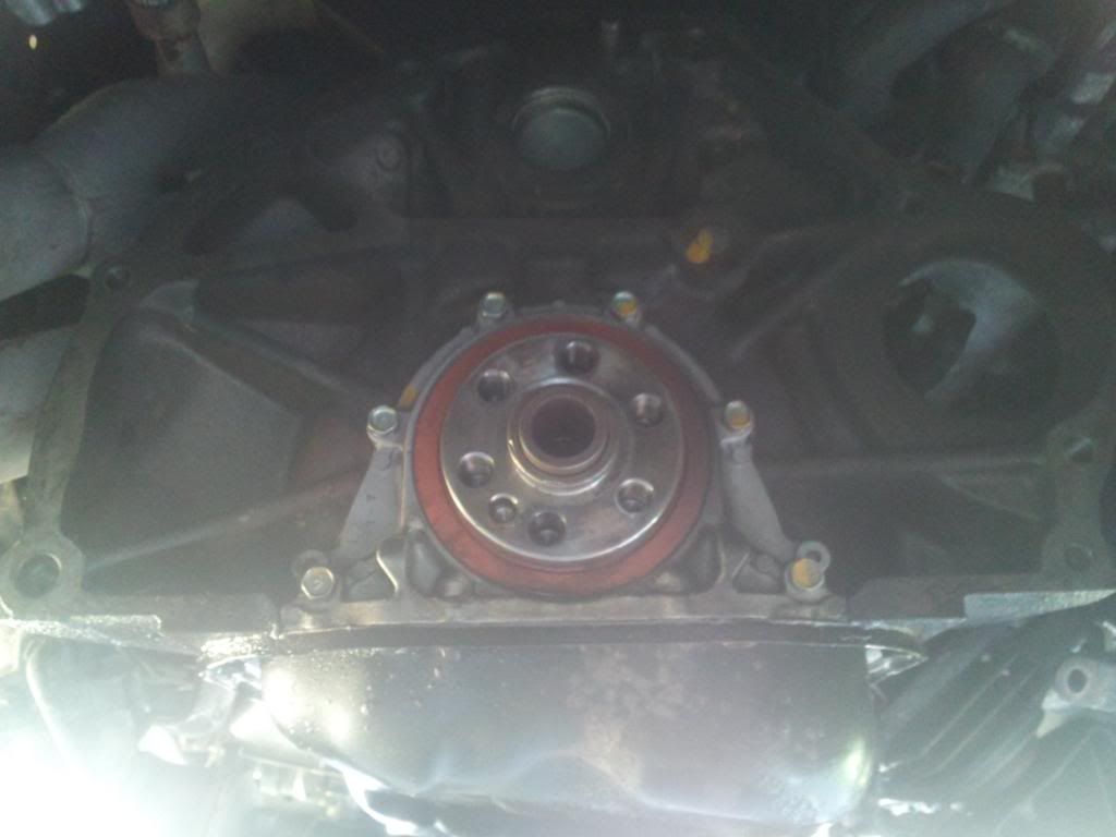

Also, for anyone who's recently removed the transmission from the KA. Is this bushing the automatic one that should be removed, or do I insert the manual bushing into it? Anyone who has done a 5 speed swap should know.
If the Manual Pilot Bushing fits in there then there is no Auto Pilot in there either.
If it doesn't fit then you have to pull the auto one out.
I used grease, it's messy but works without having to worry about damaging anything.

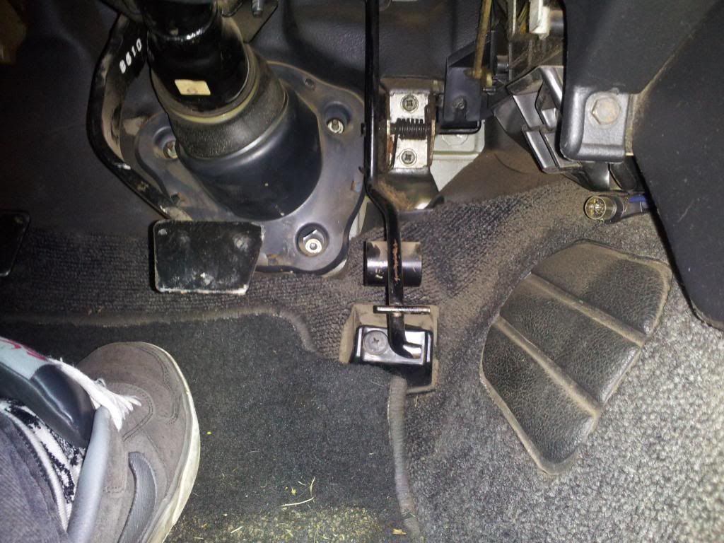

1: Here is my gas pedal. What is it missing? Is it just the pad or is there some type of spring contraption that makes it act the way it should?

it DOES NOT look like all the pilots ive seen for a ka fyi. something is wrong from the way it looks in your picture. the diagram shows it has a inset. so you still have the auto one. or at least the wrong pilot.

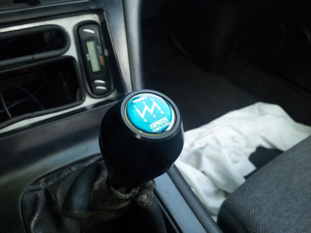

-Trust GREX shift knob (my brother bought this for me)
