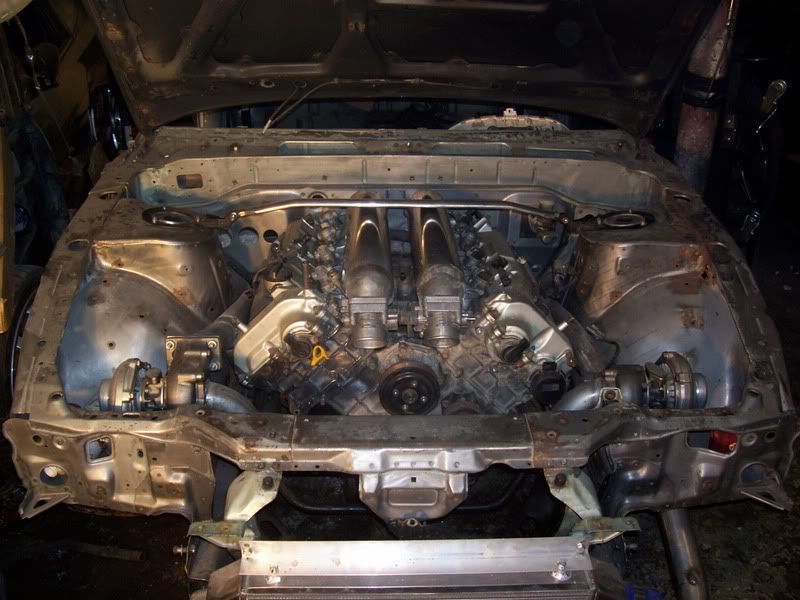

I have to say i am not a fan of cross breading, this is 1 reason I went with a VH45de for my s13. Another reason is that the VH is an amazing engine! Some of you may have seen the vh45dett jet boat video and thought wow! The real WOW part is that the engine in that boat is pushing 1000hp on stock internals and stock head gaskets.
I thought of doing an N/A VH but then I found a few cars that had already done that so I decided to do a tt set up. This will be my drift car and I will be competeing in IDCR with it in the summer.
The Vh is mounted to a z32tt tranny via a custom adapter plate which I got off a guy an the UK, everything else I built myself. Everything is in the build stage, I will do all the fit and finish (polishing ..ect...) when the chassis goes to the body shop and the engine is out.
