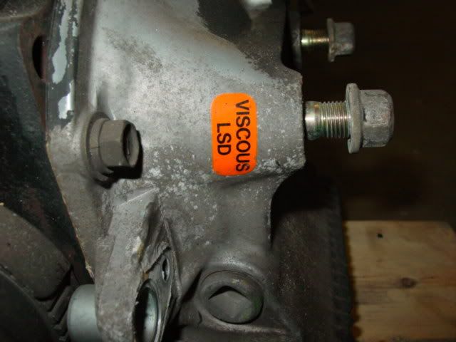

no, not all se's have lsd's but every oe lsd equipped s14 is an SE. VLSD was a common package with ABS but it was possible to order a s14 se w/o abs and w/ a vlsd so check your differential casing, there should be a red mark on it to indicate its a vlsd. btw fordtech se models were not that much heavier than base models, maybe 60lbs at most if they had a sunroof equipped.
