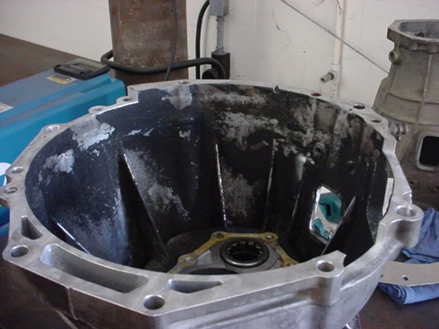

I'm sure many of you have been through the same crap that I have, of breaking your SR/KA tranny when you have more than 400hp. Well I have searched a lot for good uprgrade options without really any good options. I recently was introduced to a great fabricator who in collaboration has decided to make an adaptor plate for the Z32 trans out of the 300zx. This trans is good for about 700hp. The full kit is a couple of weeks away, but the adaptor plate is done and has been bolted to the SR with success...

plate bolted to block
closeup of plate

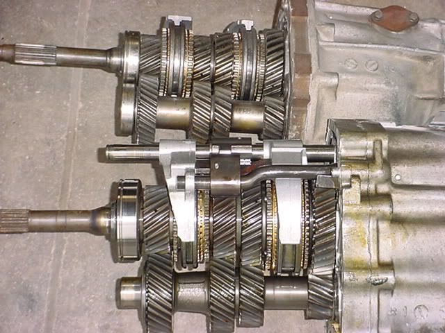

Z32 trans on bottom compared to an SR trans above with the OS giken Crossmission....compare the width and thickness of gears.

Ok..the shifter will sit within 1 inch back of where the stock shifter is. Overall this won't make any difference. But we won't know FOR sure until he gets a shifter bolted up. The trans he got did not come with the shifter assembly but he's got another shifter on the way.
In terms of the bolts, he told me that only top of the trans would be bolted to the block. The bottom bolts are not necessary. He used to be the driver for Titan Motorsports in 2003 and they have 1300hp supras with only 4 bolts holding the trans to the motor..so for our purposes this should be fine. The bellhousing is machined such that when the adaptor plate is in place the bottom of the trans will be flush with the motor.

surprisingly the gearing of the Z32 is very close to the SR.
Z32... Gear ratios are: 1st 3.21, 2nd 1.93, 3rd 1.30, 4th 1.00, 5th 0.75 for the manual.
SR...1st 3.321, 2nd 1.902, 3rd 1.308, 4th 1.00, 5th 0.759

machined bellhousing
adapter plate

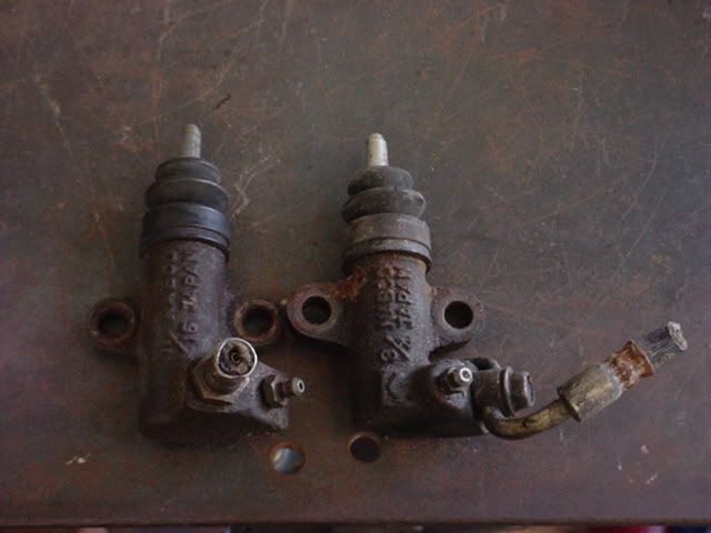

clutch slave cylinder
240 on left, Z32 on right

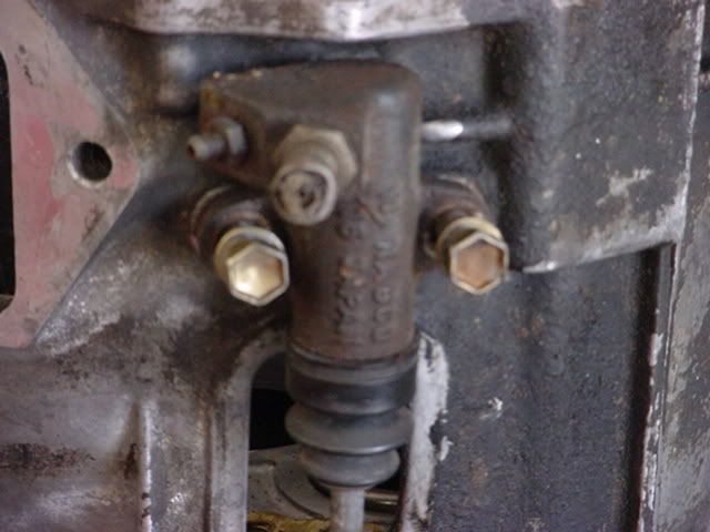

clutch slave mounted to bellhousing
we also have to make a custom shifter assembly but not a big deal. We will be ready for test fitment in a car later this week.
