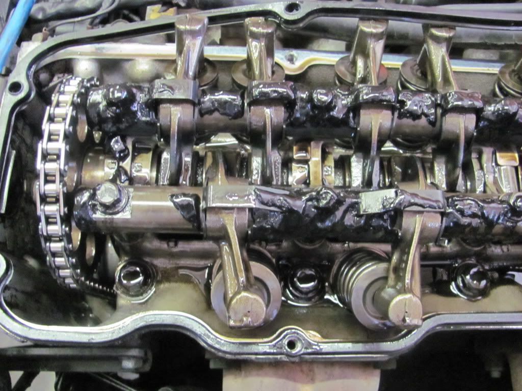

A picture with the valve cover off... look at the think oil / tar buildup

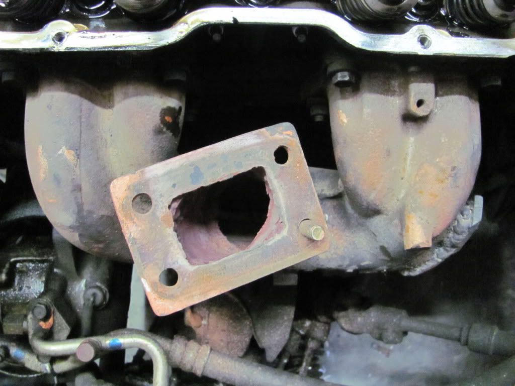

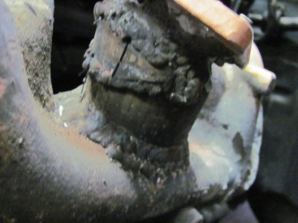

Here is my ghetto as hell exhaust manifold that is currently on the car:
^Needless to say this is being replaced

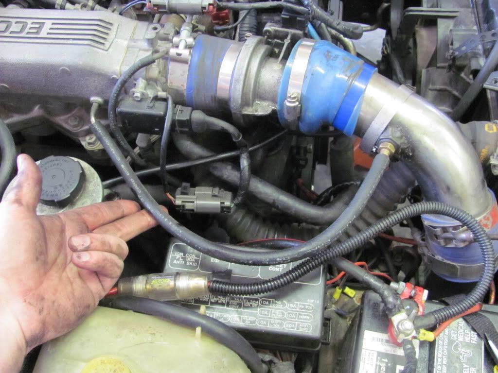

^This is how the injectors are setup, assuming that is a resistor inline...

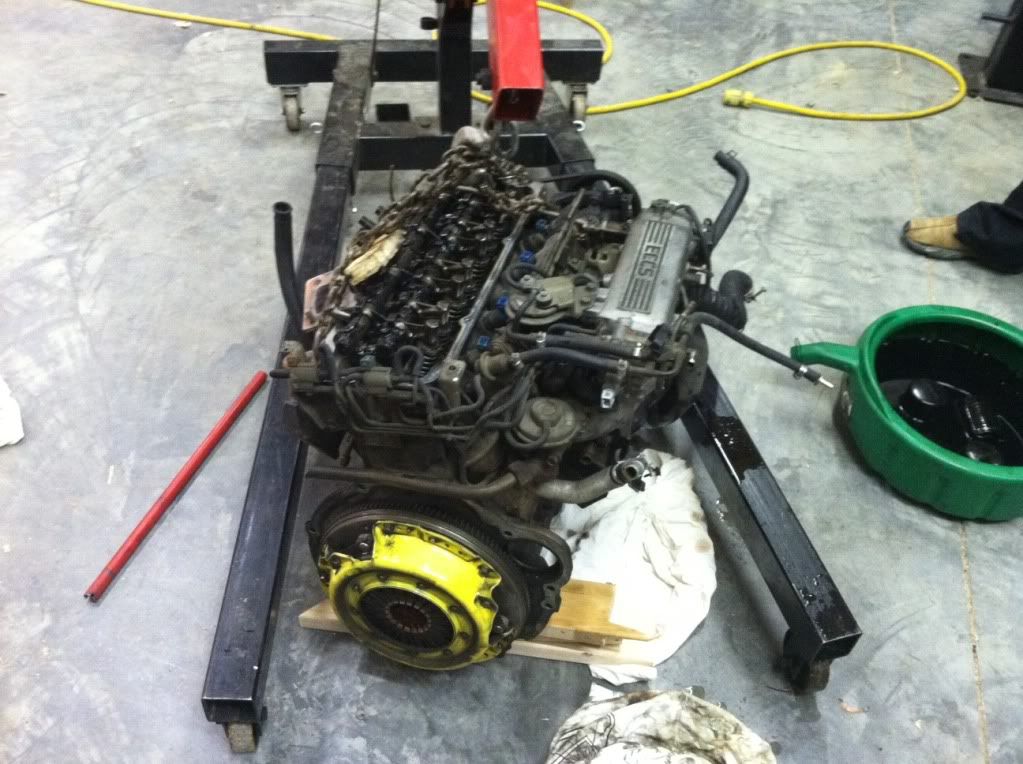

As of about 10pm last night:
And the tear down begins today after work!

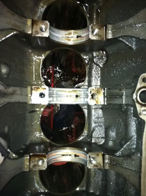

Alright, got the motor mostly stripped down yesterday. Here are some pictures, please let me know if anything looks out of the ordinary...
Here is how the turbo is getting it's oil... looks like its leaking quite a bit
Does this look bad? Looks like their is oil everywhere in the intake...
The valves dont appear to be the right color... too much heat? Or am I missing something?

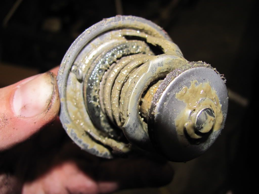

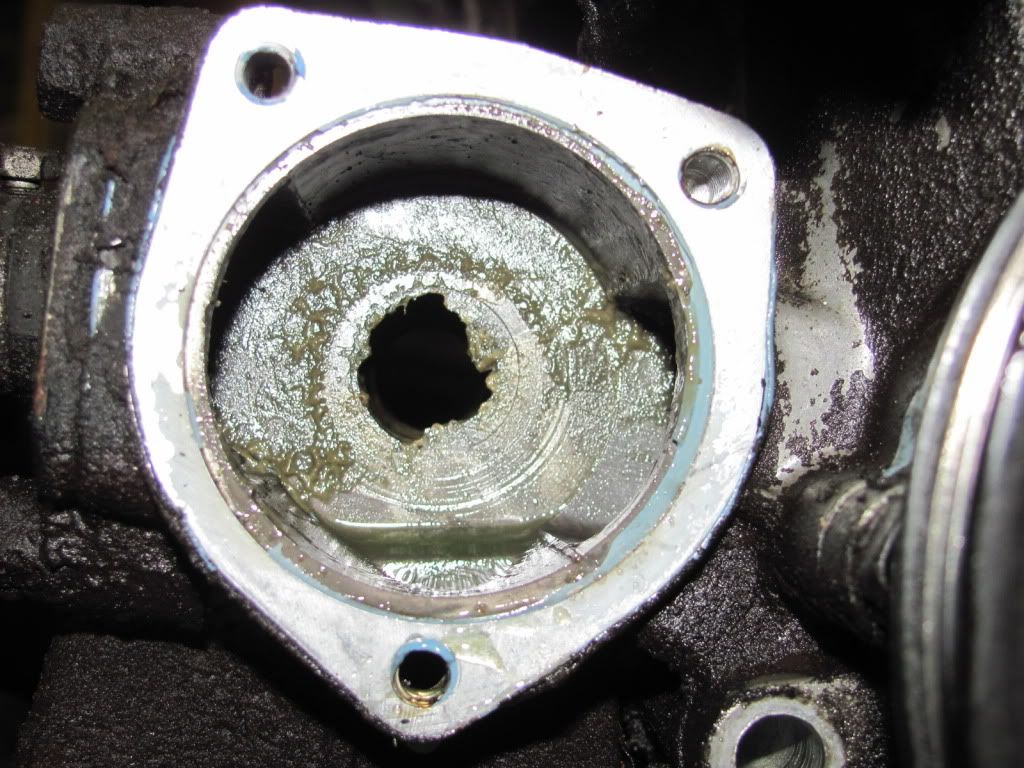

This is the nasty thermostat:

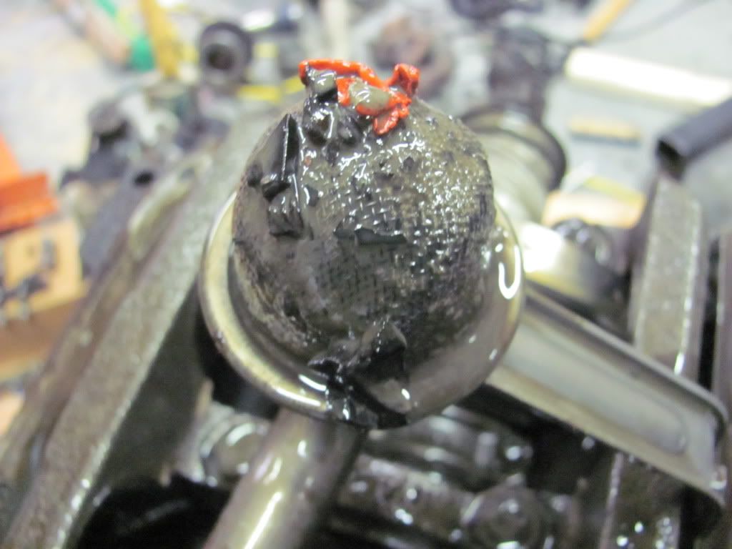

And YES this is how I found the oil pickup filter, I didnt put that on there... I have no idea how oil was being moved when it was this clogged with sludge / debris

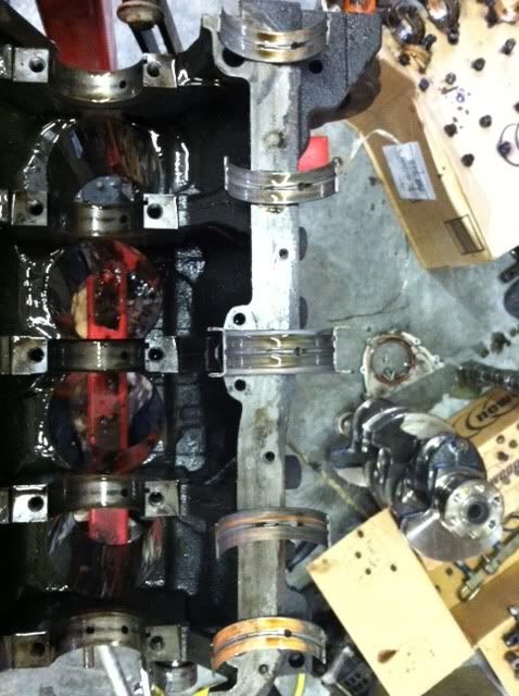

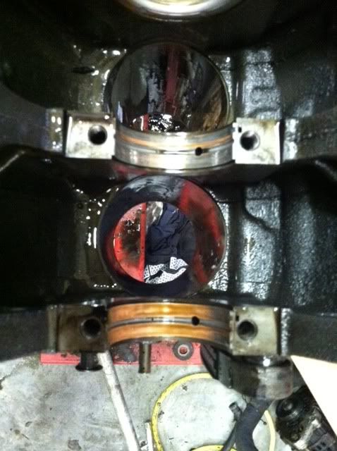

Bottom of the motor:
